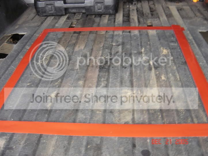

I taped it off, you can see where thwe body mounts are:

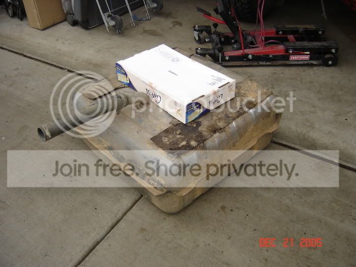

Now this big 31 gallon thing needs to fit in there:

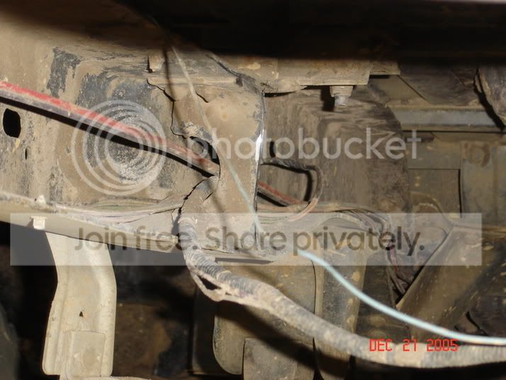

Here you can see the cut crossmember, dont worry, I will be making a new one:

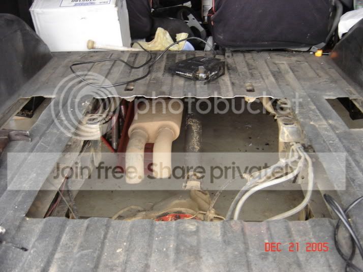

Here is the hole, notice the body mounts in the way, they got cut off and will be relocated:
Here is the tank sitting in the hole, it fits almost. still needs a little clearancing:

Looks good. Did you figure out whether or not your rear seat is going to fit? It looks like it will be a tight fit.
I'm doing nearly thesame thing, cept I'll mount the tank farther rearward to accomidate the rear seat, plus I'll miss the crossmember!:D
the stock bench seat will be really tight but it will fit. but im going to put in the buckets from the front back there. they fit perfect. I do plan on driving it some on the street after the bob and narrow. I just need to get some big arse mud flaps and hope the cops dont care too much.
