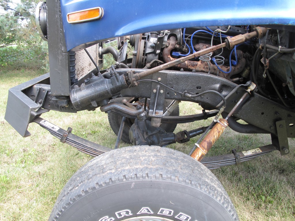

The 56" springs did relocate the axle 2" forwards when I relocated the stock spring hangers 4" more forwards, like this:
If you use B52's I'm guessing you could move them even further forwards if you like...:dunno:
You will need angle shims to compensate for the pinion angle with 56" springs.
Both because the axle isn't centered on the springs, and because you'll need pretty long shackles to clear the frame.
But be careful not to shim it to much so you'll get negative caster
I think you could run into clearance issues between the drag-link and tie-rod with high-steer if you move the axle 2" forwards.
But it probably depends on what pitman arm and steering arms you're using.
The Superlift 1104 pitman arm is probably a bad choice, because that's a really long one.
56" long 4" Superlift springs. Stock location for the rear hanger.
Things look a little out of proportion because the engine is also moved back 2.5".
Click on image for a ginormous picture.
