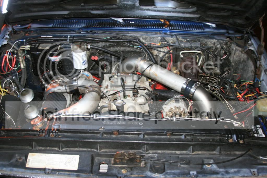

If you have the turbo you want to run and the welding skill you can make your own. But if you're only going to run a stock GM turbo just run the banks one if you can find it. Would save yourself a lot of time. Also remember that if you're going for big (for a 6.2 at least) power, over 250hp, I HIGHLY recommend an intercooler. The 6.2 has a stock compression of 21:1 so anything over 12lbs boost and no intercooler WILL melt the pistons. With an intercooler you can push it to ~17lbs boost. That's at stock compression, if you build the engine with low comp pistons, around 19:1 and use head studs you can push the boost into the upper 20's.

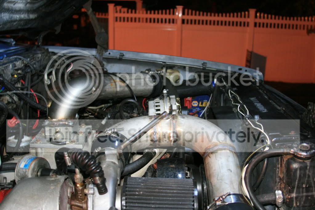

These numbers are sustained not peak. My truck for comparison runs around 23lbs of boost but I'm at 18:1, head studs and a duramax intercooler. So the egts easily stay in check. I'm also running as stock 6.5 setup so I removed my stock A/C( stupid me :doah:) and installed a vintage air unit that puts everything under the dash. That's a GM8 turbo, the largest GM every put on the 6.5 from the factory. The filter is 8" long and the ic piping is 3.5od, just to give you an idea on space available. And yes the intercooler does fit but with some pretty serious mods, but very well worth it.
Hope that answers you question, probably gave you a bunch more though :haha:.
That is seriously cool, is that a Cummins grid heater I spy there and is it functional??If so did you get rid of the glow plugs? What kinda power you putting out? Thanks for the pictures.

Sixb- Thanks. You spy correctly, that is a cummins grid heater and it does function. I'm using a momentary switch to engage the glow plug relay that's right next to the oil filters. Still have the stock glow plugs and mainly use them. The grid heater helps but I've found that it's best to use the glowplugs before start up then use the grid heater. Least that's what my engine seems to like. Power I'm guessing is around 230 at the rear wheels, at or over 300 at the flywheel. One day I'll dyno it to know for certain.

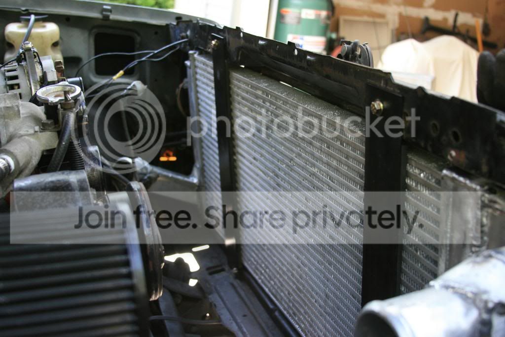

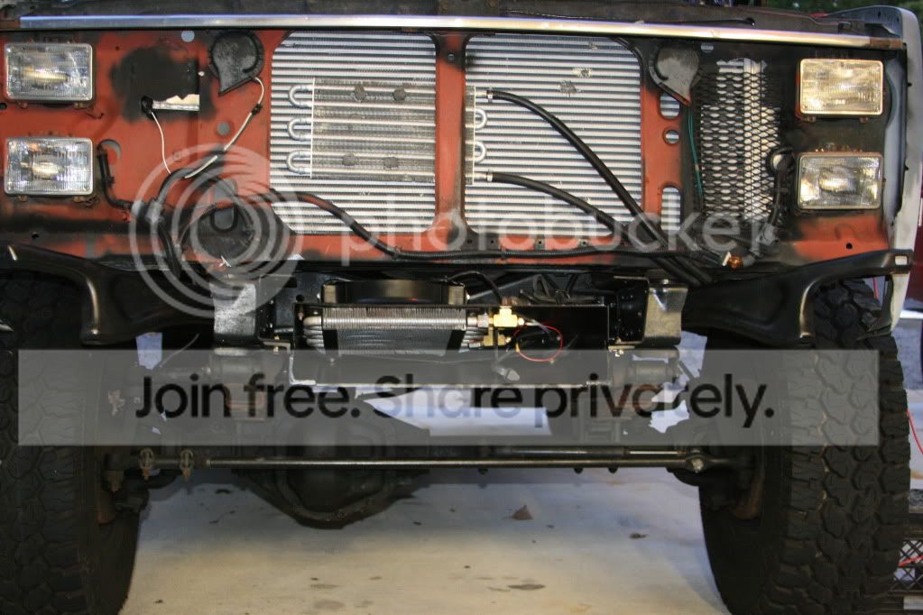

Plenty of space huh, heres's where I had to move my oil cooler to due to lack of space. You can see I also opened up the support fro more air flow through the intercooler and radiator. I had to do a fair amount of cutting behind the lower drivers headlight too.

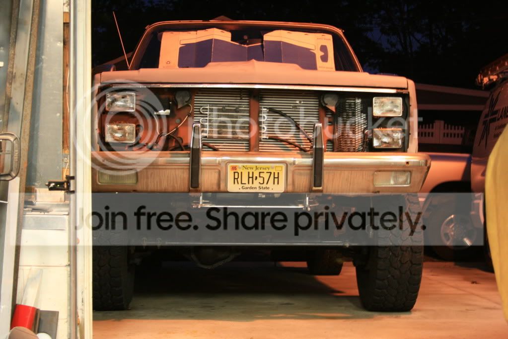

here's with the bumper on. It hangs down 2" from the edge of the bumper and actually ends up even with the bottom of the frame rail and goes all the way back to the first crossmember. Its made from 1/4" 6061 aluminum, very strong and wont ever rust :woot:.
Now the reason I had to move the cooler was it's an 1.5" thick, so it wouldn't fit behind the factory grill. Plus I needed and had to run the a/c condenser where the oil cooler was. I need to get some pictures of that to show how it'll mount. Still have to run the a/c lines, so I'm running out of room fast :whistle: :haha:
