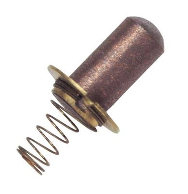

    Greg......It sounds like you need a Low-Resistance HEI Bushing. Summit's part number is MSD-8412.
    Summit's verbage:
    "The carbon rotor button in a stock HEI distributor cap has very high resistance. When the high voltage of an MSD 6, 7, or 8 Series ignition is added, this resistance builds up heat and can actually melt the distributor cap. To solve this problem, install one of these MSD low-resistance HEI bushings, which will pass the secondary voltage from the distributor cap to the rotor without the excessive heat buildup."
    [​IMG]
    I've been using one of these in my HEI for 6 years and have never burned up a cap. This is almost a requirement when running an MSD and HEI.:waytogo:
