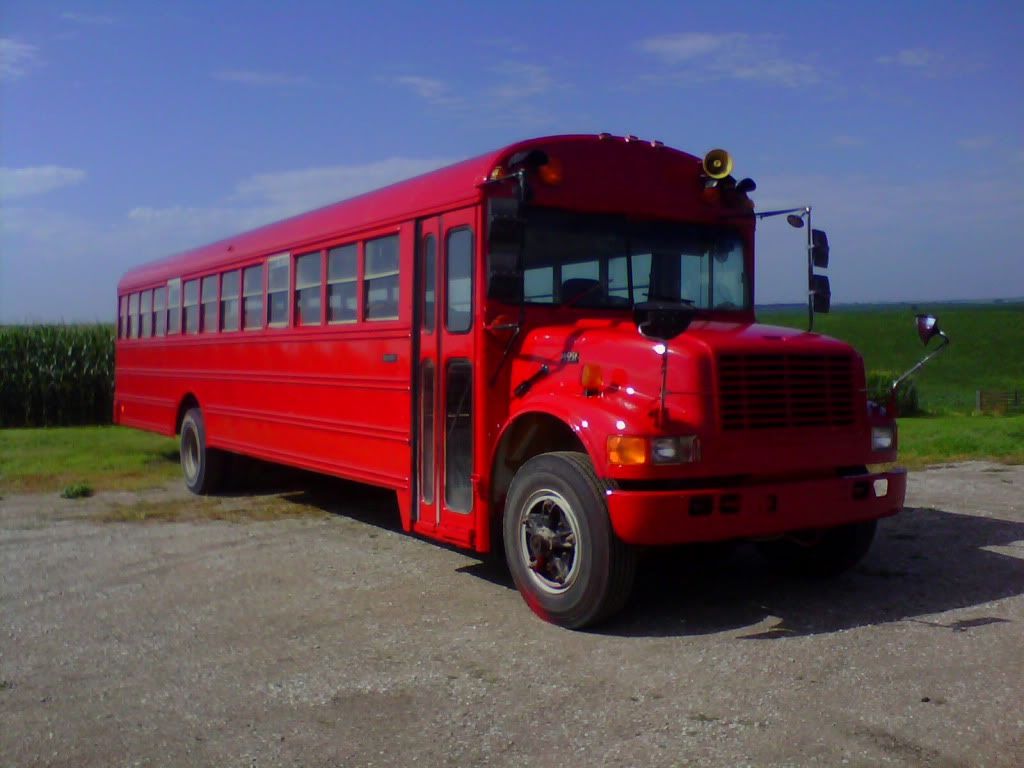

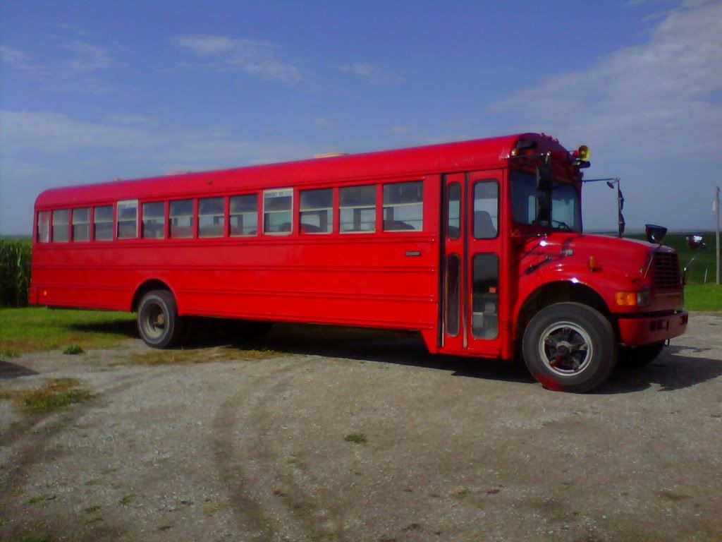

Here is the 1995 Carpenter 71 passenger school bus my brother and I just bought. We converted it to a "mobile home". It has an International D444E (7.3 Powerstroke) and an Allison.
