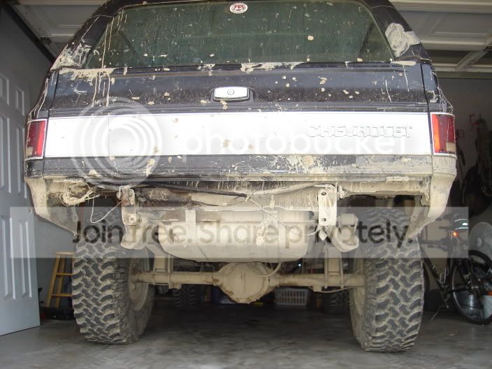

eh jk bout that. from what ive searched i should bow down to the all might 14 bolt . but i do have a question though. can anyone identify this axle. its a 12 bolt but is there anything special bout it? its from a 1980. but both rear tires spin in the mud. does that mean its a "gov lok"??? are those bad?? what are those! ive searched the forums havnt really found what im lookin for. my thanks to anyone who replies to my noobie question.
nothin real special about the 12 bolt. its another halfton axle that demands replacing! lol. yeah both of em spinning probably means its a govlock. some 12 bolts also had an eaton clutch type limited slip, but i dont think they came in models as "recent" as 1980. if its a govlock, they are known to be more or less a timebomb. as cheap as 14 bolts are(relative to other mods in this hobby:eek1:) it generally isn't smart to dump much money into a halfton rear axle.
:thinking: Honestly, I've never heard of or seen a gov-lock 12-bolt. Not saying that they don't exist, just that they can't be very common. It's probably some sort of limited slip/posi unit or (if you're very lucky), somebody dropped a locker in it sometime in the past 26 years.
My K5 is an 80 also and it has the original sticker in the glovebox and it has the tow package and the "locking differential" is part of the tow package. I have put nearly 275,000 miles on my truck and have been through two engines, two transmissions, two transfer cases, replaced both driveshafts, broken hubs, broken front axles, Broken shocks, broken shock mounts, broken at least one leaf on all four spring packs, dented every body panel imaginable, and still have never had a problem with the rear axle. It still spins both 35s in the mud with stock gears no less. I say poo on saying Guv bomb.:eek1: It is as good a locker as any if you take care of it. You should lose the big lift blocks though.

is every one forgetting that even open diffs can spin both the tires if the traction is more or less equal? slippery mud can cause both tires to have the same amount(or lack there of) traction. and limited slips flat out suck in any high traction situation. they fail when you need them most. mud may be one thing, but rocks are a whole different animal. and i would say that a 12 bolt is ok up to a 36" tire or so. i wouldnt push it past that, especially if it wasnt open. you dont want to break an axle and have your tire go rollin down the road.

heres a way to tell what it has with out taking the cover off. jack up one tire. then try and drive off the jack. an open diff will just spin the tire that is in the air. a limited slip will try and get off the jack but probably wont. a full locker will walk off like the jack wasnt there.

A gov-lock will somewhat act like a locker though too, may spin the tire up in the air for a second, but it should (as with all gov-locks, "should") lock the other axle and move the other tire.
Service manual test for gov-lock proper operation is here, jpgs 4-5. Sorry dial-up folks:
http://dyeager535.topcities.com/posipictures.html Even GM states "if operating correctly" lol.
I don't know that I'd like the "surprise" of having a gov-lock operate correctly with just one wheel in the air. :)

gov lok is governed to kick in starting at 100 RPm difference from one axle to the other
on an open diff the tire with least traction will spin
with posi its the axle with the most traction that will get the power
some opens will act like a locker such as when your burning out on gravel, etc,
