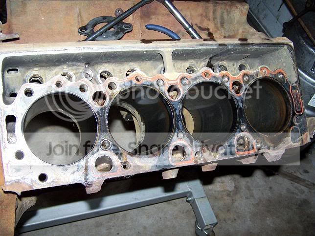

The rebuilder is sourced from a CUCV so its probably an 84. It was prety rusty on the outside but once I got it torn apart the inside was great looking except one cylinder had some water and rust in it from sitting outside. We got the block all cleaned up and I ordered a ring, bearing and gasket kit with standard bore rings. My friend that is helping me build the motor was checking the ring gap and said that it was too big, indicating worn cylinder walls and that I would probably need to get the block bored out. I was hoping to avoid this because of the added expense but the block is at the machine shop getting checked out right now.
Now I am expecting the machine shop to confirm my friend's opinion that it needs to be bored out, which means I am going to have to get new pistons, which means I am going to have to re-balance the rotating assembly. My friend told me that once we get the pistons we can put them on the rods, and then ballance the rotating assembly ourselves. I am not familiar with this kinda stuff at all but he seems to know what hes doing. He said that the crank is already balanced by itself so all we need to do is put the pistons on the rods, weigh them, find the lightest one, and then grind off the skirt of the rods until the heavier ones match the lightest one. Is this all as easy as it sounds and a credible and reliable way of doing it? I would love to save the $175 the shop charges but not at the risk of destroying my motor with killer vibrations.

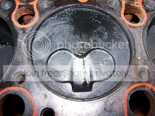

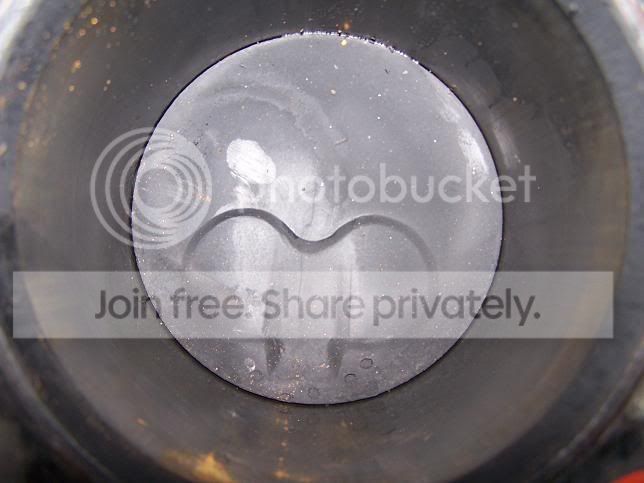

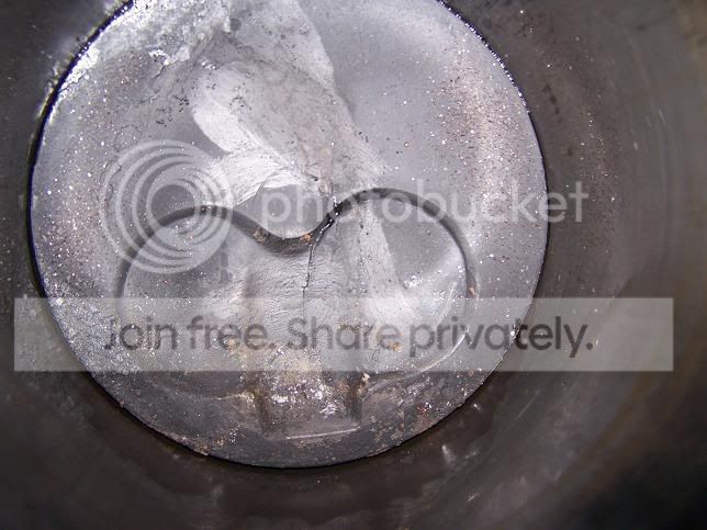

What killed it
Cracked piston 1
Cracked piston 2
Cracked piston 3
And the new block all cleaned up and ready to go.
From what I can see the pump or the injectors went way lean to cause the pistons to crack like that. If the motor had over 250,000 that is what also happens to them. My dad's 1990 6.2 had 289,000 miles on it when it started to develop piston knock (double knock sound when running) and pulled the heads to find a small crack in one of the pistons. I ADVISE you DO NOT REUSE the bolts the bolts are torque to yield bolts mean they can be only torqued once after that the head bolt will keep stretching till the bolt breaks. You better just slow down on your build time before you destory your fresh motor with a stupid move like that and that is coming from alot of experience with diesels. It looks like you had fun before it gave up.

running lean won't do that to a diesel engine. cracks are from running hot, and diesels actually run cooler under lean conditions. But it still sucks that happened. more than likely the injectors were wore out, letting fuel drip, or timing advance too much(sloppy timing chain), etc.
