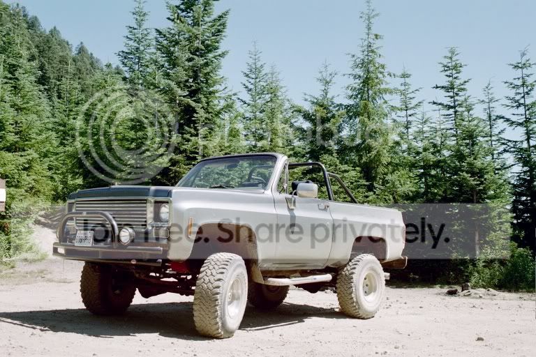

I finally decided to get it going. The rear end had gone out 5 yrs ago, just after i put brand new tires on it. i had some extra money and found a 4:10 rear end on cl.
wasnt sure if it would start I put a fresh battery in it, poured some gas down the carb and much to my amazement it started right up, stayed running even with 5 yr old gas.
I put in rearend drove it and the steering was really bad so i replaced everything, knuckes ball joints tie rod ends, still wandered around. So i replaced the front spring bushings, the funny thing the steering wheel was off centered to the left, after i replaced the bushing it is back to center.
