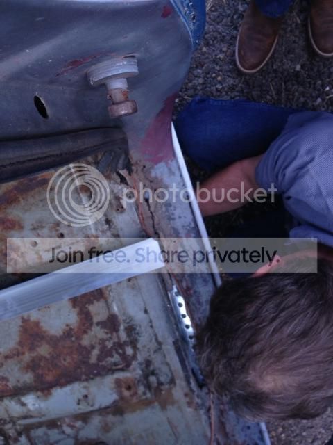

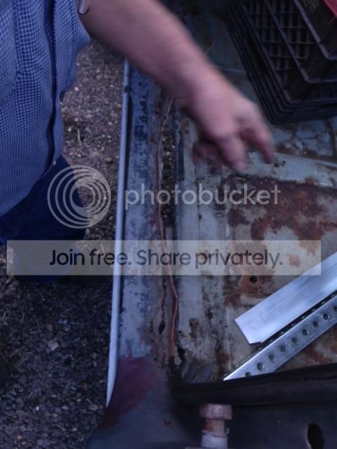

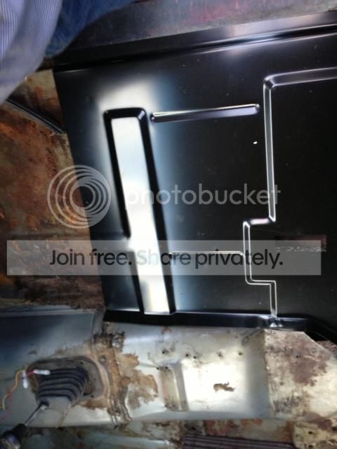

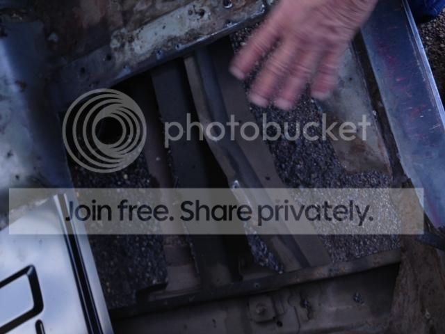

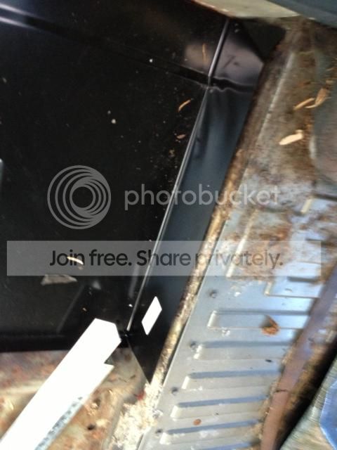

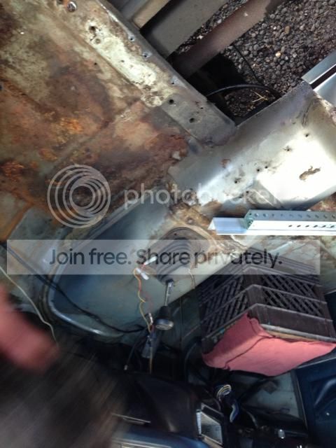

Okay so there were some things I had to fix. For one the passenger floor board was gone, in its place a street sign. Got a floor pan from LMC and used rivets to replace it.
Before
Here is piece from LMC

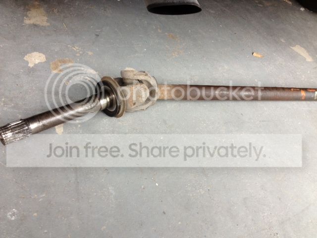

The good news is my friend had an extra drivers side and passenger side front axle. Also he had a new set of spark plug wires and a few other things.

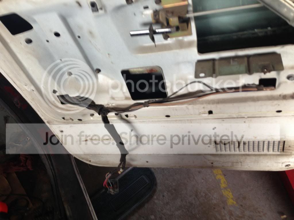

The auto window regulators were out so I put in manual ones
before
After

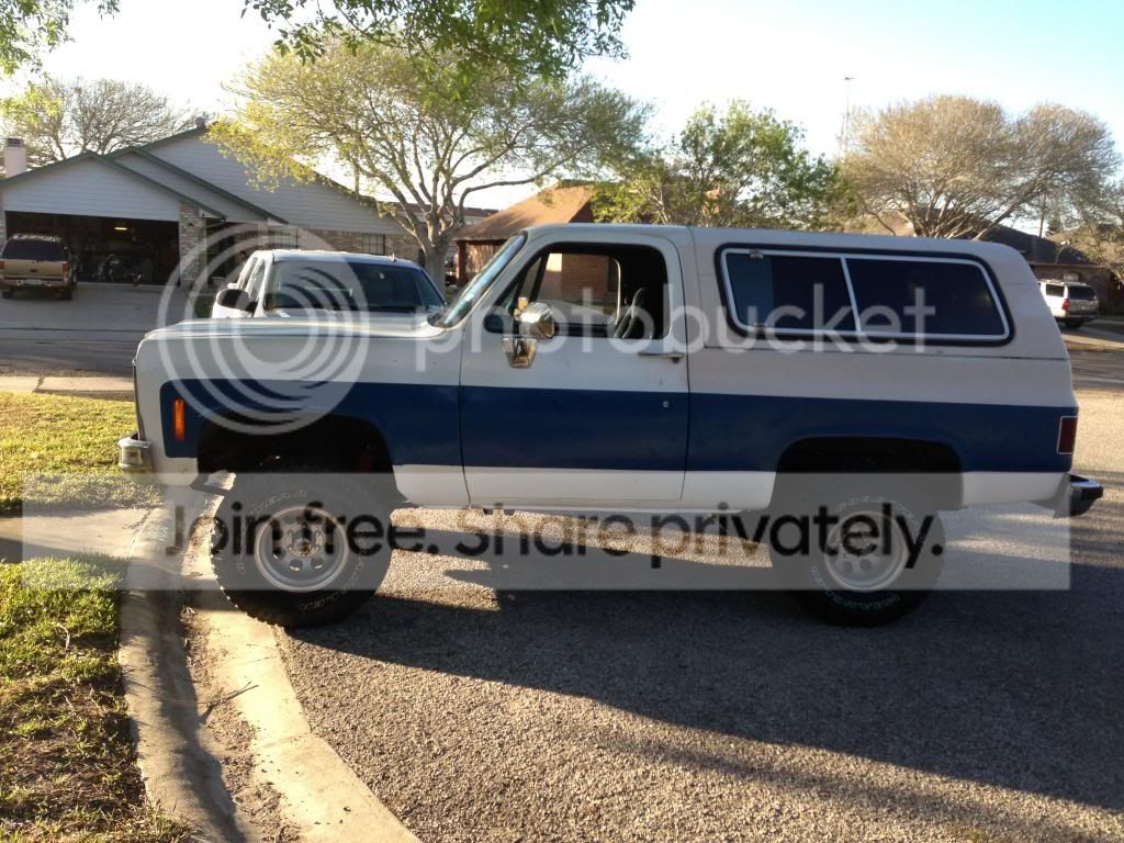

Then came the 350 engine. I went with a GM Goodwrench
I also did a 4 inch lift.

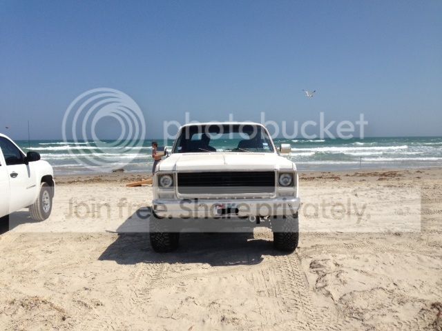

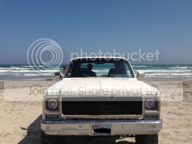

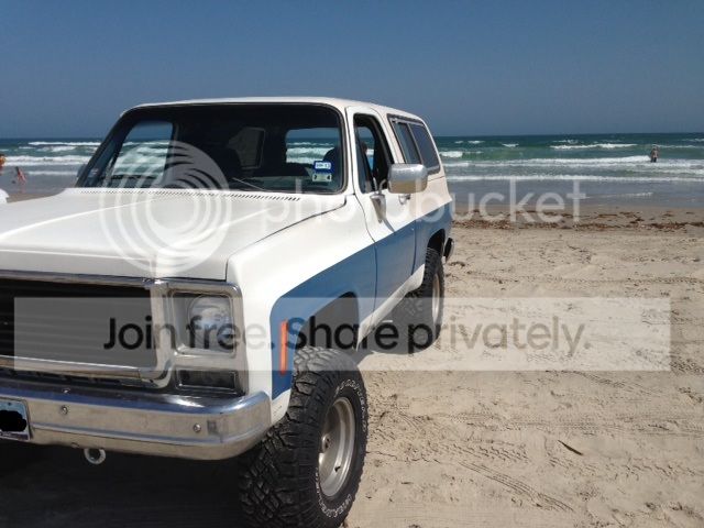

First time at the beach

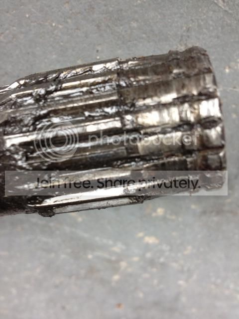

Here is the piece that broke, the end of the of the cable

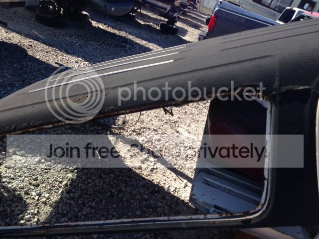

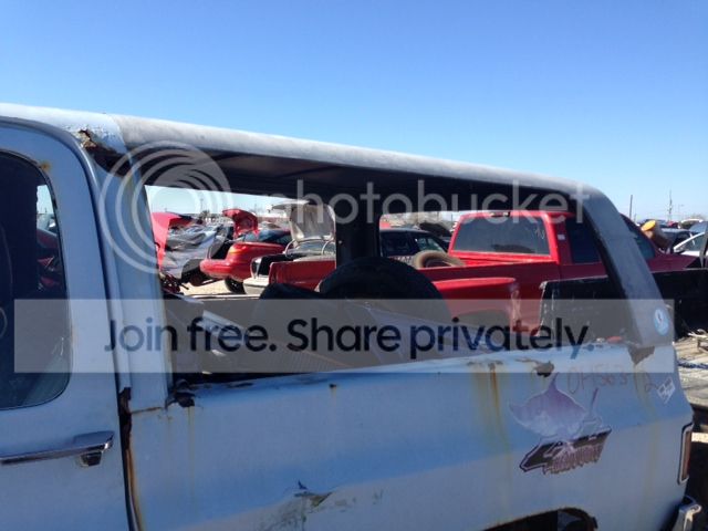

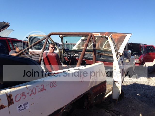

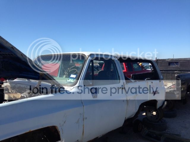

Here is the one Blazer I found, the top was trimmed to make it feel more like a full vert. I have seen someone else do this here but cant remember who is was. Also they made a weird tail gate but I forgot to get a pic of that. I think this was an 85 Blazer

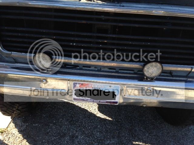

Now to the LED OFF Road Lights install. Not sure if you guys remember but I got these off of Ebay for cheap. They are from China but after reading the reviews online it sounded like a good idea. I got to tell you guys, these things are bright!! I cant believe the difference 50 bucks can make to lighting.

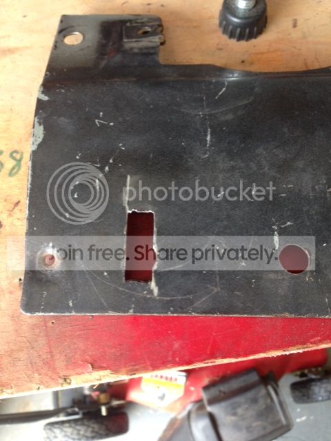

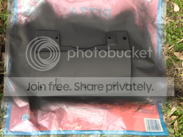

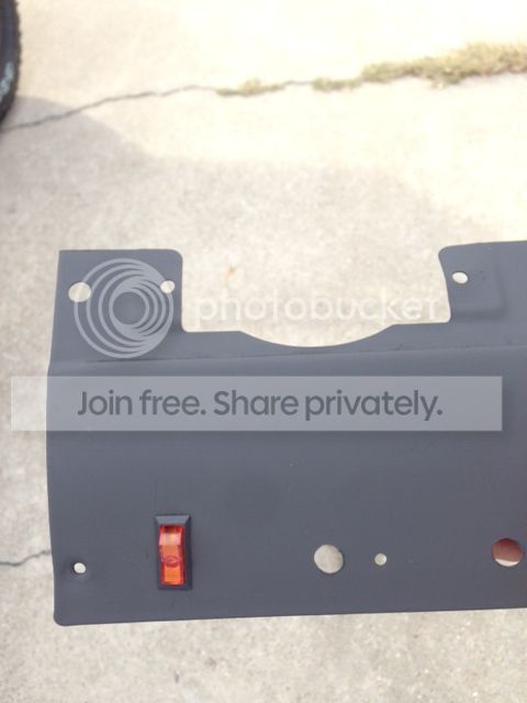

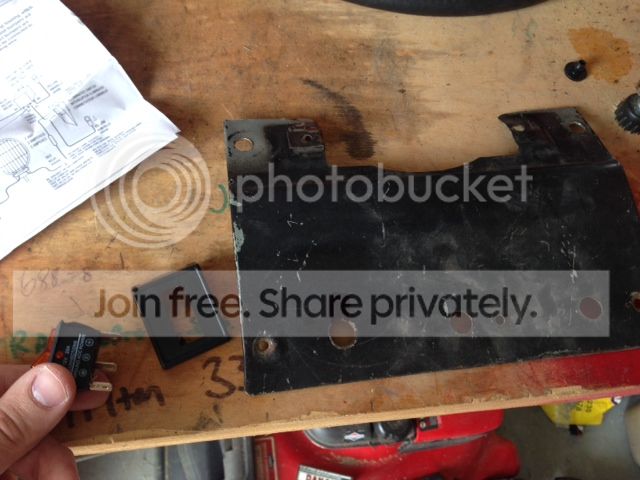

The first thing I did was cut up the panel to put a switch in place. As you can see the PO had a few round switches in here before. If you look closely you can see my mark to cut. I used my dremel with some gloves and trimmed it up
After trim
Then I decided nows a great time to paint so I did a quick couple of coats and let it dry while I worked on the wiring. You might recognize the Pizza Wrapper. Its from the best frozen pizza in the world. Pizza Corner. You can find it in the midwest but I shipped 10 pizza down here. Worth the 100 bucks for sure!!

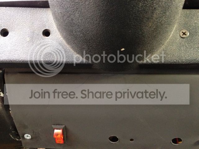

With switch installed, looks clean to me!

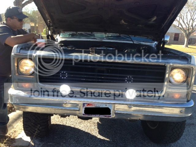

Lights Finally mounted
And lets see them on with my headlights on, look at the difference in day light alone.
Very easy to do guys and I suggest getting the lights if you are wishing you had more light on your rig.
