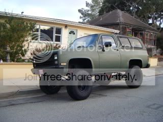

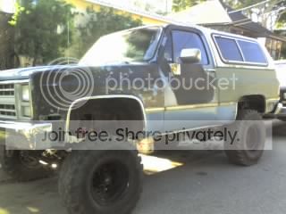

i traded my 82 toy 5 speed dual cases piece of s*** for a blown up desil stock 4wd blazer. basics done so far..
i traded my xr50 for a set of axles
a ff14b and a 44 put lockers in both 4.56 gears
im not happy with the d44 and am looking to move to a d60
super lift 8" in the front a 6" in the back
billstien shocks goodyear wrangler milit oz 37"
turbo 400 tranny with a bm kit

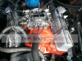

engine
LT1 block bored
compcam
durabond cam bearings
balanced rotating assembly
3.75” stroke steel crankshaft
5.7 I-beam rods
new King bearings
eagle pistons
preformer intake
fuelie 202 heads painted chevy orange
2.02”/1.60” stainless steel valves
3 angle seats
bronze guides
edelbrock 600cfm
positive seals
rolling rocker arms
all arp bolts an bla bla
mean green high torque starter
Hooker headers strait piped
morosso high volume oil pump pan.. yes oil changes SUCK almost 14 quarts of royal purp
high rise valve covers

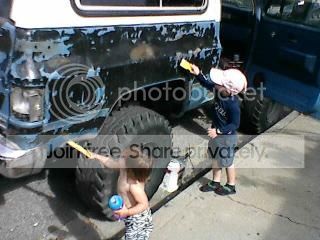

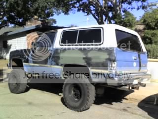

took it from my house to my moms did all the body work cause of the dust
went bare metal etched an primed

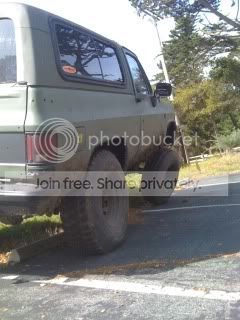

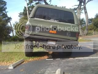

painted it italian olive krylon and camoflaaugue krylon (rattle canned) make the niece do most of the hard bodywork
engine
LT1 block bored
compcam
5.7 I-beam rods
new King bearings
eagle pistons
preformer intake
3 angle seats
bronze guides
edelbrock 600cfm
positive seals
rolling rocker arms
