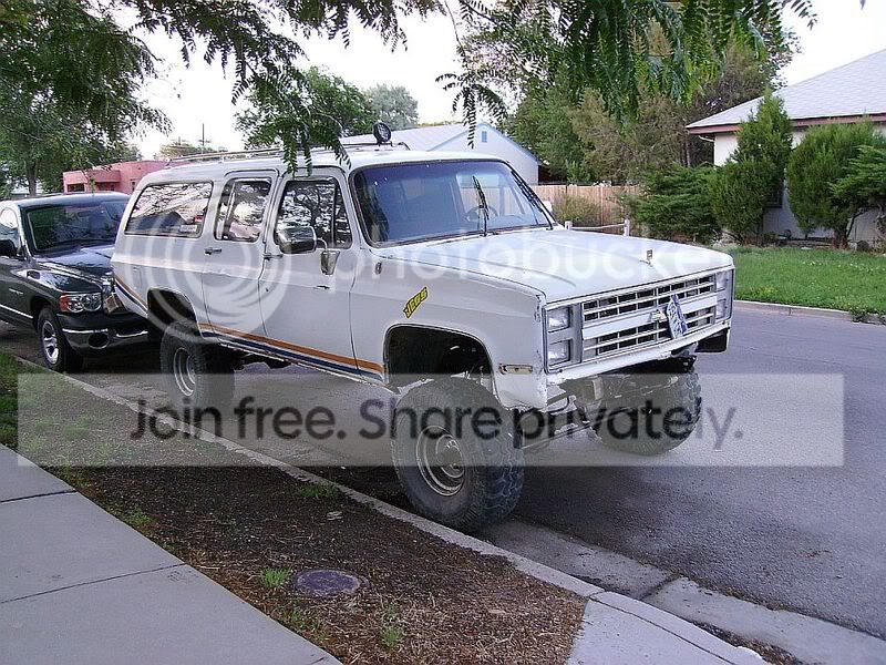

I decided to lift it last spring cause i had a ex friend who had a lifted 90 blazer. I bought tuff country's 6" lift kit with springs not blocks, upgraded 9000 shocks with duals in the front. I traded my 33"s for some worn out 36" swampers(going to be replaced).
This is what it looks like now with the lift minus the powertrain. I took the 350 out and bought a 454 that will be going in as a 468. Upgraded the th350 tranny to a upgraded 700r4. Im still looking for a corp. 14bolt rear and a D60 front. Im just not willin to spend 1300 for the D60. It has stock axles (garbage) with the addition of 4.88 gears stuffed into the rear. Before i tore eveything out it sounded like the rear was going out again, what i get for junkyard R&P's. When im totally done with it it should be a hell of a ride. Im looking for an internal roll cage and designing a external cage for it when i find a person with a bender that can weld better than me.

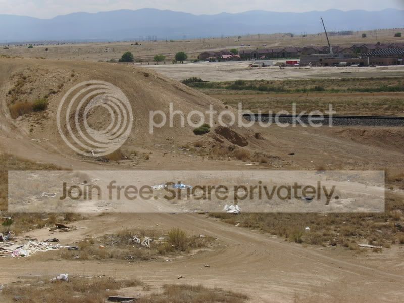

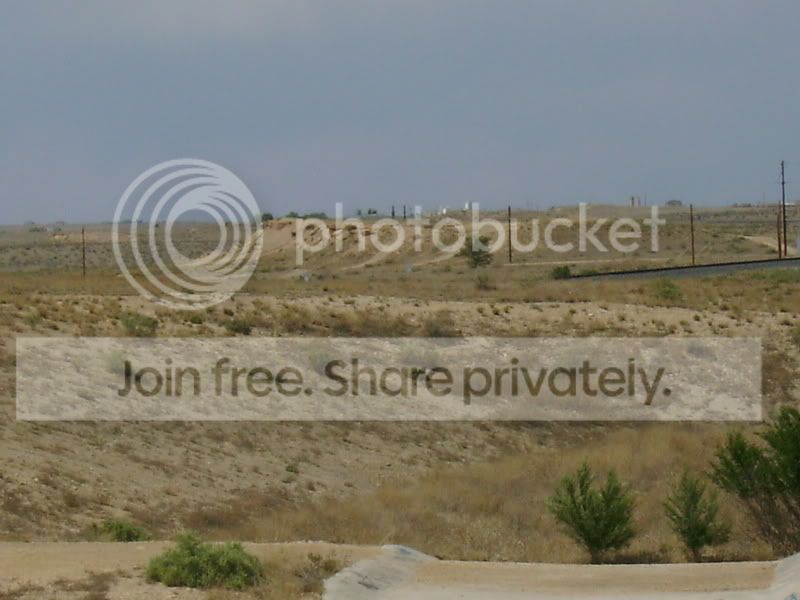

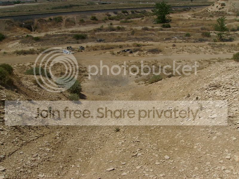

Here's some pic's of where i have played at. This is the place i play in now since they closed pueblo motorsports park to 4x4ing, they only allow atv/dirtbikes now. It doesnt look like much but when it gets nice and muddy it can be fun, though i havent been there lately people have started dumping trash there :mad:
used to be a decent place...
this doesnt look like much but you can flex pretty good on it.
i couldnt get to the axel breaker part of the play area im stuck with my 2 wheel dodge for the time till the burb gets up and going again

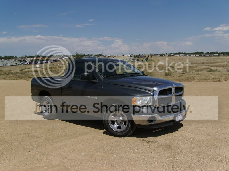

My DD (dodge was free only reason i have it) :D

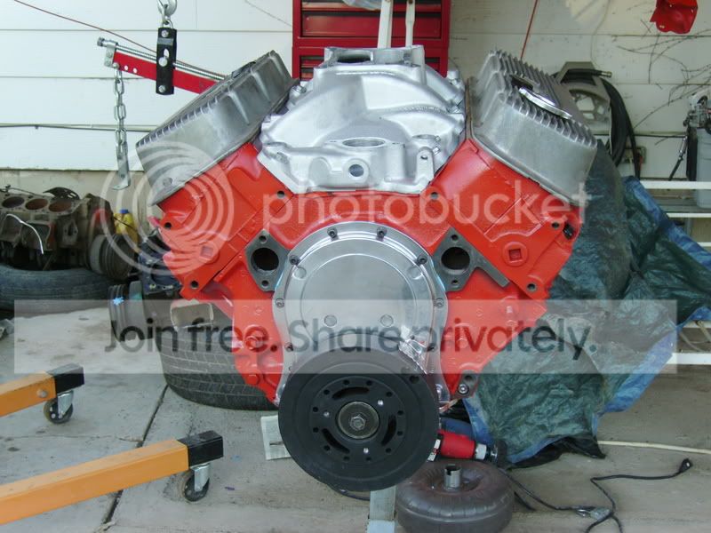

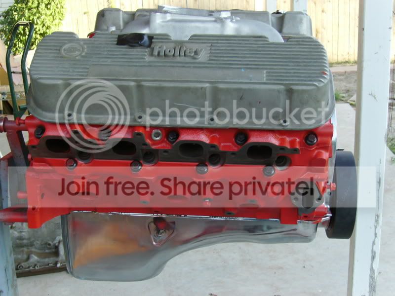

Ah yes so i finally get my motor back and holy crap the guy actually put my rear main seal in correctly! i painted it the other day.

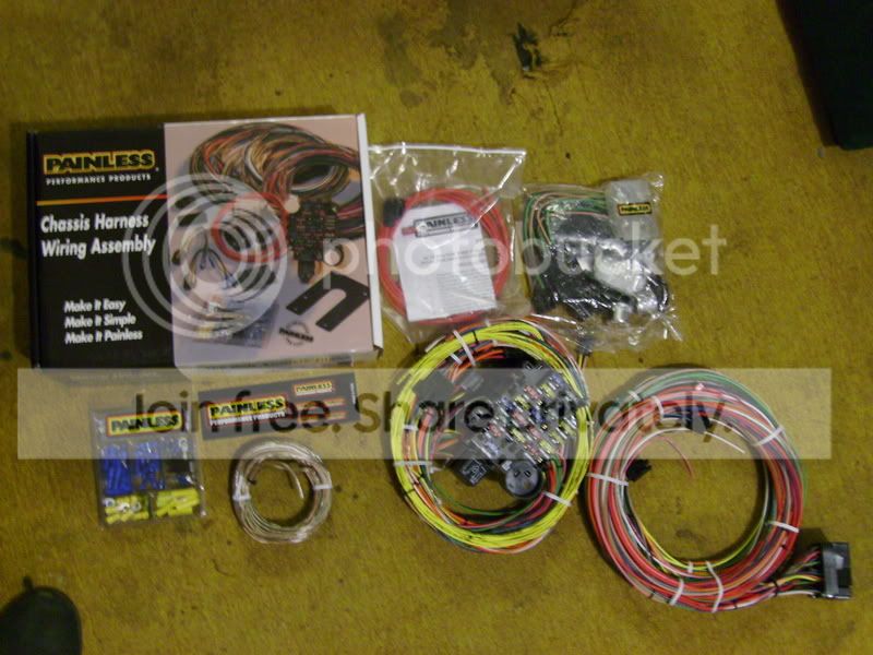

Ah yes so ive been told the parts fairy will be here friday with my painless harness. I finally went thru jegs to get it and managed to save about 250-300 bucks in the process. My plans are to strip the entire interior out and herculine the inside and try to get some bucket seats while im at it. Now that i have an angle grinder ima bout to get me some of that damable tailgate that wont come off:D, more than likely it wont be pretty.
:doah:
Hm now that the parts fairy has shown up i guess i cant be lazy anymore and this looks to be a bundle of fun :doah::haha:
is that painless harness a direct replacement harness or is it a universal?
The one i bought in the pic is a direct replacement "18 circuit GM 2x4/4x4 truck wiring system". Jeg's sell's another harness that is universal but i wanted it vehicle specific. Dafey cmon man you sure you dont wanna get in on this? :D I have a bit of experience with wiring and whatnot but dam man i looked at the instructions that came with it and im thinking its gonna take me at least a week if not more worth of work.
