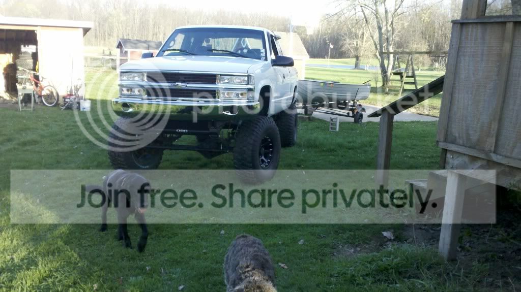

I'll just leave this here for motivation. Its like a square body that doesnt break all the damn time...
If it weren't for the damn rear brakes, my truck would be just this side of perfect...'till it got sas'ed.!:thumb:
Just looking thrue the forum's and figured i'd leave some "motivation" also. Although mine's a 97 the same principal is there
I vote solid axle sir maybe a 14bolt sf rear and a dana 44hp with some 37's. However it's your truck, just feeding ideas here.
