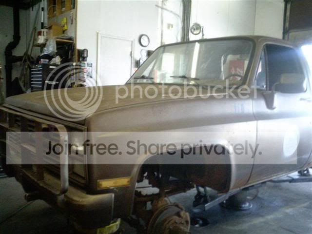

when i bought it...
a month later...
specs are stock suspension/ axles, 4 bolt main 350, TH400/np208, 34" LTBs on stock wheels, class V hitch, coming soon is rhino line floor boards, still need a rear bumper, a member here offered me one, and a great price, just a little far to drive, i have the M1010 rear shackle mounts for the back that i will install and i need some d-rings for the front... it was fun to wheel something other than a buggy for once...

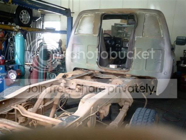

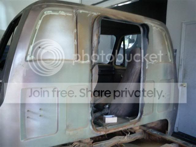

The hole in the cab was only on the M1010 ambulances, and duh, went to the ambulance body.

Impressed with the cab fix. Most people would have just gone and grabbed a whole new cab.
Curious to find out why you got a whole new 12v wiring harness instead of just converting the 24v one?

i didnt replace everything, just the "large" plug on the firewall... it just eliminated all of the diesel stuff and it is WAY simpler... one 5/16 bolt and unplug the far inside portion and plug in the new one...
i would NEVER consider changing the cab... i mean i have got a total of 6 hrs on the repair... thats going to the junkyard and the bodywork... its not perfect, but the bed covers most of it up... the part that is visible looks good, and then i bought a tool box and, well i wasted all that work cause you cant see any of it now...:doah:
