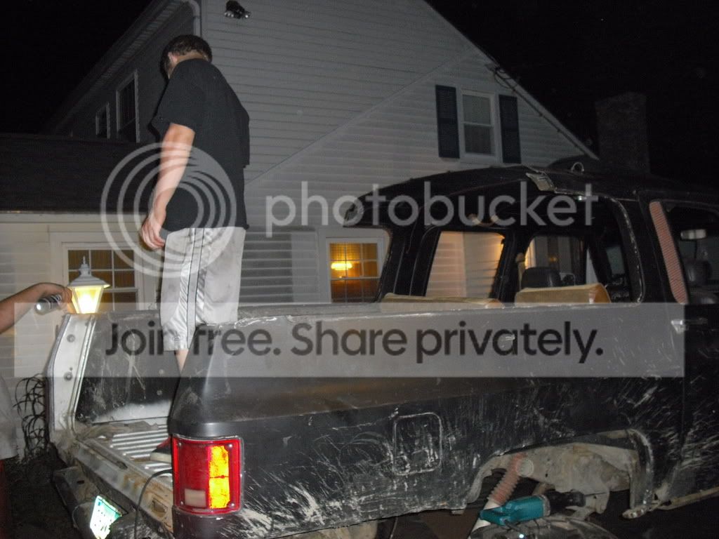

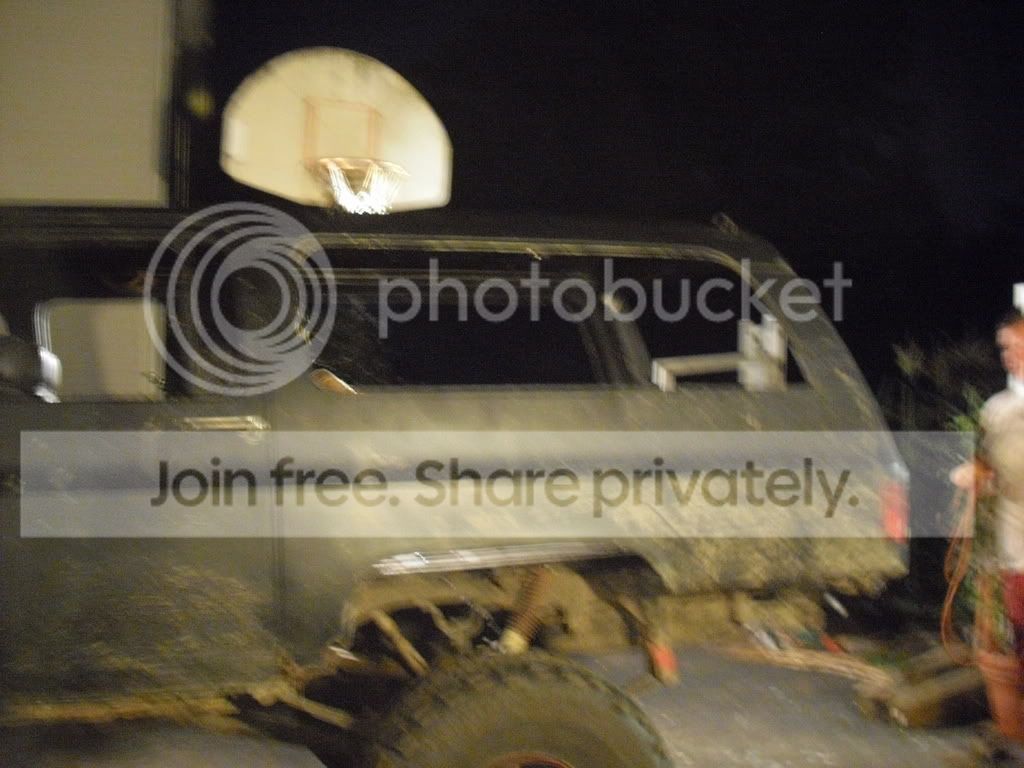

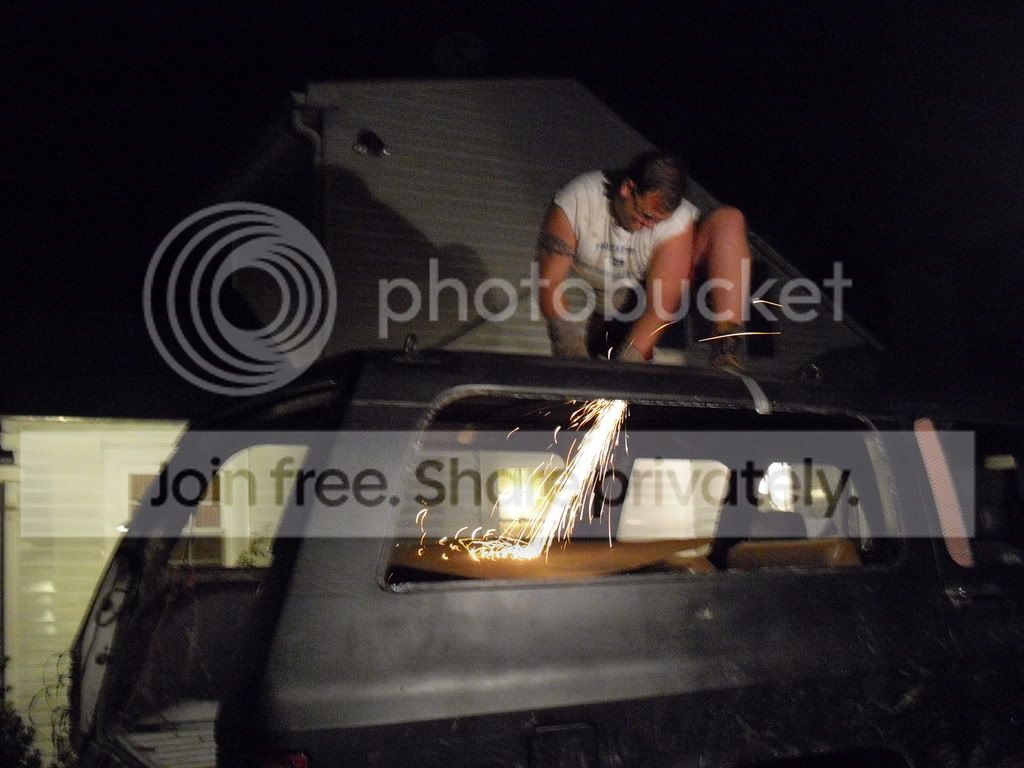

so i needed to have my cab closed, and i didnt want to do like a snapped in tarp or somthing... thats great if its off all the time or a wheeler, i liked choppedandbobbedburb's deal that he made with the sheet metal back wall, he put a window in and such, but the way that i have always wanted was to put in a pickup rear, and i have seen it done, but not like my plans
i had been wanting to do this for awhile, many reasons including; crew cabs are awesome but their wheelbases are ridickulously long, my burb had several things rusted out and ready to fall out like the wheel wells / tailpan / spare tire hole / and the tailgate was ready to fall off, i dare not even open it, my dad sold his mint dump run c10 to my friend to build into a street truck and no longer has somthing to toss brush into and whatnot, he was that jerk with a rototiller sticking out the back hatch of his minivan all strapped in, and also i recently put plates and hooks on my burbs roof to mount my spare fullsize tire, it looked awesome but it definitly made a difference in the center of gravity... having 150lbs that high makes it hard to drive, taking the tire down, dropping the rear portion of the roof, tailgate glass.. drops alot of weight to say the least and really helps out the drivability
i have been saving information, i have been working on this all week, and im almost done, couple more filler peices not welded in and no seam sealer added yet, no bodywork done either, but you get the idea
i didnt want to put in small windows in the overhang areas, that usually doesnt look as good as it should
i welded a 2x4 rectangle steel on the floor to weld the cab to, so that the cab wasnt directly welded to the floor, hopefully a little bit more secure
this is all fully welded, any bodywork is just for the pretty factor, the strength is there

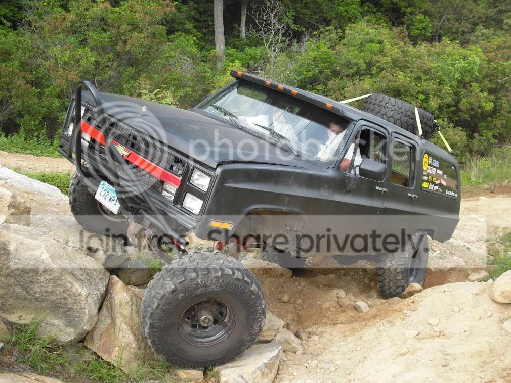

my burb

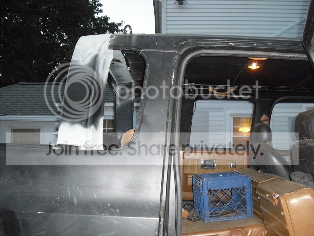

but i took my time and welded the whole thing in all the way around, c clamped the ribbed part of the roof down to the pickup cab and welded it flush, somehow, this came out AWESOME and makes it look like perfect body lines, the small gaps, the extended window areas if you will, i filled in with sheet metal and fully welded those in then put seam sealer where i needed it, mostly so that water in the bed doesnt run right down the bed ribs into the cab since the bar i welded in i only welded at the tops of the ribs

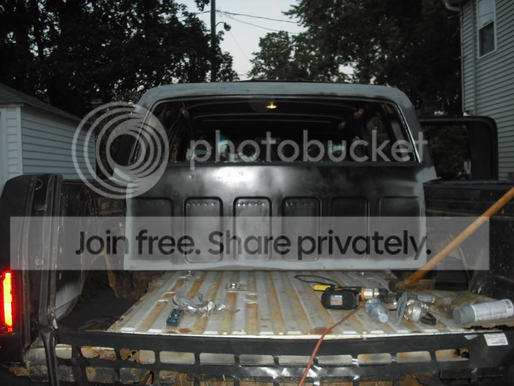

Now you know good and well that's not enough pictures. I need inside the bed pics., and how you capped the rear corner section.........and anything else I'll think of later. :D
only cuz i have full camera battery... i will brb
