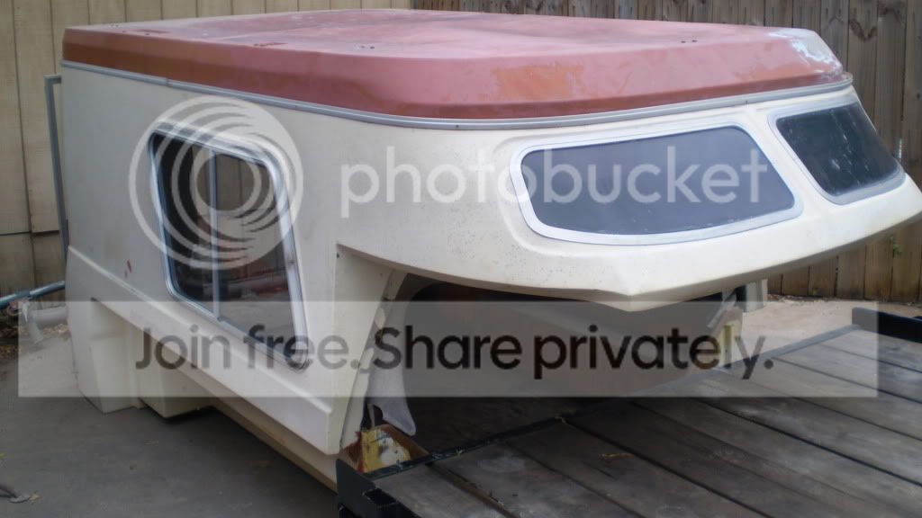

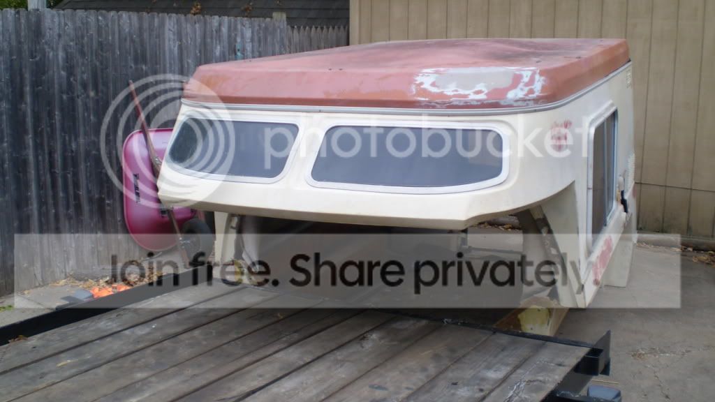

Chalet #505, it's been in a barn for a few years so it's a little dirty.

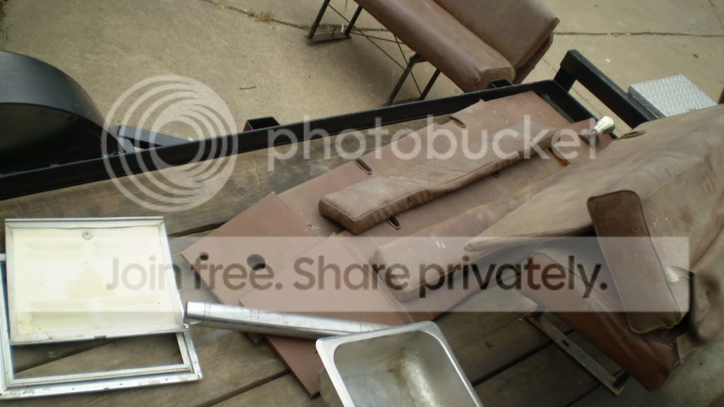

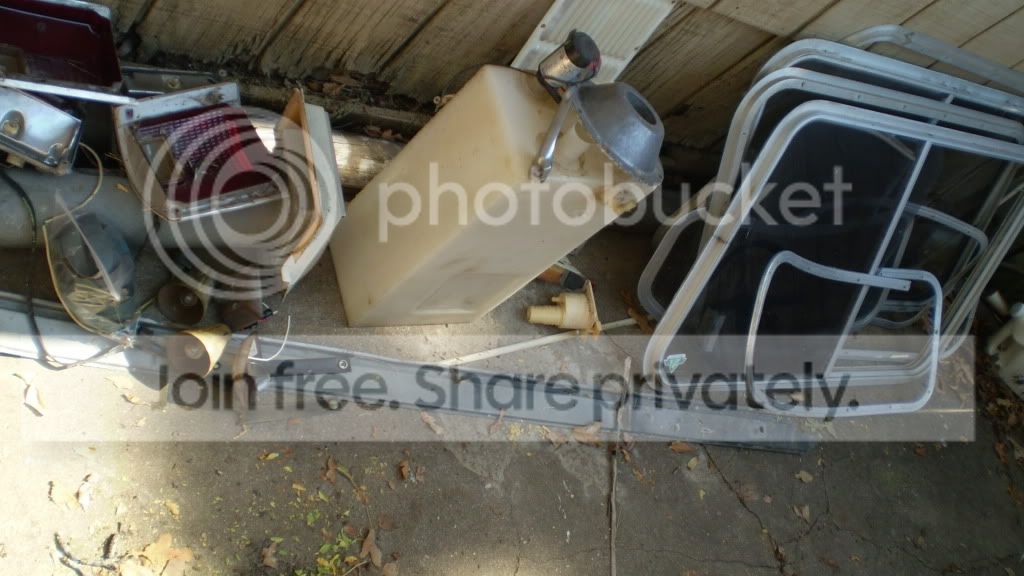

If anyone sees anything in the pictures and needs it let me know, I only pan on reusing the seat brackets and windows.
When I got the chalet home.
Random parts

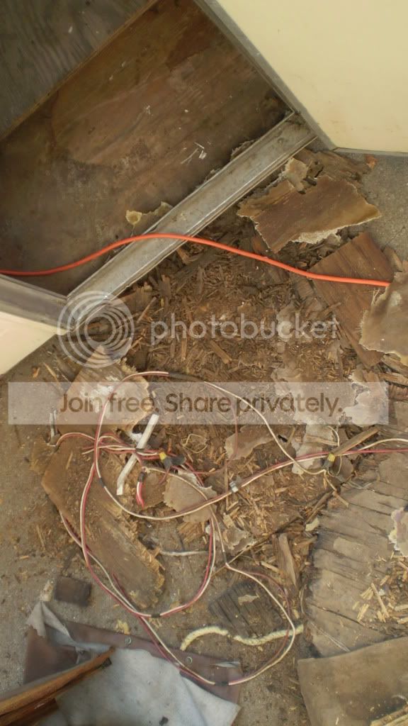

The wood for rear floor was toast, someone had the bright idea to fiberglass over the wood and didn’t make it water tight so any water that got in was pretty much trapped. It came out in a few pieces. This is only like half the floor the other half is in the shop vac

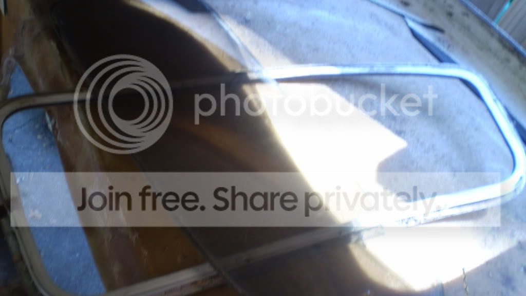

And I reglazed all the windows, only got one pic before the cameras battery died so boo

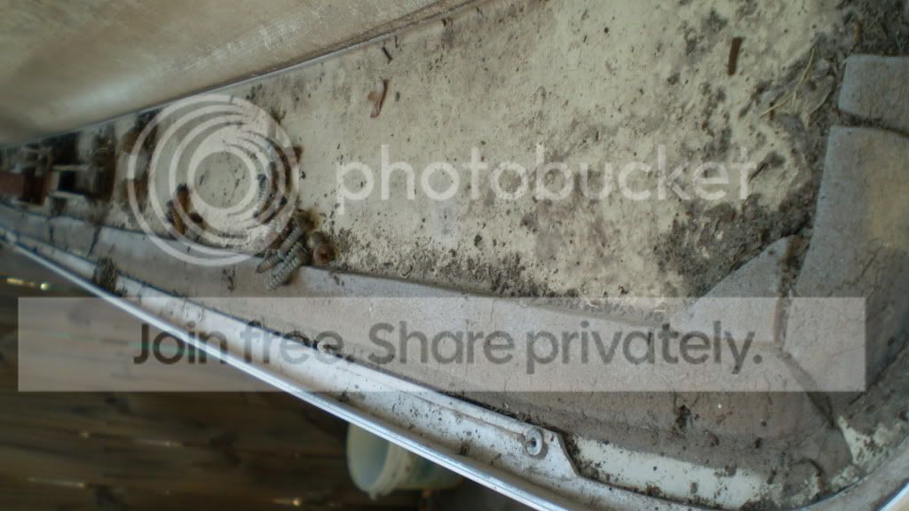

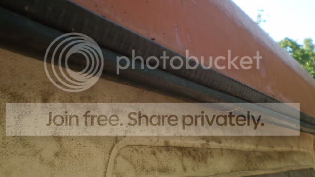

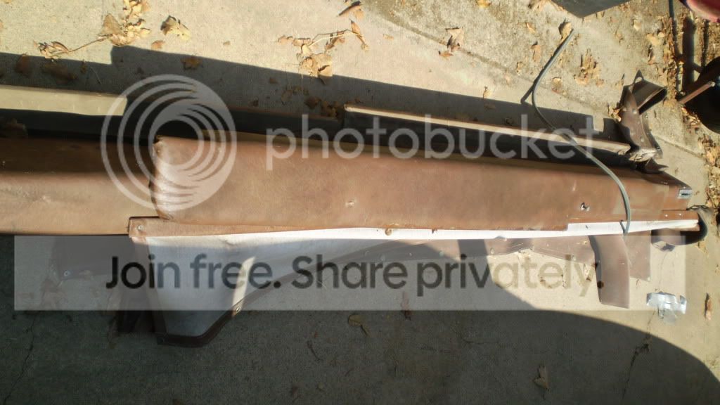

1. How does the roof seal when it is lowered?
It came with universal automotive trunck seal on the bottom of the roof, which the water will just run off the roof and pools in the clip part and it is rusting away, I am highly doubting the is the original way
Also there is foam tape down, which would work some-what if the tape wasn’t rock hard and a total pain to remove to replace.
I’m thinking the original way has something to do with the aluminum trim running around the top because right now it's only job it to not allow water run off the side
The top is not supposed to seal. Can't remember how it drains exactly. Want to say mine drained through the rear.
The roof design on these was not the best. If you look closely at the photos of the Casa Grande #1799 for sale in Livermore CA http://sfbay.craigslist.org/eby/cto/2549351849.html you'll see what looks like a lip all around the perimiter of the roof - which is what that is. The seller tells me the prior owner got tired of the water drainage problem and fiberglassed in the lip in order to send the water down the outside of the side walls.
Even though I went through a lot of effort to clean my vinyl material, I can't offhand remember where the roof drain holes were....
The roof design on these was not the best. If you look closely at the photos of the Casa Grande #1799 for sale in Livermore CA you'll see what looks like a lip all around the perimiter of the roof - which is what that is. The seller tells me the prior owner got tired of the water drainage problem and fiberglassed in the lip in order to send the water down the outside of the side walls.
And, I just bought this CG. I was just explaining this fiberglass lip to my wife who asked why it didn't look like the ones in the pictures online. Cool!
