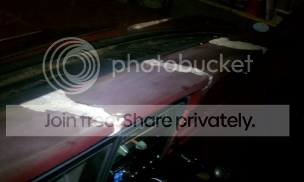

My old ford project truck had huge cracks in the dash.....I fixed it in place....for about 10 dollars.
I back cut all cracks ( some were 2 inches wide ) with a hacksaw blade to make large v shaped notches and scuffed the entire surface with some 100 grit paper.
then I filled the notches with some of that instant foam from home depot and let it set overnight.
next day took the hacksaw blade and trimmed the foam flat...

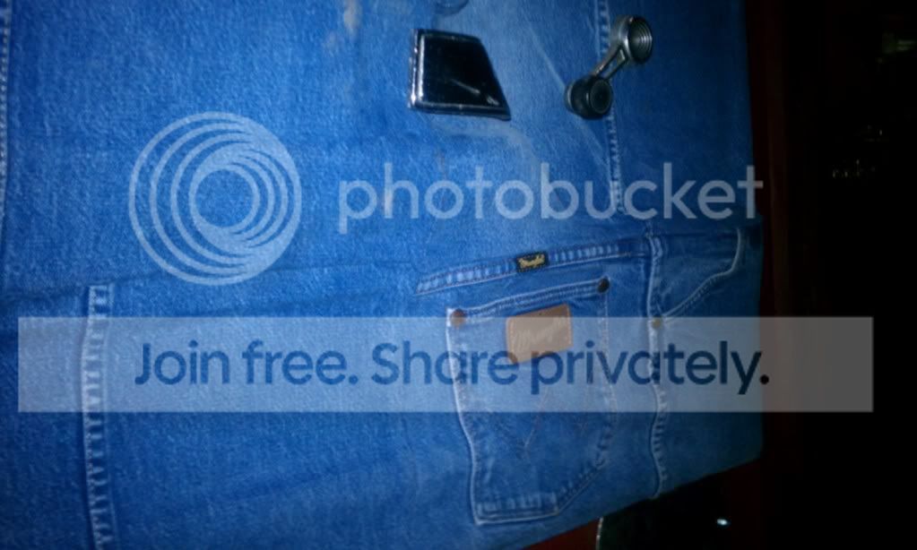

at this point I could have skim coated it with bondo or something,,,but I had my wife cutup some old blue jeans and made a covering for the dashpad.....
sprayed the jean material and the dash pad with 3M spray adhesive,,,glued it down and trimmed the edges.....done.
she also cut up some jeans and made door panel covers and used the pockets in the jeans for little junk holders on the door skins..:D
