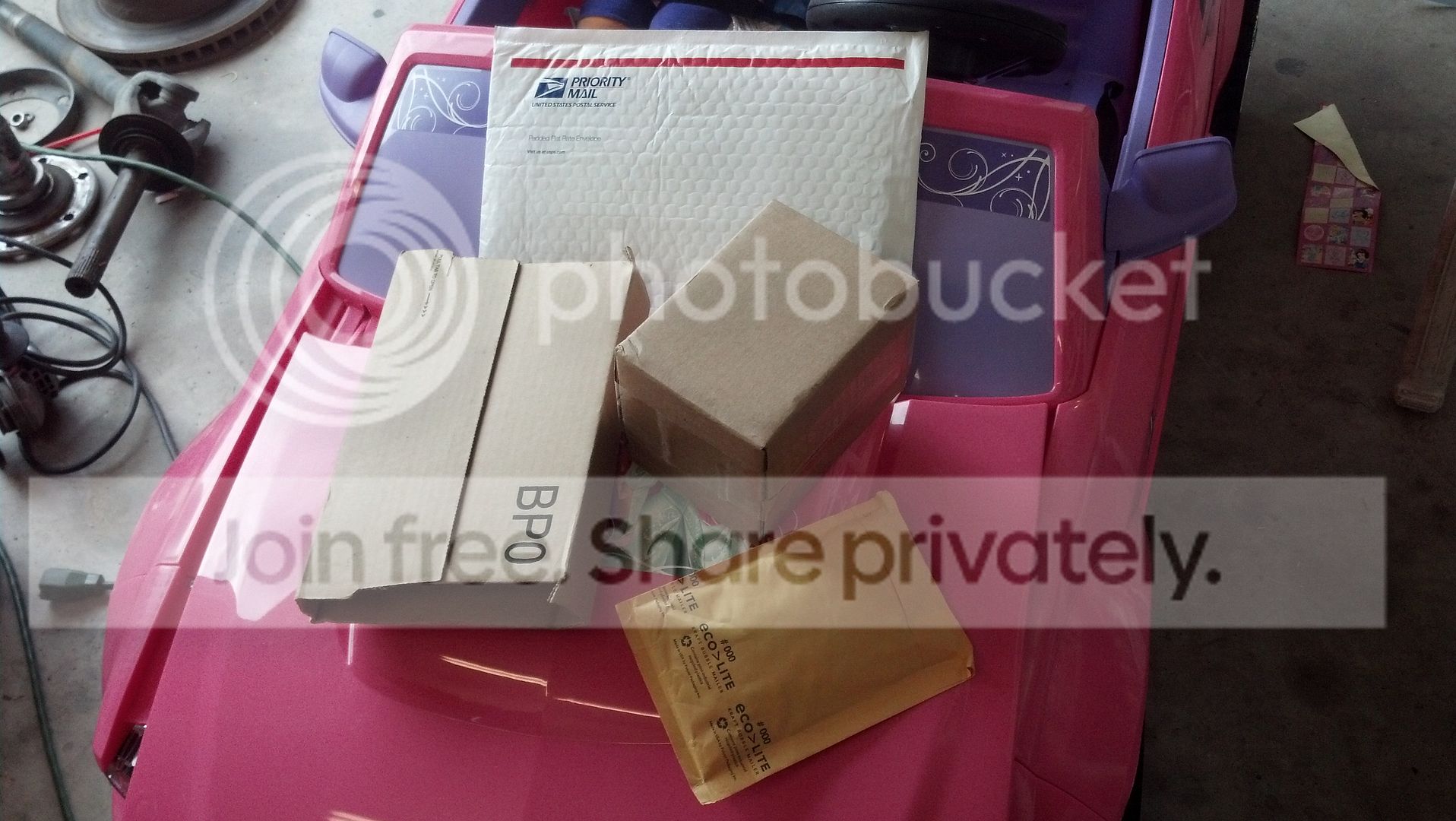

Parts coming in.

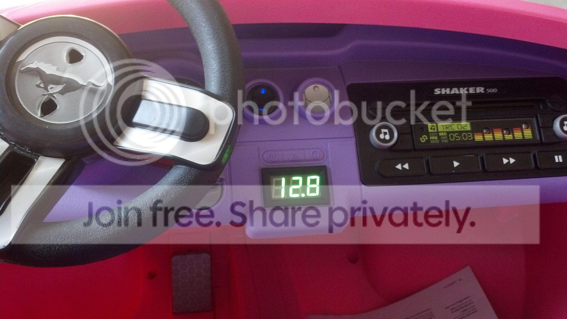

Here is the volt meter and the light switch. There is also purple glow light under the Mustang. I will upload pics in a bit.
