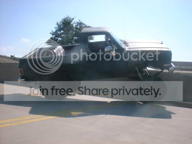

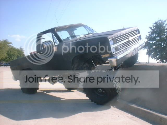

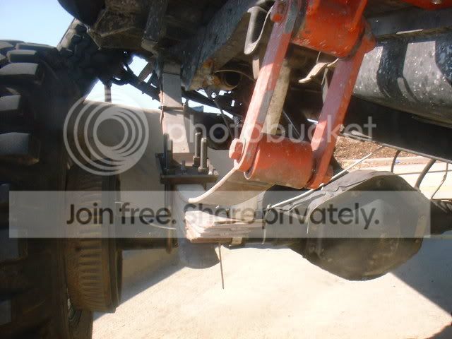

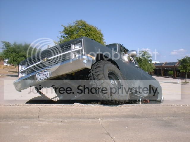

    Well finally flexed her out with the new 1 tons.
    Did very well imo, alil over 52" off the ground. Passenger door wont open, rear drivers tire is just touching enough to not turn. I beleive all shocks were maxed. I know 3 of them were.
    Yes my camera sucks!

    Man, i'm suprised your truck could climb that with no front driveshaft! :haha: :haha: :haha: Good looking flex man! What springs are you running up front?

    I am interested knowing what rear shackles you are using and what springs those are? Nice shots.

    save you rears and put or make a clamp. i am always weary when i see main leaves do that---otherwise looks real good.

    Koldsimer- with my current engine problems im surprised also! I think they are 6" rough country springs, but honestly i dont know.
    Rear is a DIY4x shackle flip with 6" shackle and factory 3/4ton truck 56" springs.
    I plan on putting clamps on them to save em.

    very good for stock length front springs!
