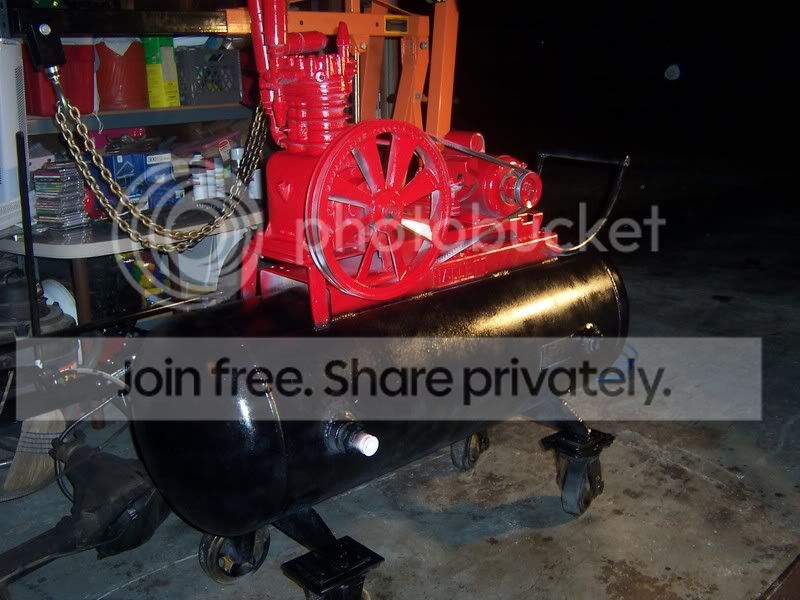

I would seriously look around on CL and eBay before I dropped that kind of change. I bought my compressor for under $100 (no not a typo, and that was delivered!) off of eBay and after some fresh wire and having the motor rebuilt (I ran it as it was for about a year until my dog pulled the cover off in the rain and fried it) it runs like a champ.
So I have about $250 into the whole thing and it keeps up with anything I can throw at it.
Maybe find a shop that's closing up that has a nice setup they'd like to get rid of.
Here's a picture from when I was cleaning it up. I've ran it regularly for over two years now without any issues. Oh and after this one I'll never buy an oil-less compressor again, this thing is quiet!
