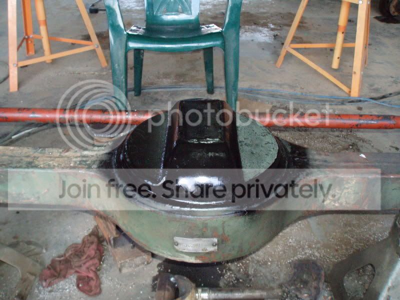

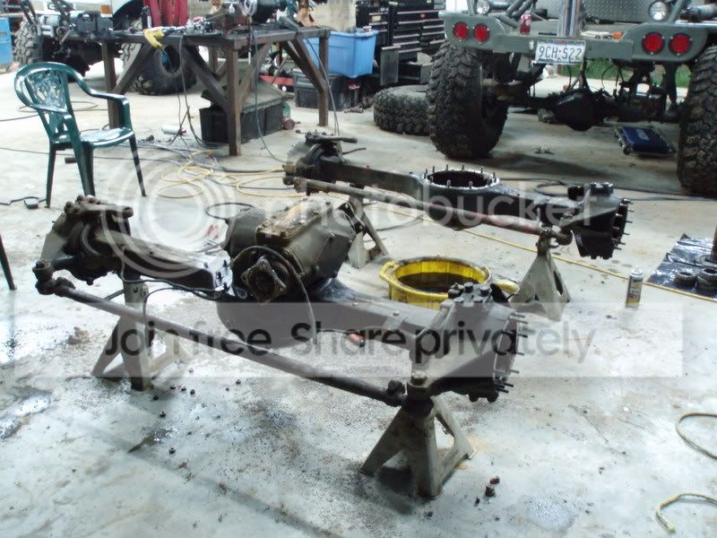

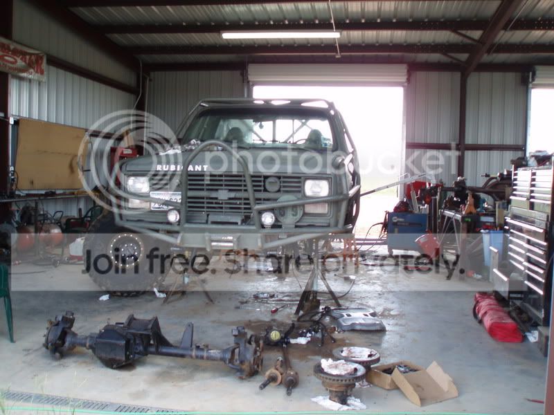

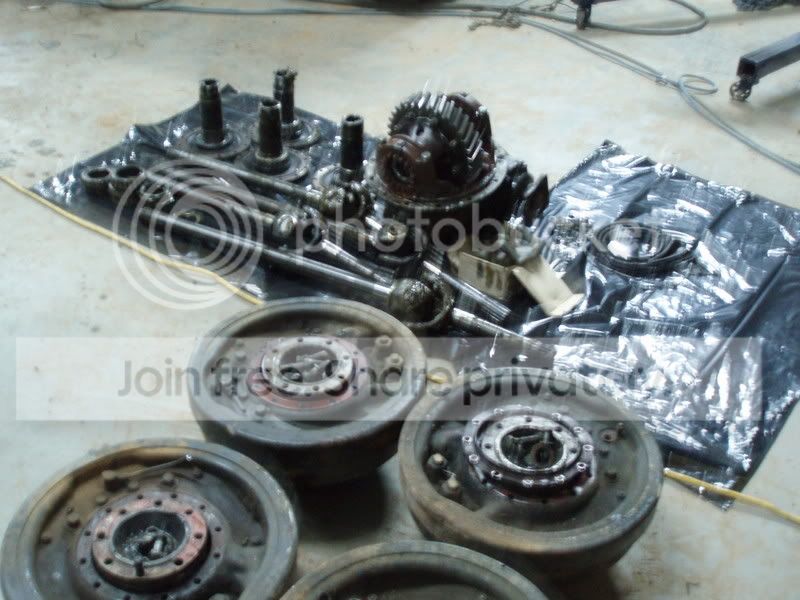

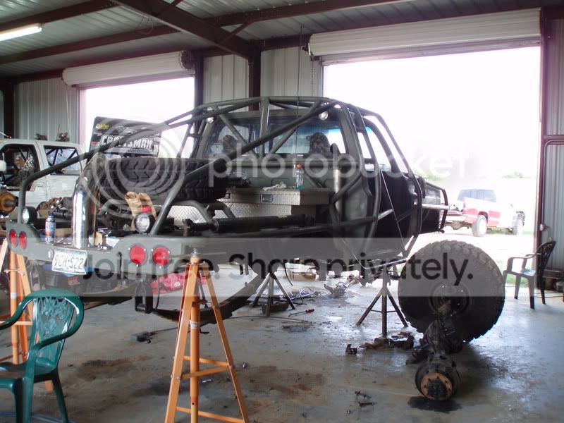

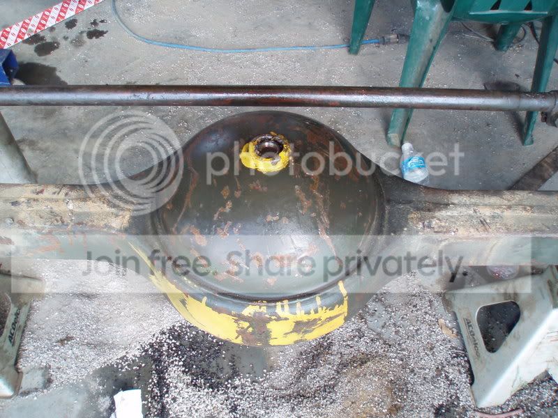

I broke the ring and pinion in the 60 for the 2nd time, so I decided to go rockwells. While I was at it I decided to go rear steer.

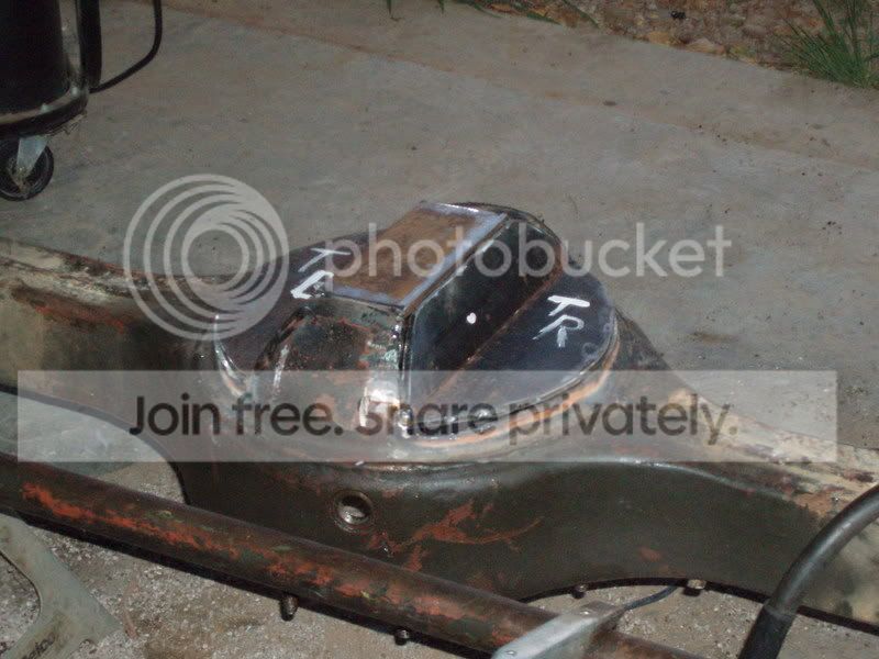

sweeet man! why did you "mohawk" the cover? what benefits does that have? also for rear steer do you run hydro lines to the back also? wheres sealy? id love to see this in person someday, sorry for all the questions, but i am very interested!
I mohawked the covers for mor clearance under the diff.
I am probly going to run an electric pump for the rear steer, just have to find a place to mount the pump.
Sealy is 50 miles west of Houston off of I-10.
Why is the spare mounted so high in the bed? is there something that mounts under it?
and whats the big pipe on the back for? is it just sitting there or actually used for something?
Its just sittin there, I was using it for a template
