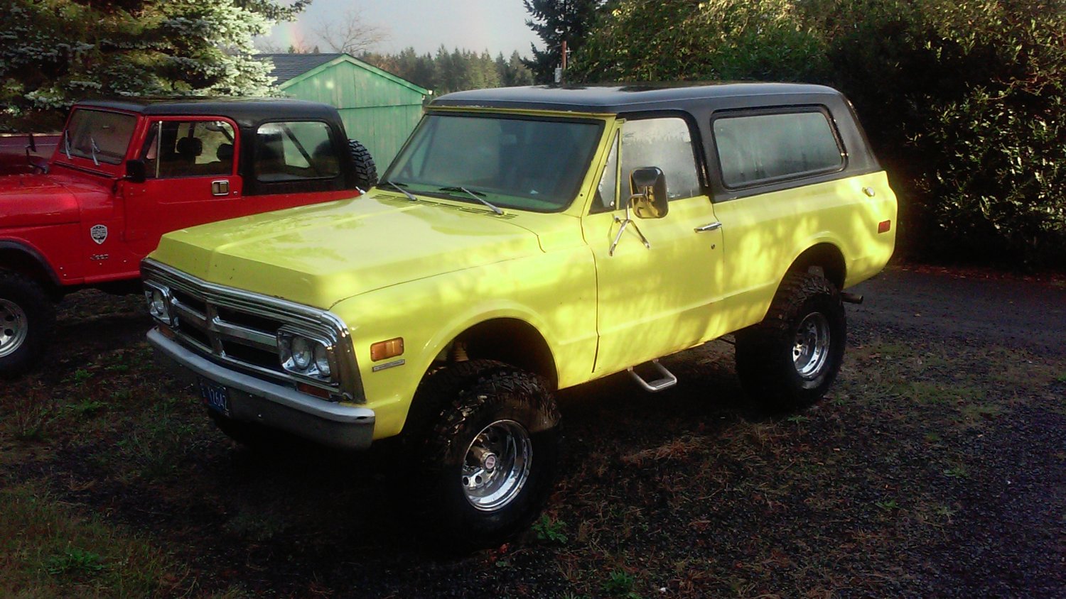

My jimmy
Well, there’s a lot to be had if you stick around
Including a couple of Epic first gen blazer/jimmy builds
looks pretty sharp
What are you going to do to it? It looks clean in those pictures, are you doing a rebuild of the engine?

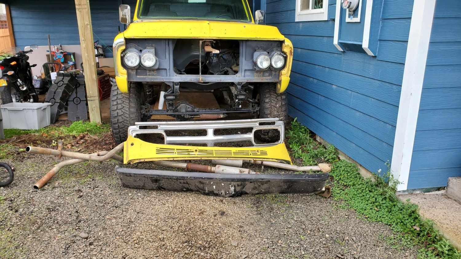

I am in the process of reassembling.
It was running/driving before the previous owner pulled everything. Engine is perfectly fine. A healthy 350. The guy I got it from pulled everything to drop a 454 bored to a 468 and basically said he was done and didnt want to do it anymore. So I jumped on the opportunity to obtain everything
I helped him install the 6 inch lift (brand new)
It came with brand new hard line brake lines, as well as brake hoses (with the lift kit)
Brand new gas tank
Brand new brakes already installed (minus the lines)
Brand new body mounts which I'm in the process of installing now since every is pulled and out of the way
The tires have MAYBE 50 miles on them

I'm thinking that's one reason he decided he didnt want anything to do with it anymore.
I'm just putting the 350 back in it.

Definitly putting back together. Not doing anything crazy.
