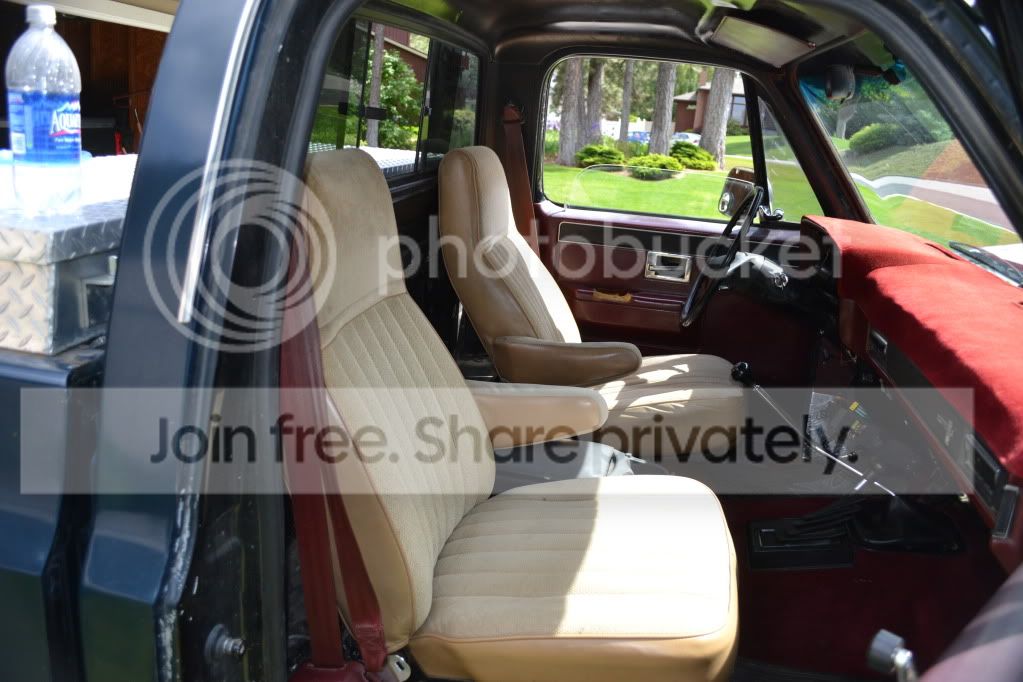

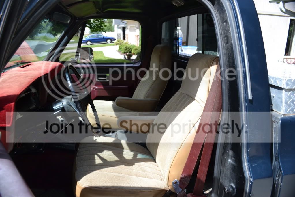

Got a set of old suburban bucket seats from a friend and after a few months of dragging my feet, I finally got them installed. Was fairly simple once I dove into it. Just made a few cuts in the seat brackets to bend them up to fit in the regular cab and braced them, then used some overkill 1/4 steel I had sitting around, cut, bend and made my inside bracket.
I am fairly pleased, truck had a 60/40 bench from an early 90s welded to the floor when I bought it 11 years ago, then I modified that so it bolted to the stock bolt holes. Gave it away when I wasn't driving the truck and the last 6 months been dealing with a wasted old bench with saddle blankets.
My friend has the matching center console, haven't gottan it yet. Also thought of looking for a center fold down seat at the wrecking yard that is like the one in my 2006 Ram
