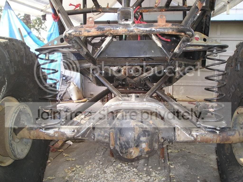

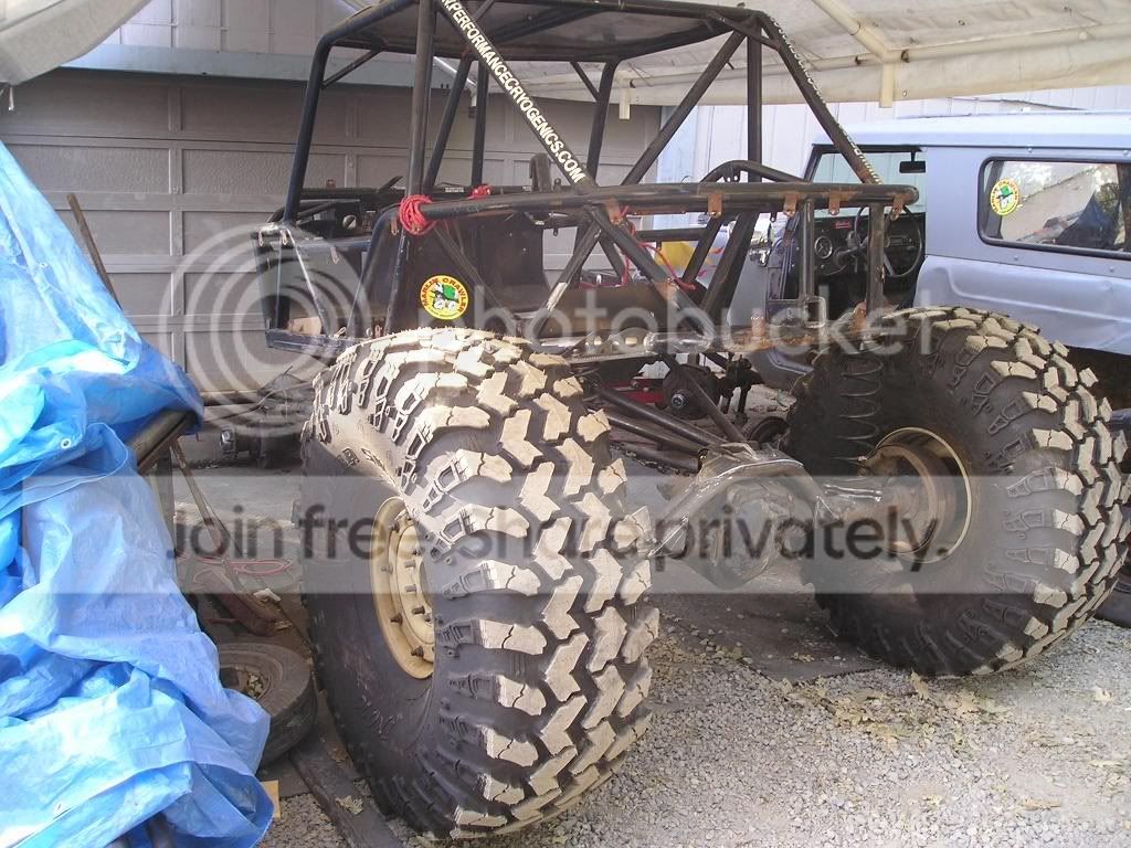

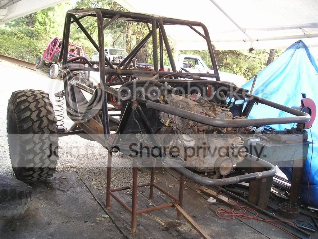

Ok, so it's not really mine, but I'm helpin out with the build. Belongs to my bud and his brother. They picked up the chassis pretty much already built for like $200. Doin ALOT of changes of course...Was origanally set up for a chevy motor and drivetrain. That got yanked in favor of 22re, toy trans and dual toy cases by Marlin Crawler. The rear will be a dual triangulated 4 link with XJ coils. D70 with Detroit and 7.17 gears. Front will also be 4 linked, but with coil-overs. D60 with 7.17 gears. Still alot left to do, not even close to being finished. This is pretty much just a wheeler/thrasher...It prolly won't get any paint except on the bare areas..., nothin but the bare minimum. No bling on this one. :blink: :pimp1:

At the frame end, the upper links are rubber busings, Johny Joints at the axle. Lower links have bushings at the axle and Johnny Joints at the frame. I had my doubts, and when I mentioned it, they didn't think it was gonna be a problem. :confused: I would have thought that Johnny Joints all the way around would have worked better....Time will tell if I'm right or not. :D

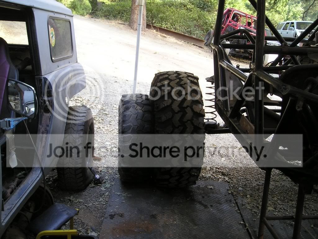

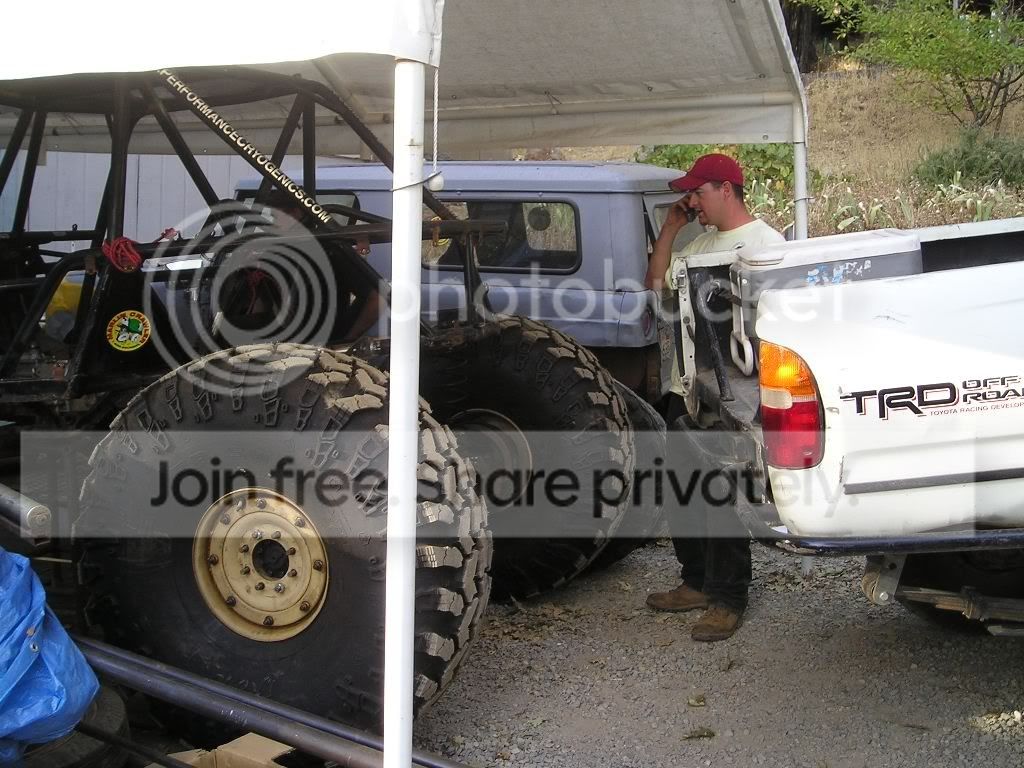

No wheel spacers....Hummers wheels on backwards. They haven't fully figured out the wheel situation yet. :wink1:
It's definitely got spacers, the Hummers are right side out.
