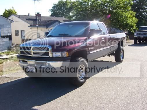

Well after looking for some time I found one. I got a 2001 Cummins HO last week. Crew cab, longbed, 4x4, 6 speed, fully loaded VERY well maintained with 102K on it. I absolutely love it. Its hard to find anything but a white automatic. What do you think? I am going to do some mods to get a little more power and mileage.
I wouldnt say its a "towrig" to me yet, its more for hauling our bikes, but one day we plan to get a toy hauler.

Good find man, clean looking truck.
What do I think? I think you got the wrong transmission.:D Although I like my dad's H.O/6spd like yours, I prefer the modified autos myself.
I bought my '01 S.O. auto with 101K, and the truck was/is like brand new. I'm sure yours is the same. Leather or cloth? Early '01 or late 01? I like the rims, what size tires? Gear ratio? FUEL PRESSURE at the VP44?????:crazy:
Here's a shot of mine when I bought it off the lot.
current.
