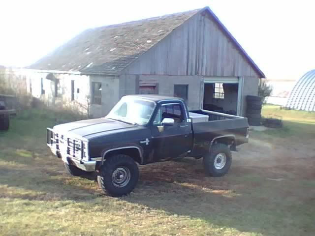

80'427's '79 K30 with 37x12.50x16.5" Goodyear, millitary surplus tires, on OEM 16.5x6.75" steel wheels.

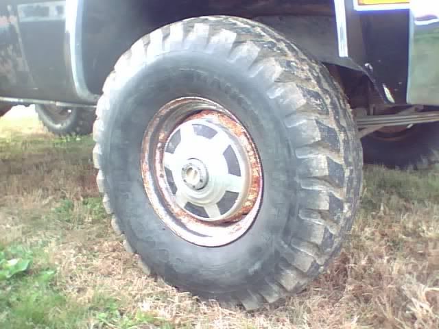

My buddy's 1985 K10 that I have been working on, 36x12.50x16.5" Goodyear millitary surplus bias ply tires, on OEM 16.5x6" steel wheels.
close up of the wheel and tire (I need to paint the wheels yet . . .)

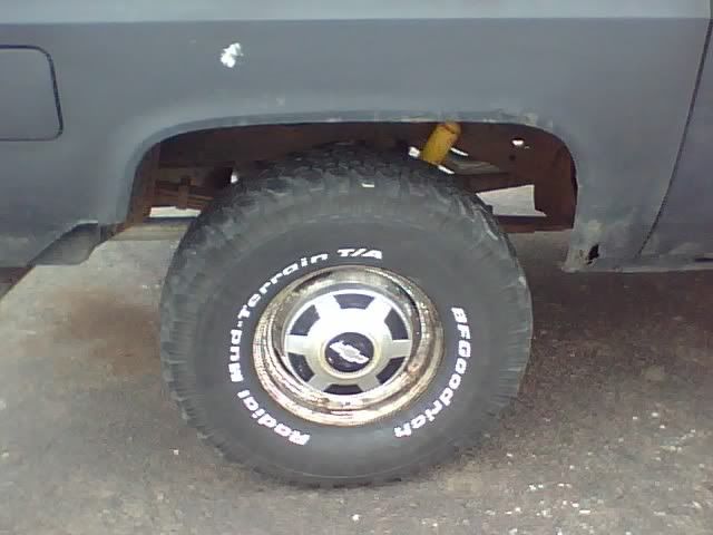

My 1988 V10 Suburban with 35x12.50x16.5" B.F.Goodrich Radial Mud Terrains, on OEM 16.5x6.75" steel wheels.
