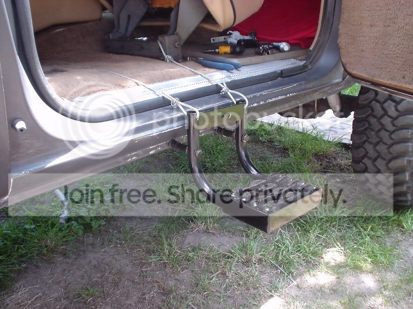

I need a step for passengers to get in, so i made this. How much weight do you think it can hold :confused:. I tried it out and it held up fine, and i about 200lb.
It also tucks nicely under the passenger seat. Flame :weld:it as much as you want, i need suggestions.
One thing I can think of is to put a piece of flat stock between the two tubes that rest against the rocker lip. It will distribute the load more. Otherwise, you may start to bend that lip over time or if someone bounces on it or steps on it hard, whatever. Anyway, nice idea and execution.

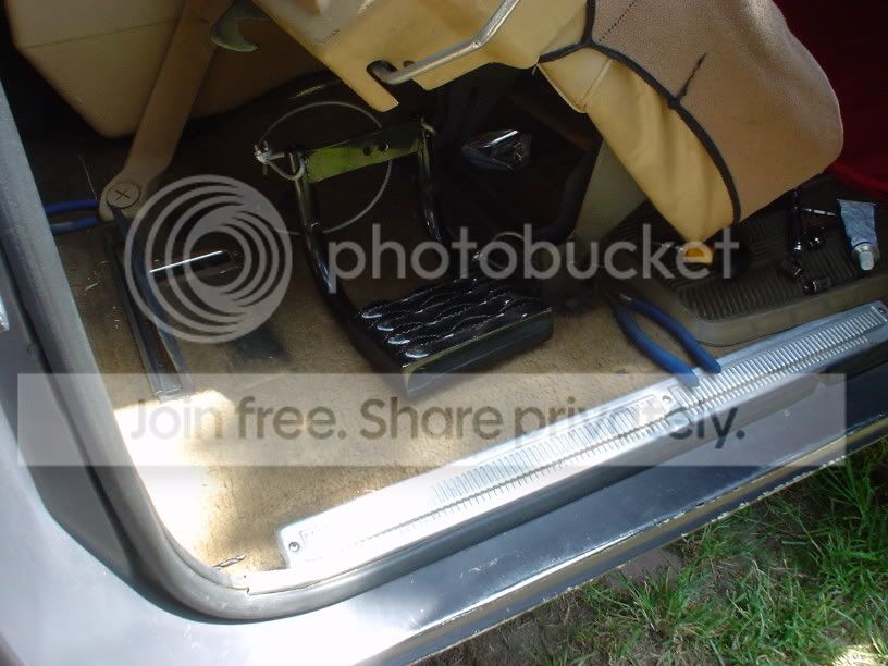

thats the only suggestion I would make. Seems like a great idea. Pinchwelds are strong. I lift little compact cars all day long by nothing more than the pinchweld. Does the seat have to be up to stash it away? if so that could be a big pain if the person sitting in the front wants to use it too.

No, the seat doesn't have to be up to put it away, you just have to put it at an angle and it slides under nicely. Thanks for the suggestions

Excellent idea! Unfortunately, Jay's stirrup step is still my favorite. Seen it in "action" and it works really well. The only other suggestion I could make is to beef up the back side of that pinch weld area as well. It would not do to have some loved one end up with a cracked tailbone.
