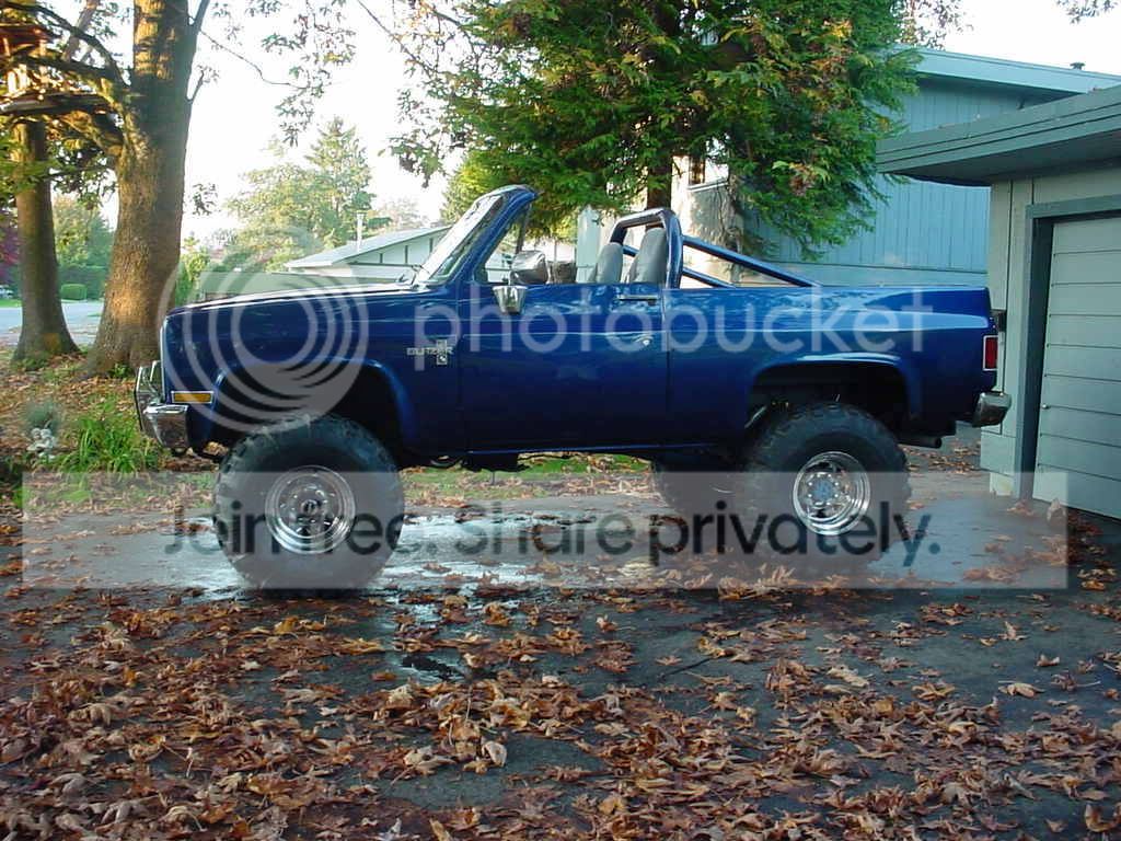

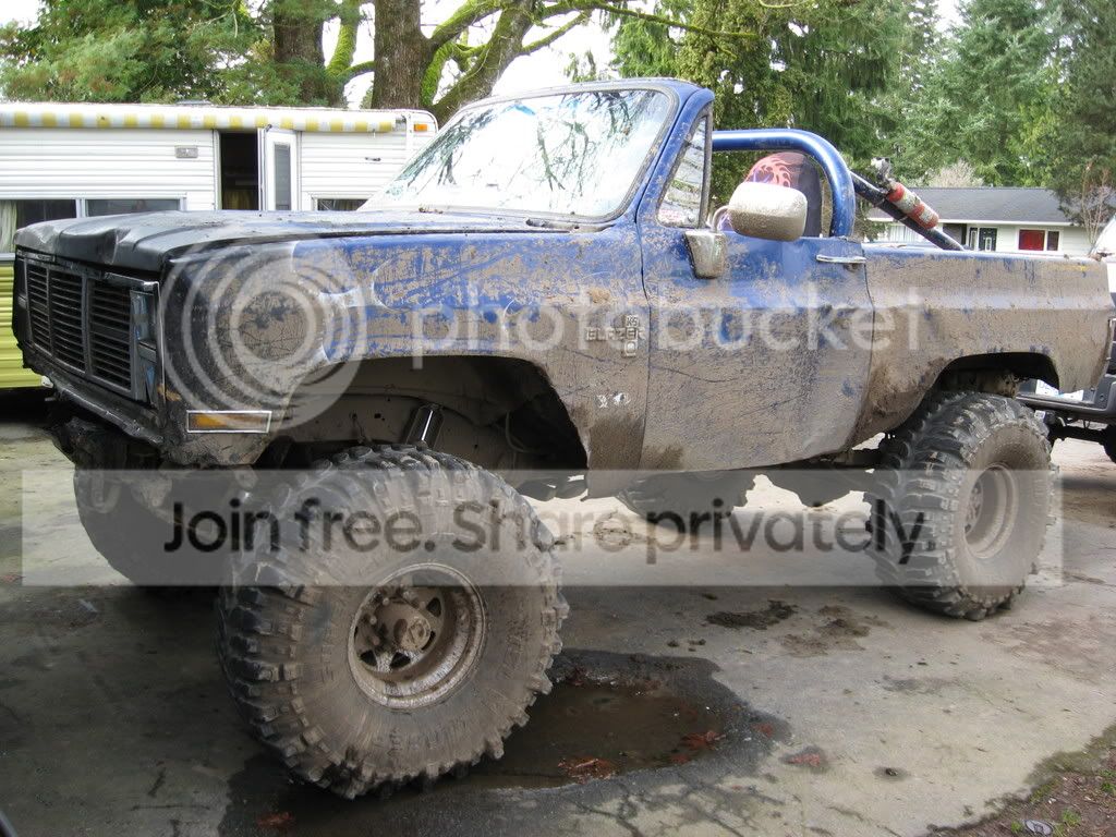

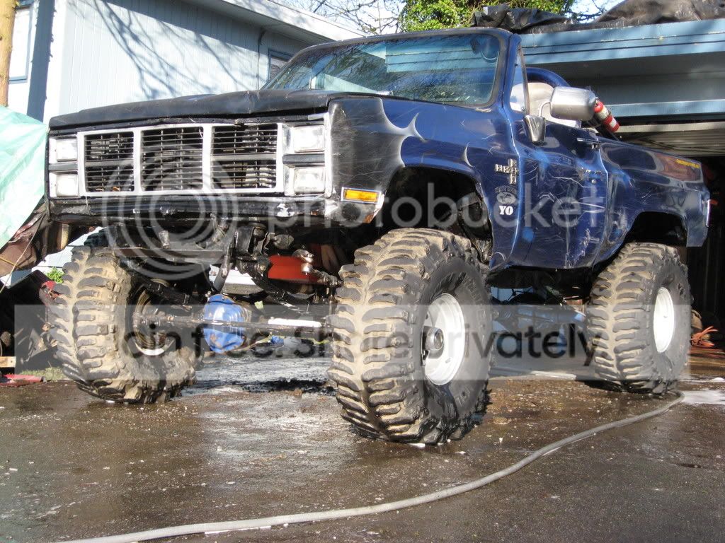

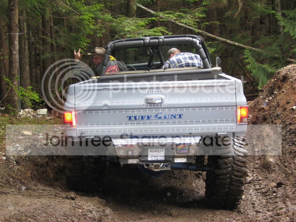

well this is what it looked like 5 yrs ago...
then after 4 yrs of hard wheelin she started too look a lil rough...

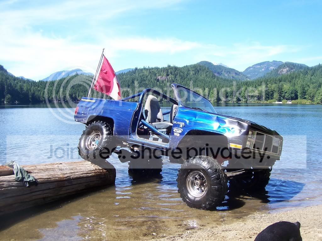

so it was time too rebuild. cleaned her up for one more trip before the surgery...
last pic...R.I.P.

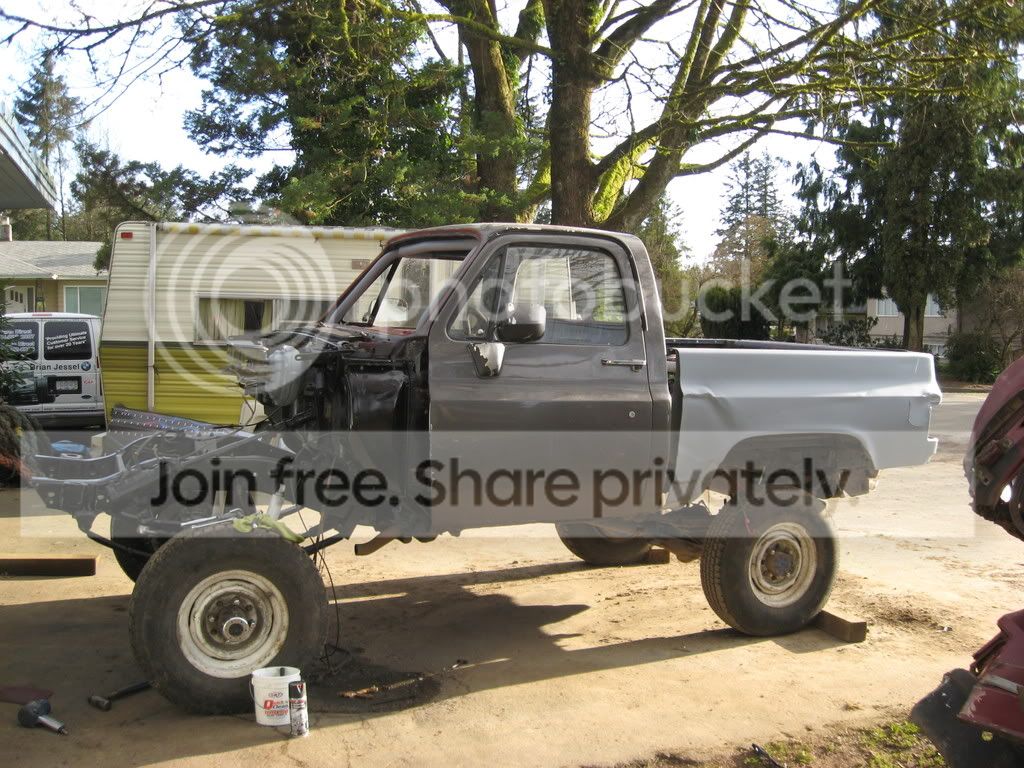

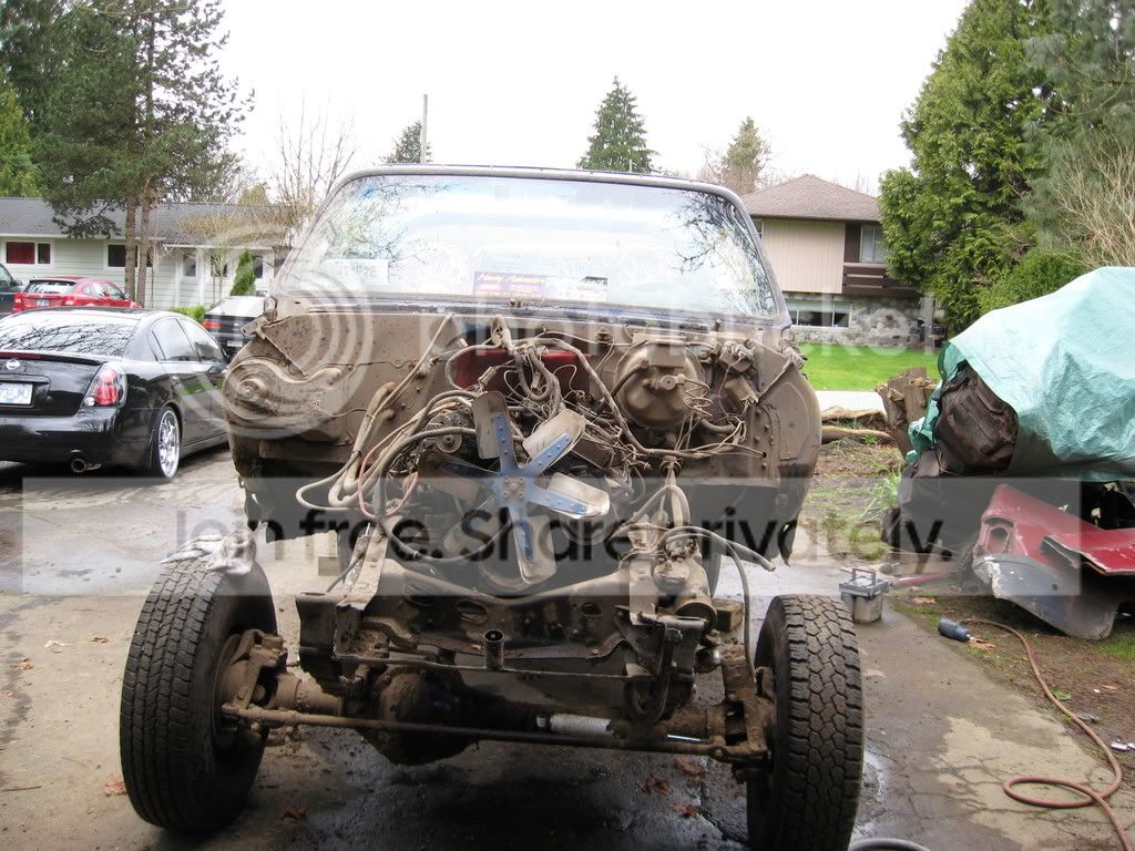

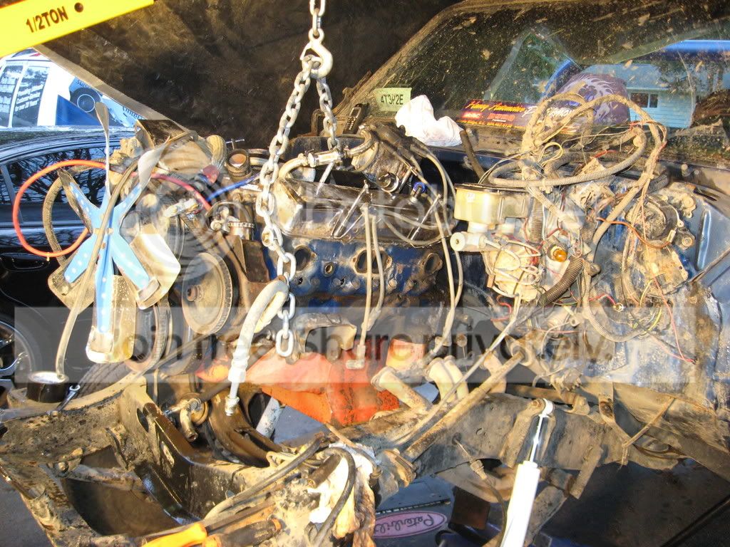

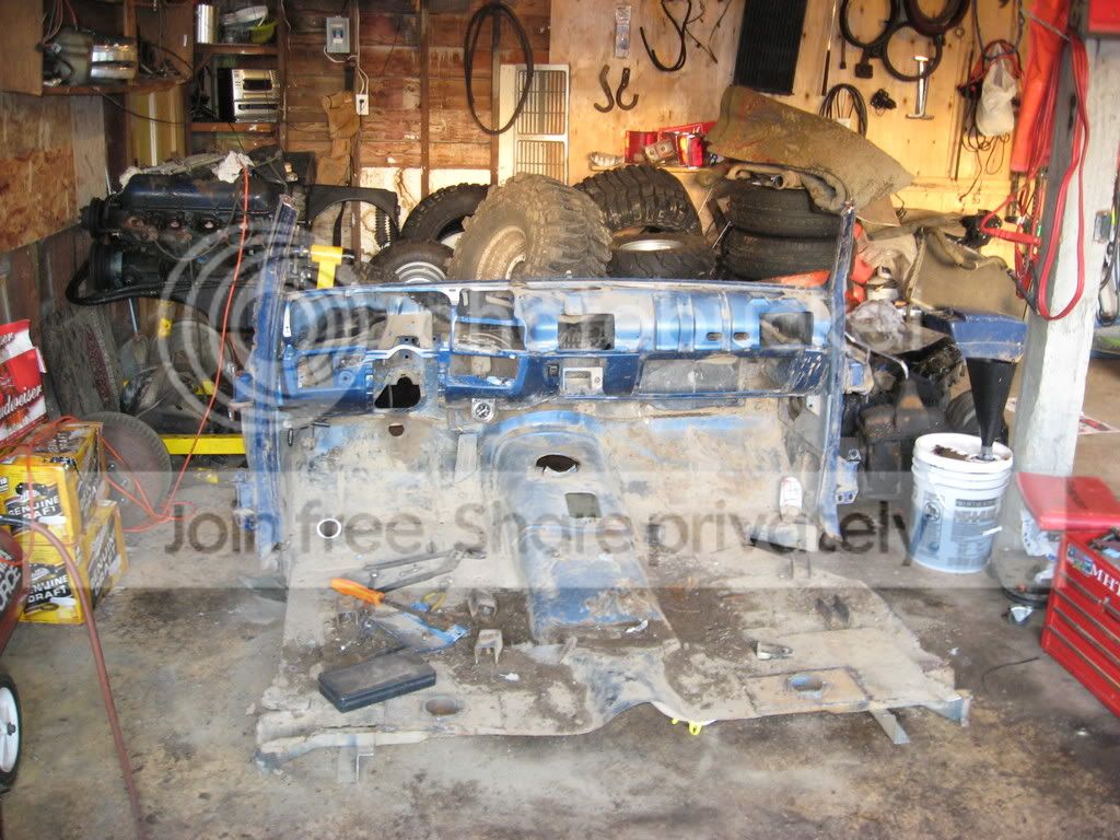

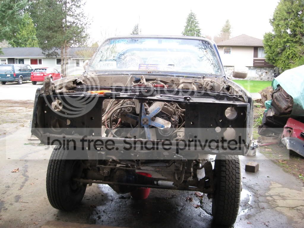

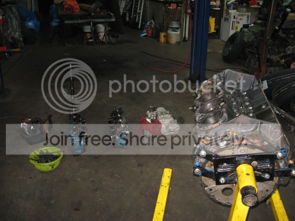

the teardown begins...
got lawn ornament?

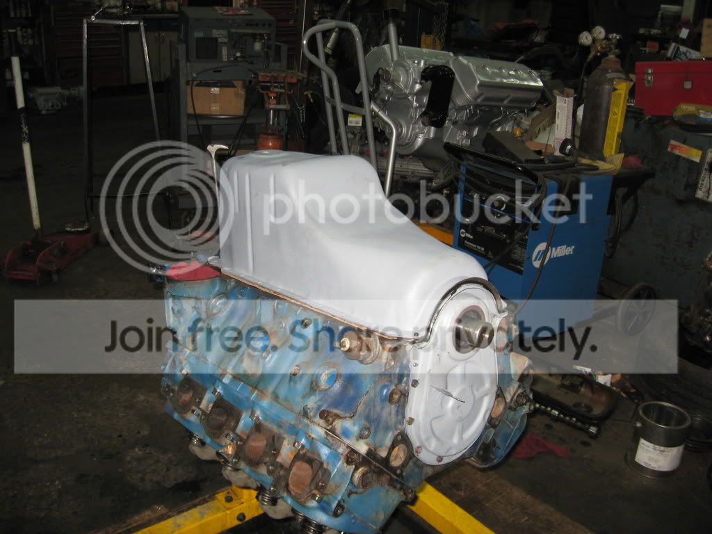

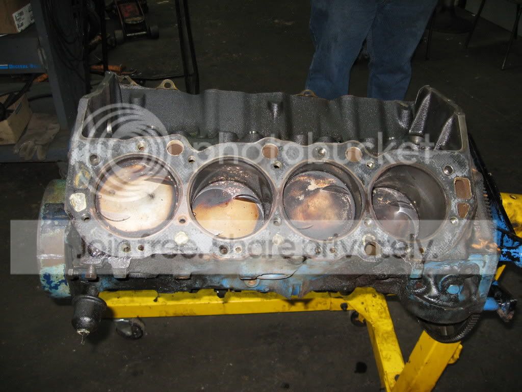

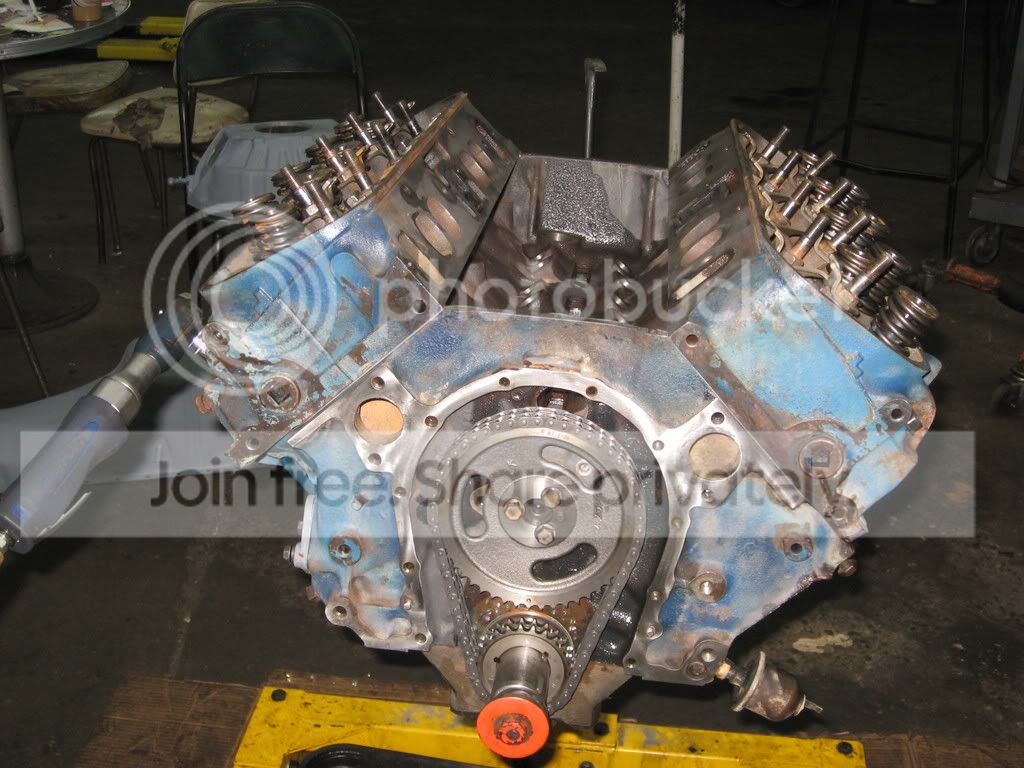

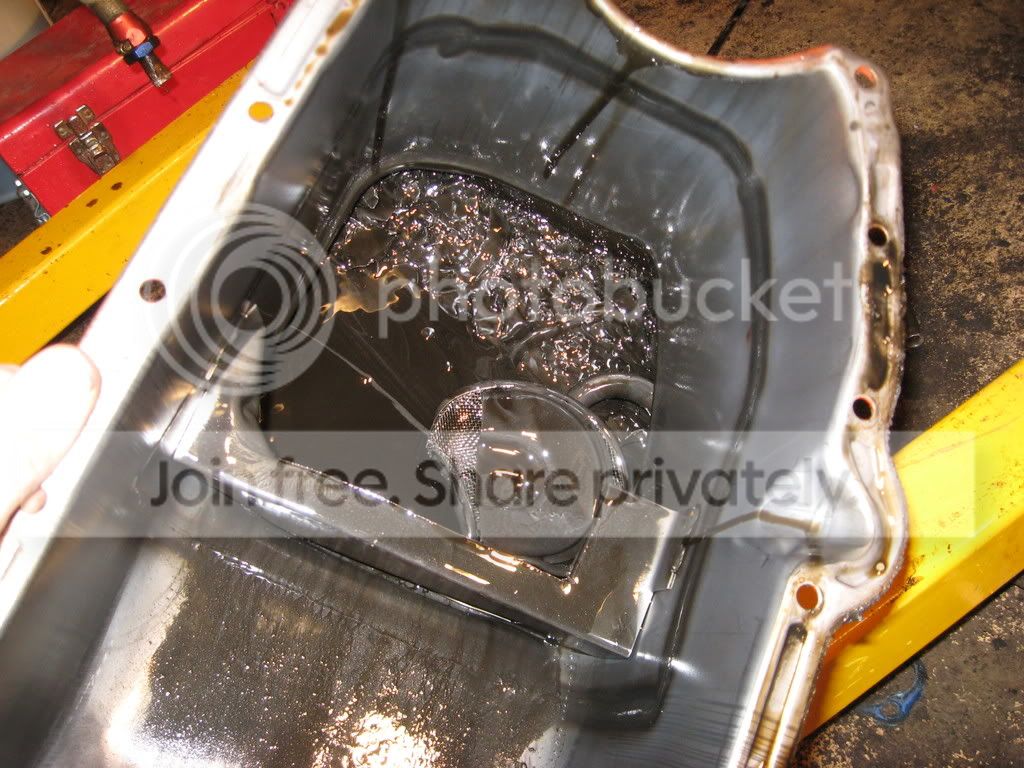

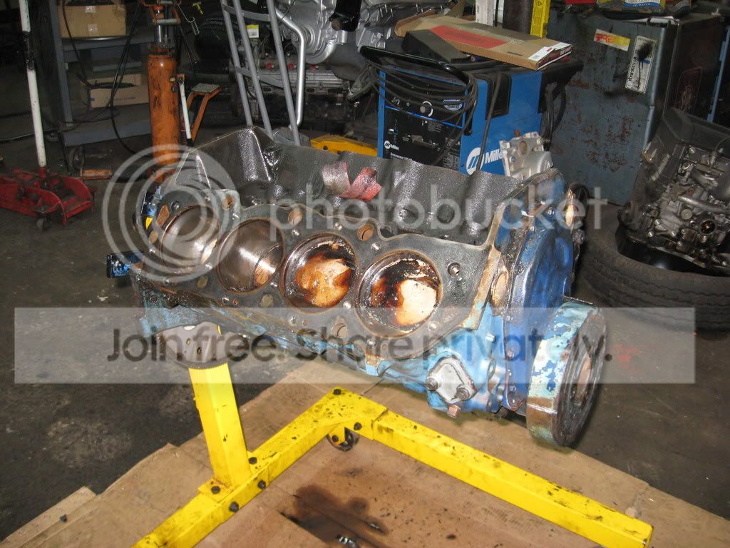

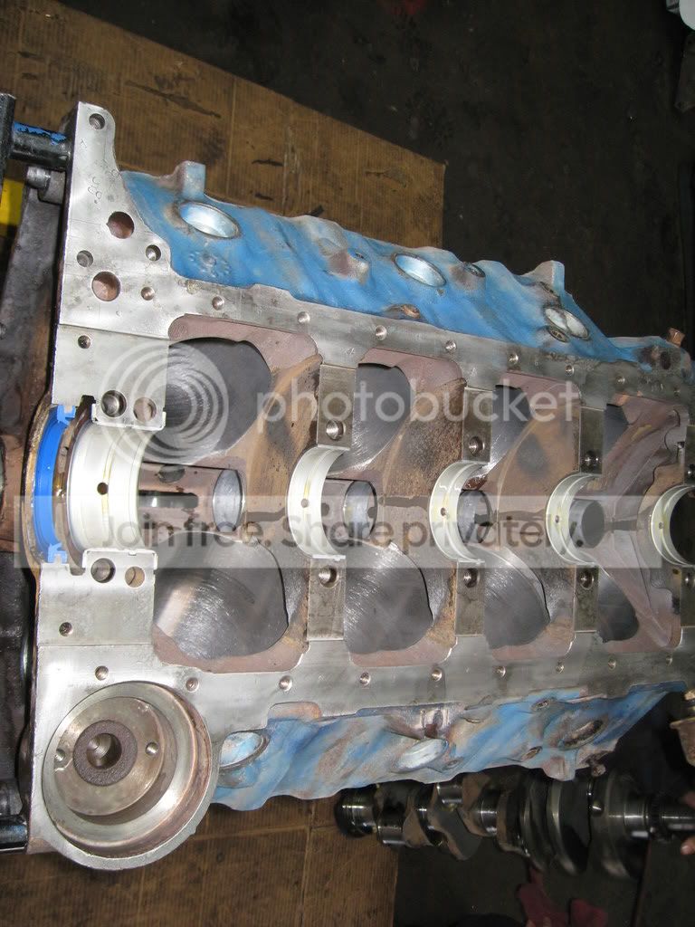

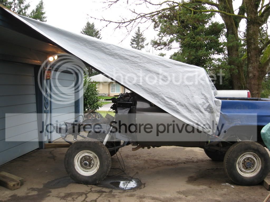

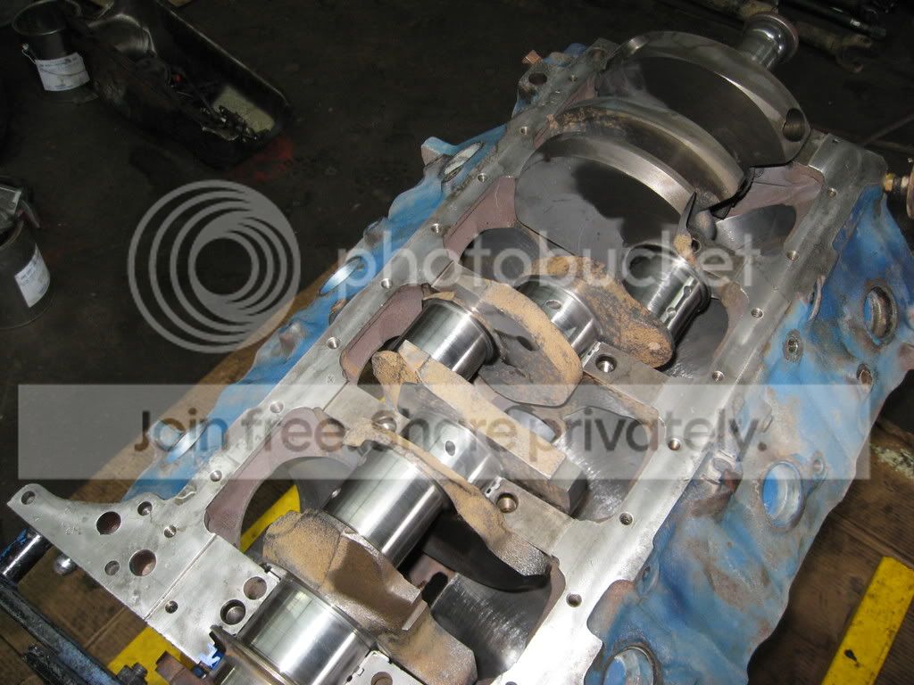

blew my motor on the last trip... almost like she knew it was time...

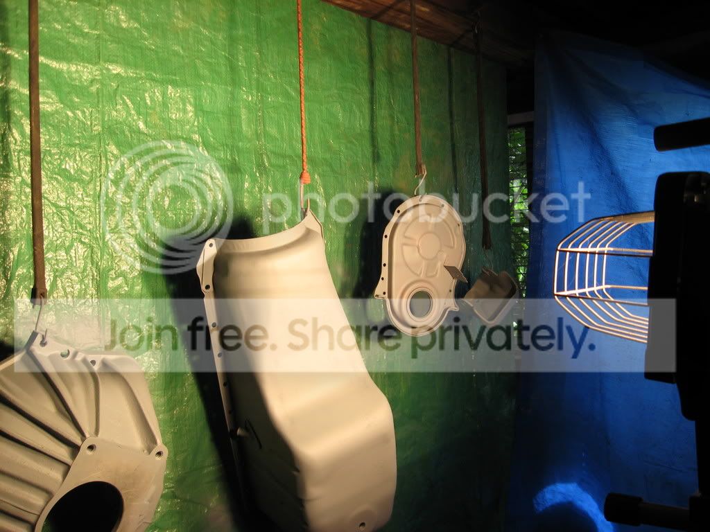

the oil pan..
rip 355...she was a great motor :bow:

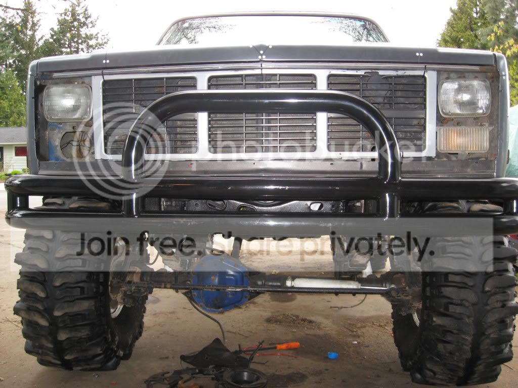

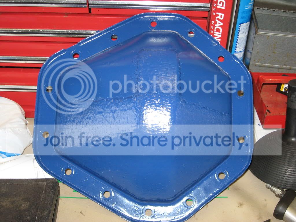

made a diff cover for the 14 bolt. simple yet effective...

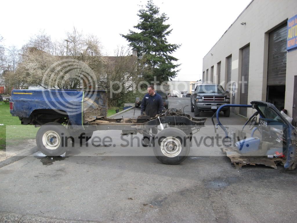

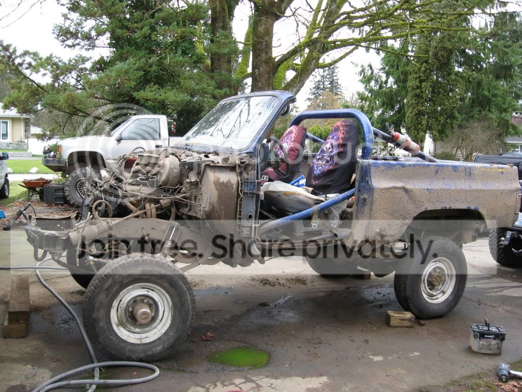

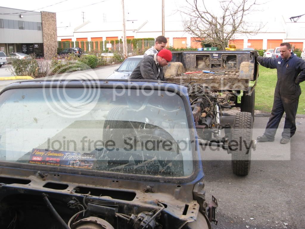

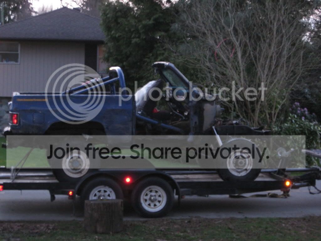

and on the trailer off too my buddies shop ....

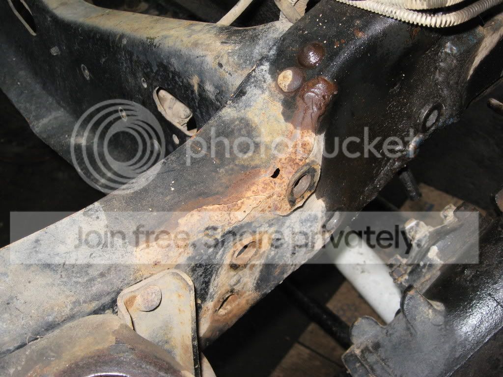

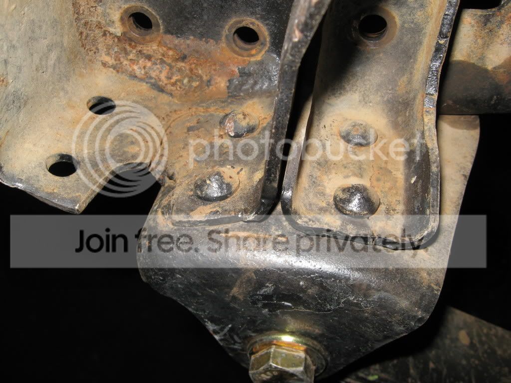

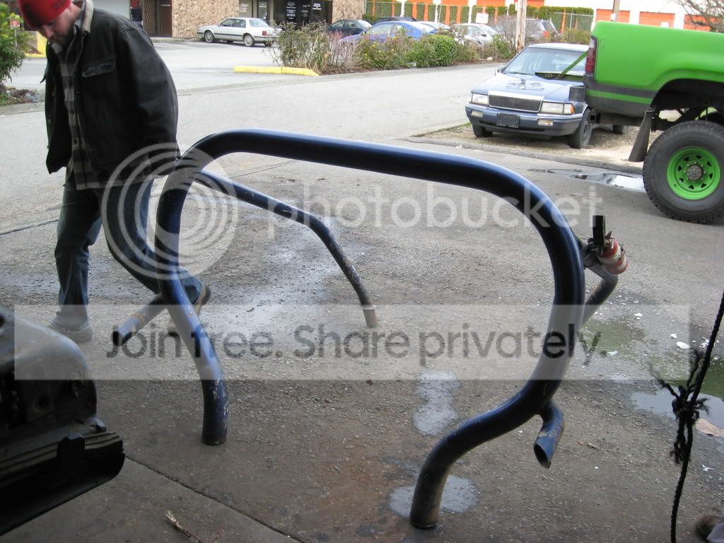

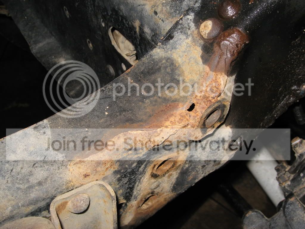

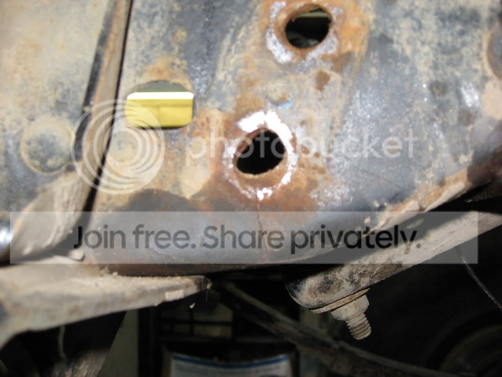

some pics of the broken and bent stuff...
look how twisted that is...( was..:D)

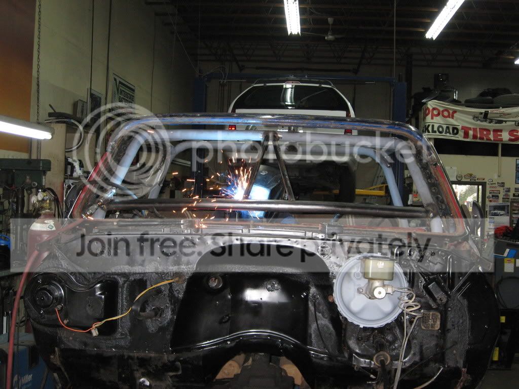

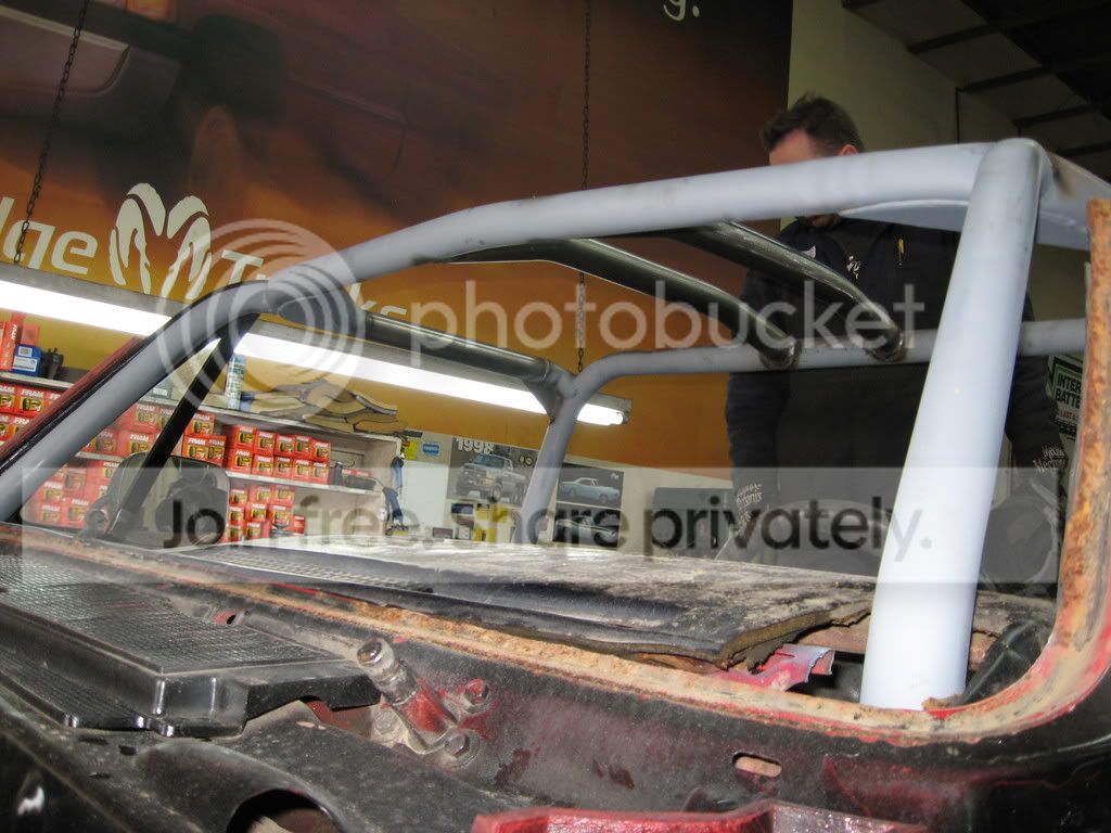

cuttin my old cage out...
and out..

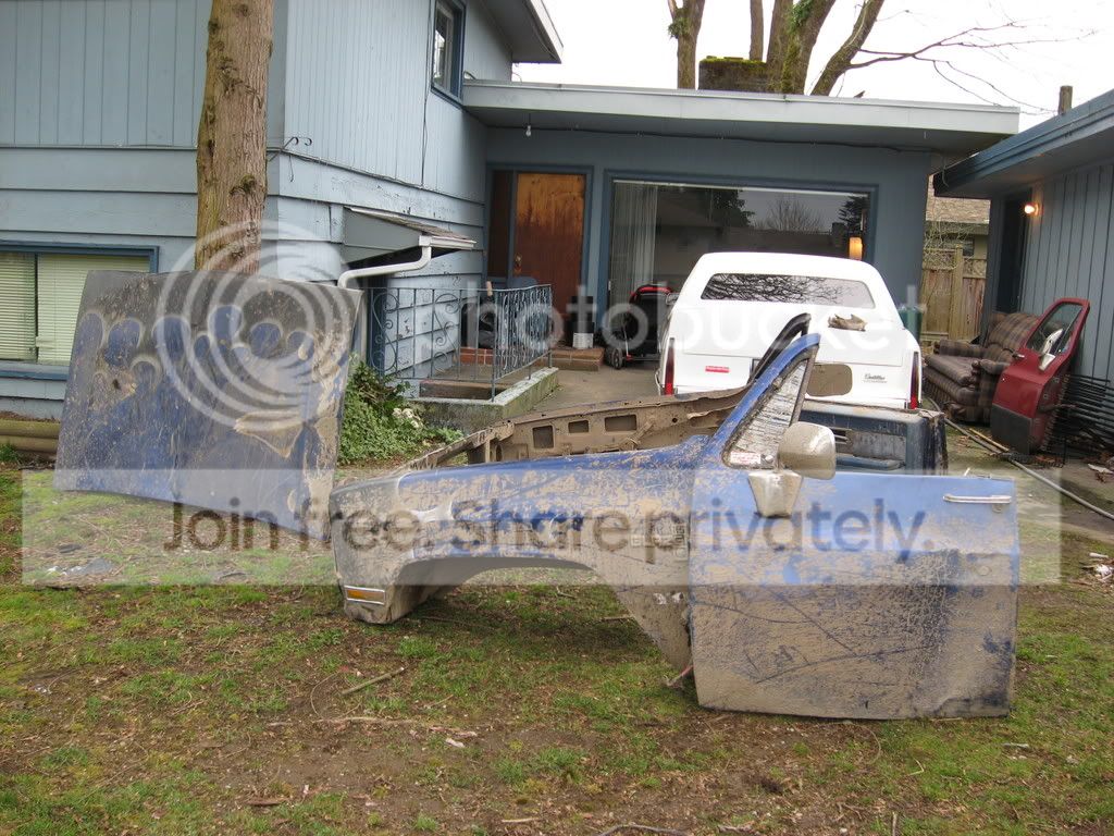

and the cutting starts...the body was absolutly done. i know the theme and plan for the truck now ( more on that in a bit). so it was time too cut the bad and save the good..

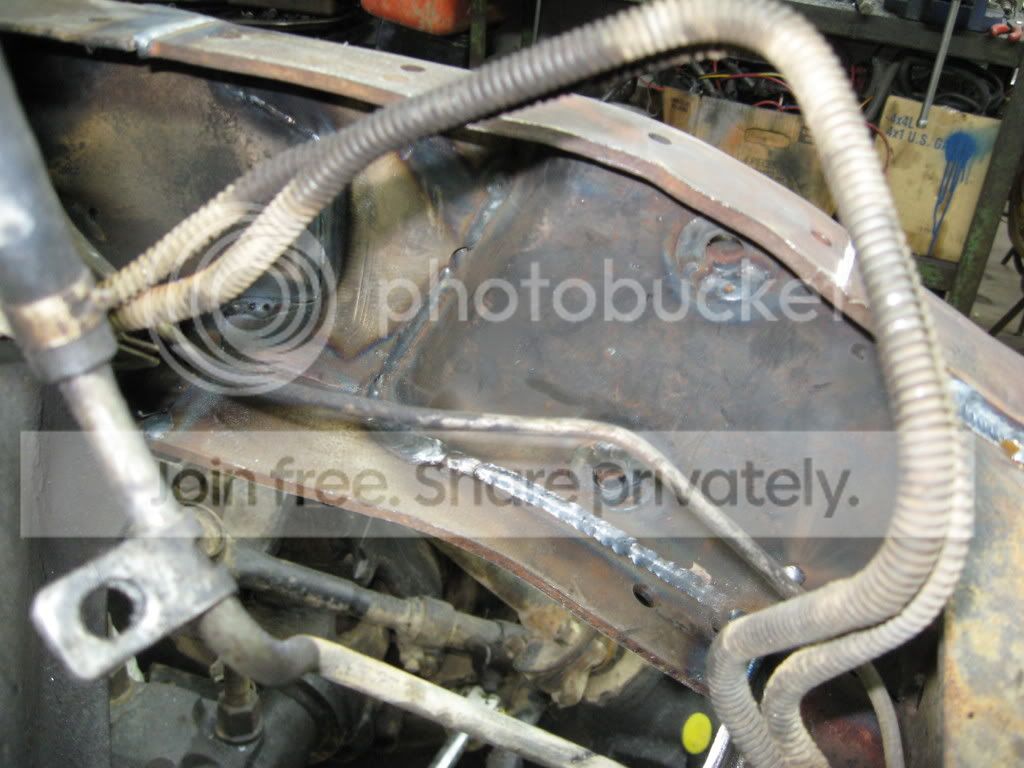

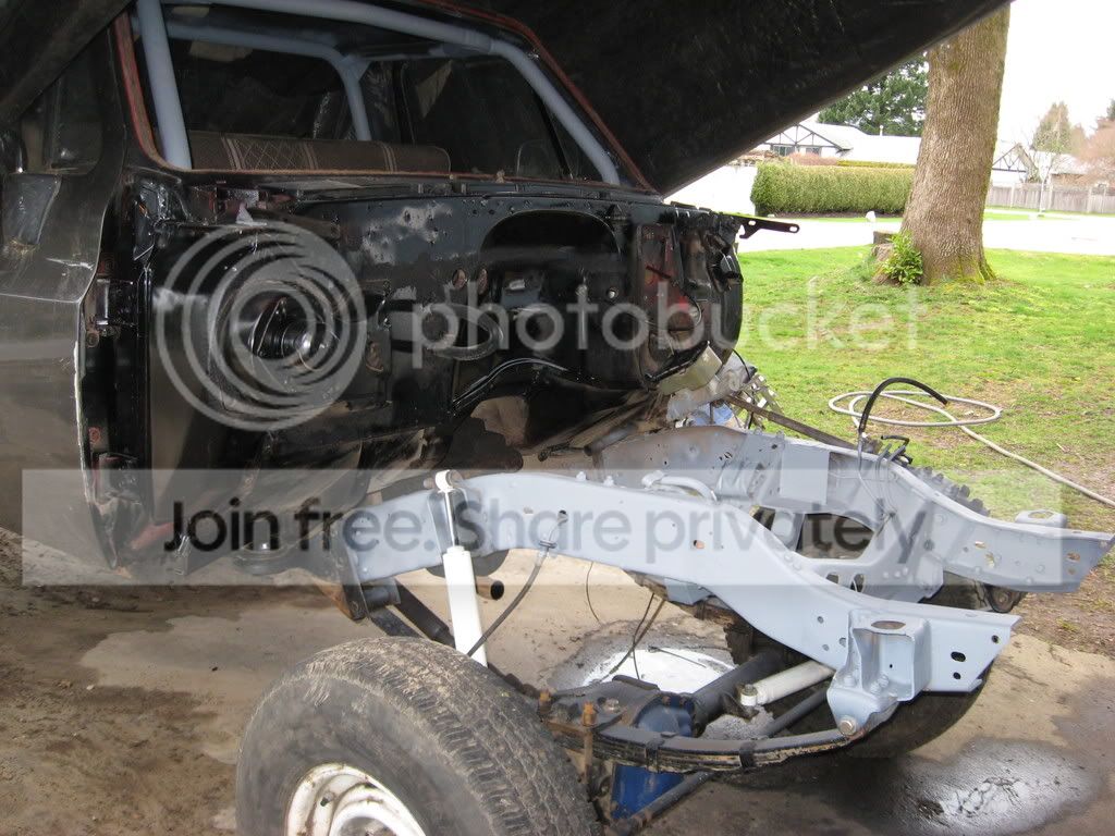

starting on the reparing process.. i used one tone frame pieces..

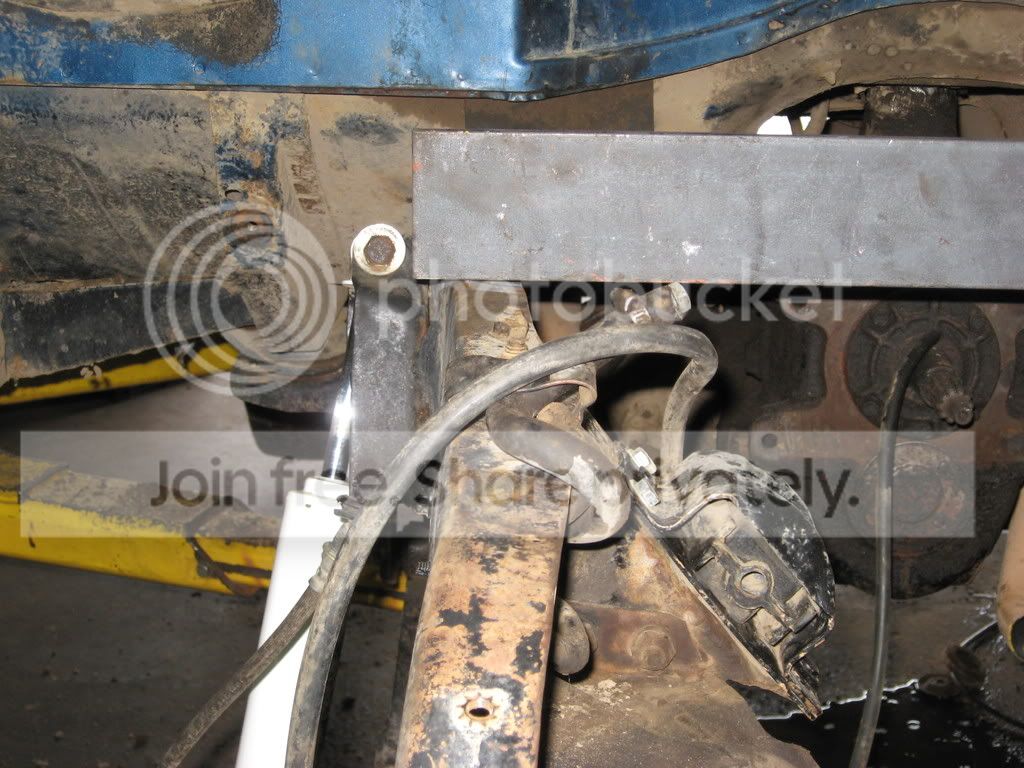

boxed and sleeved steering box..

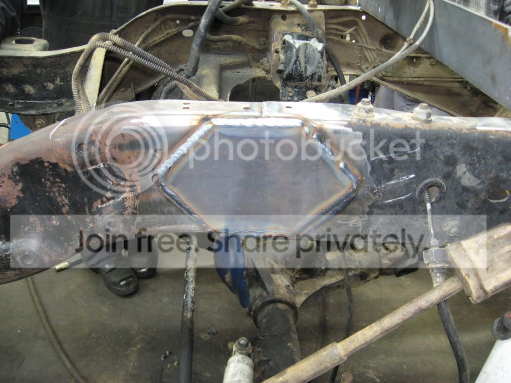

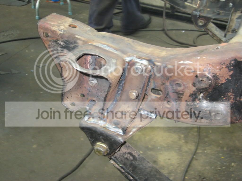

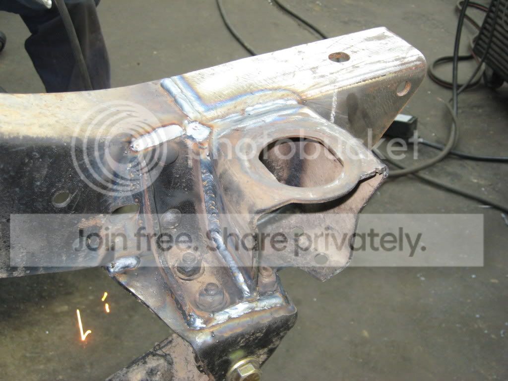

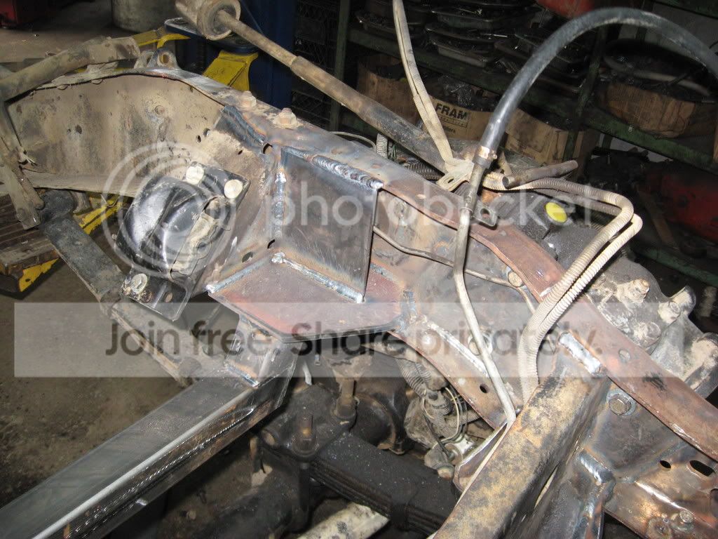

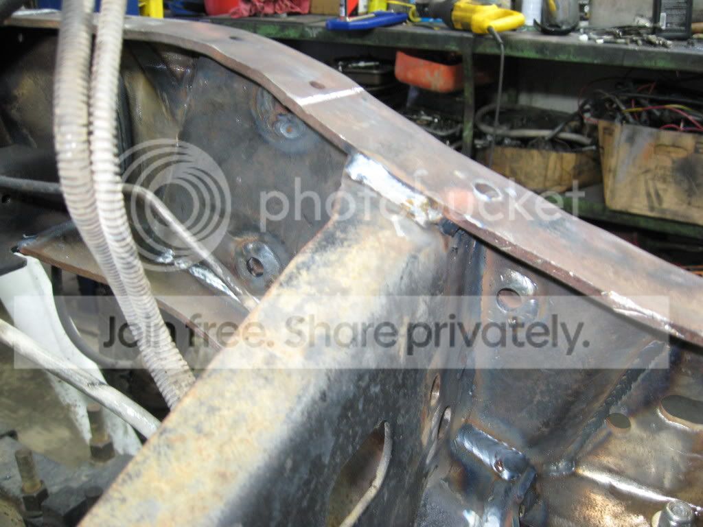

new pass side frame horn, welded everythign solid..

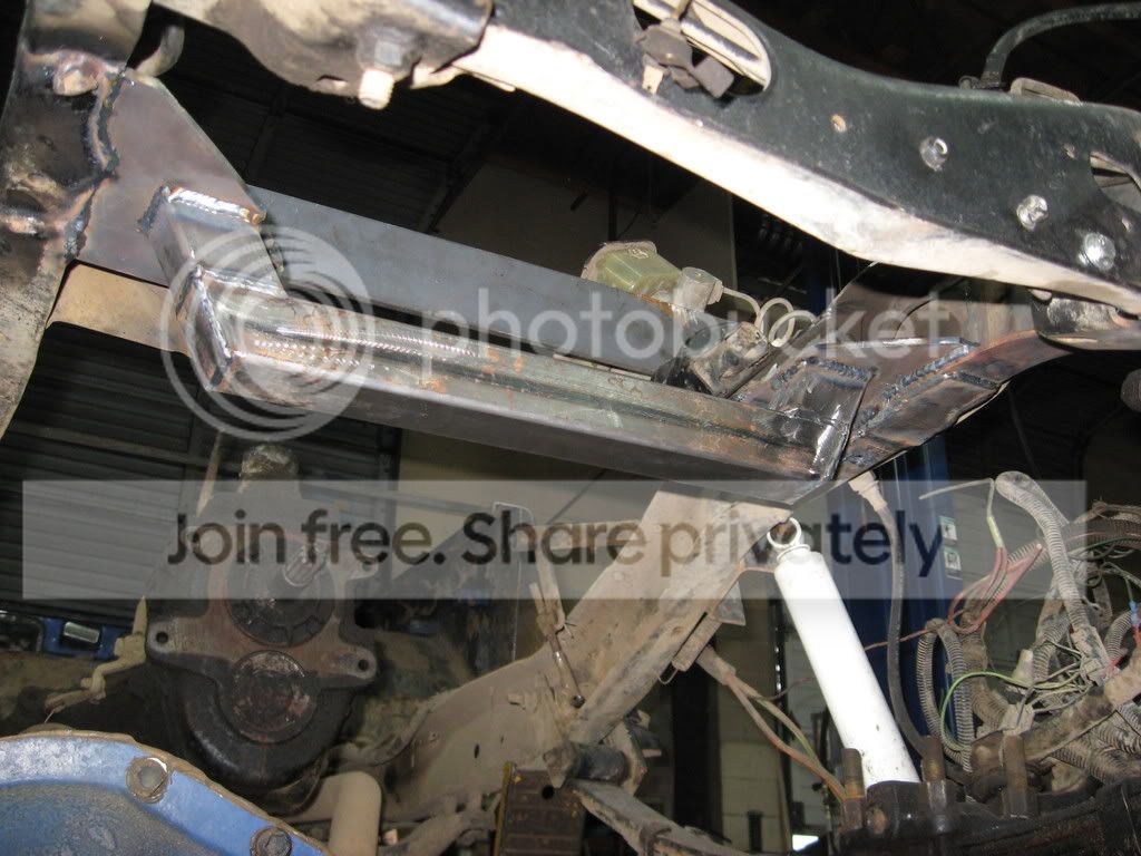

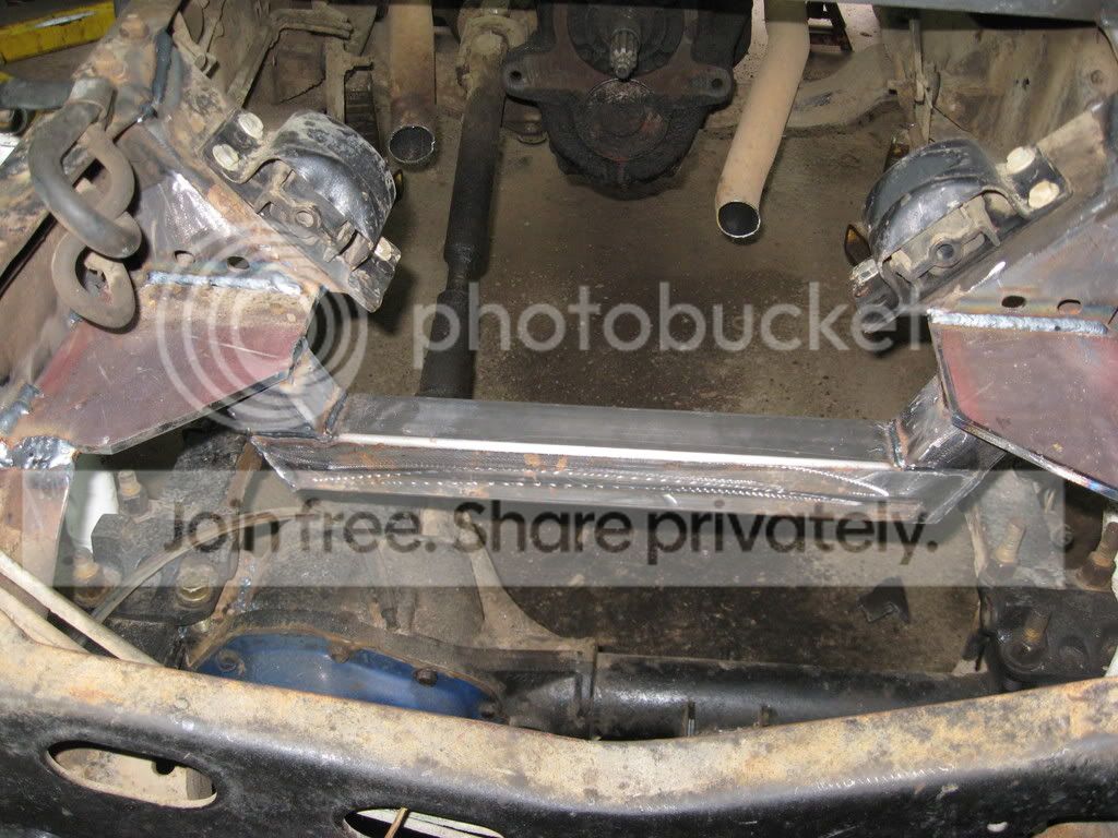

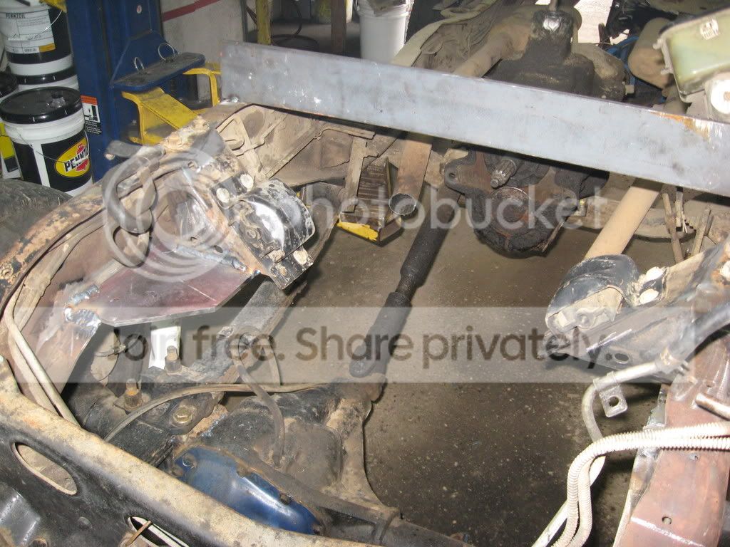

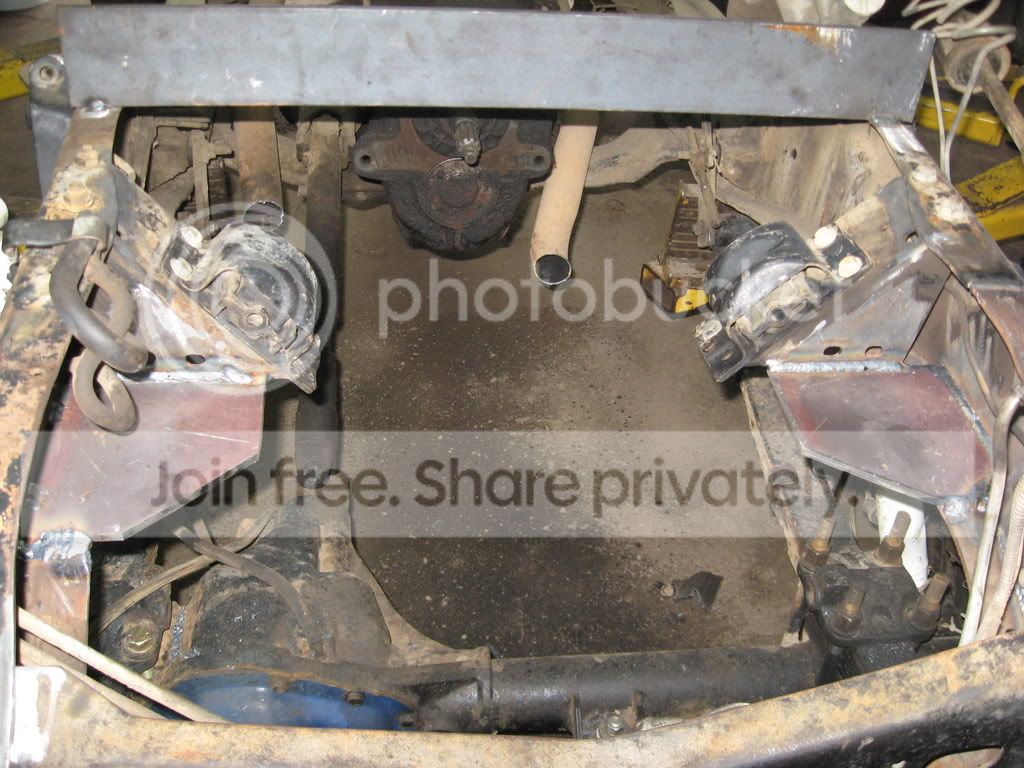

cut out the stock crossmember and added my own..
crossmember is welded in..
boxed the one side..couldnt the other side due too the fuel pump..
put some tube in too tie the box together...

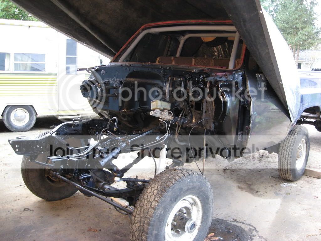

the new cab..
rollin in the frame..
and marriage..
wierd..

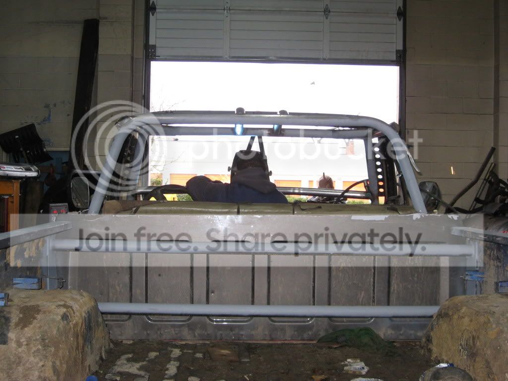

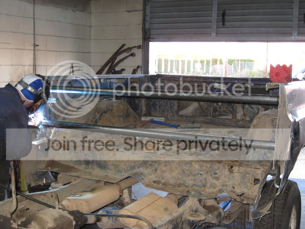

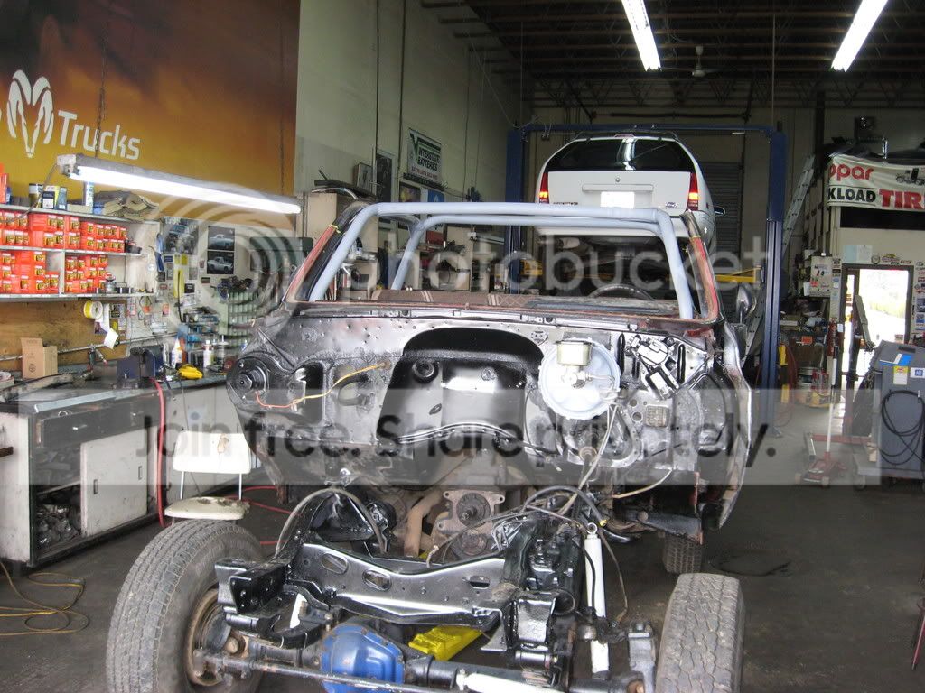

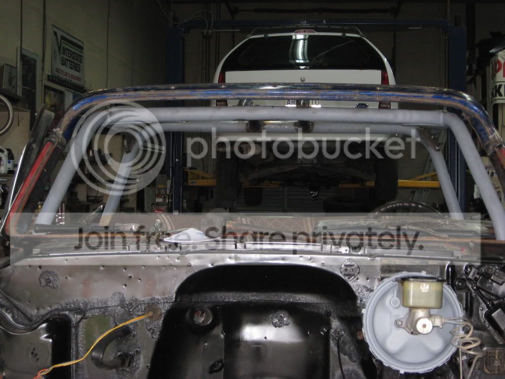

starting on the cage..

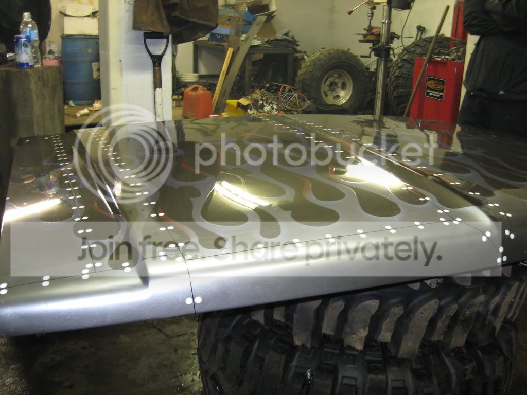

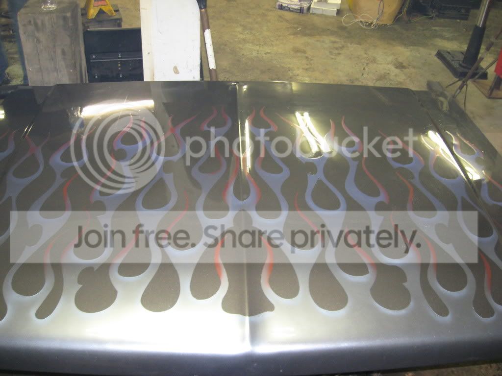

here is my hood before the fighter plane them is applied..

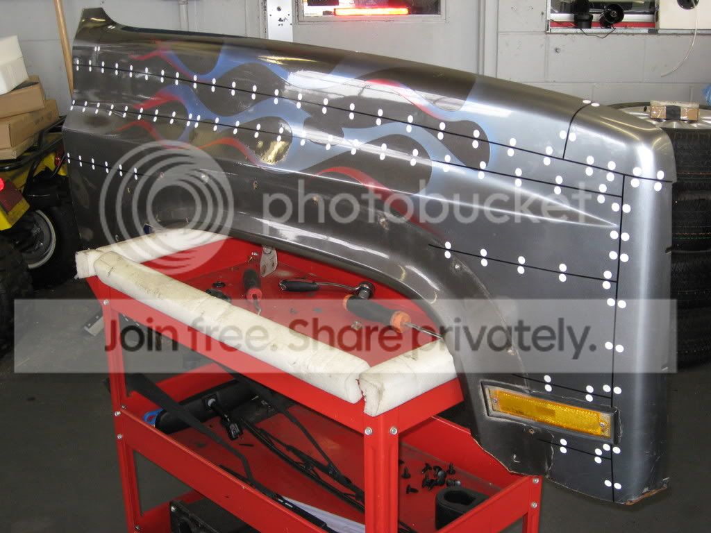

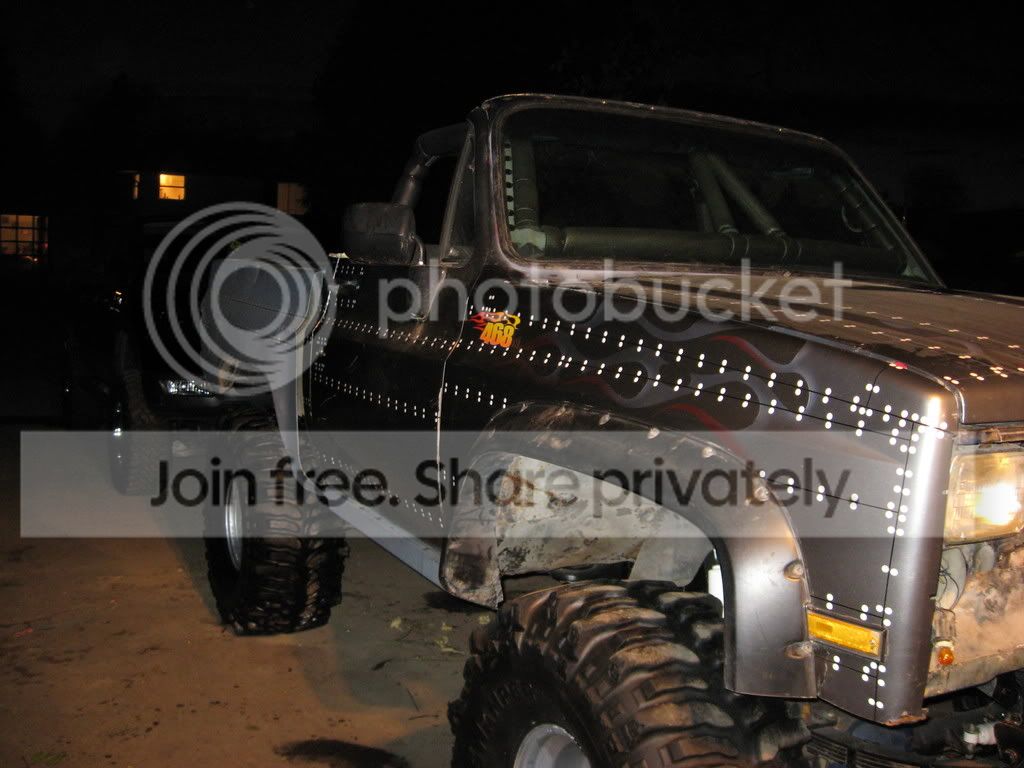

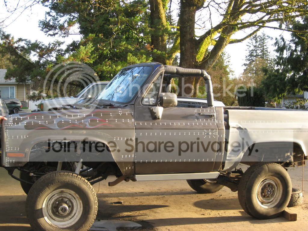

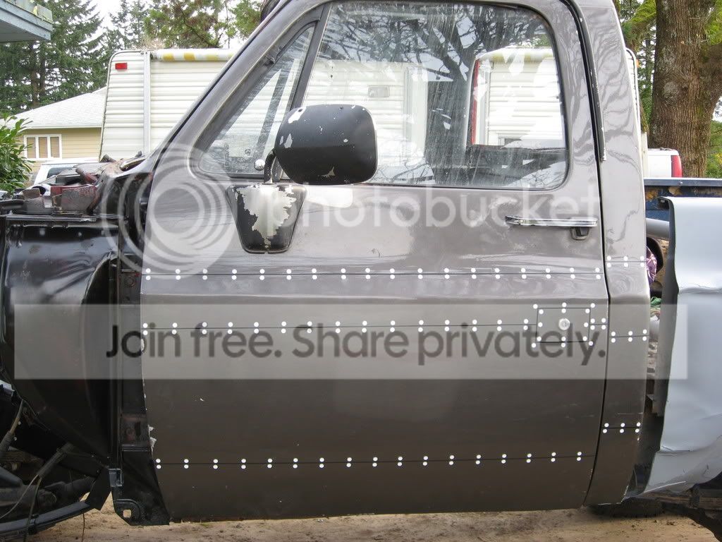

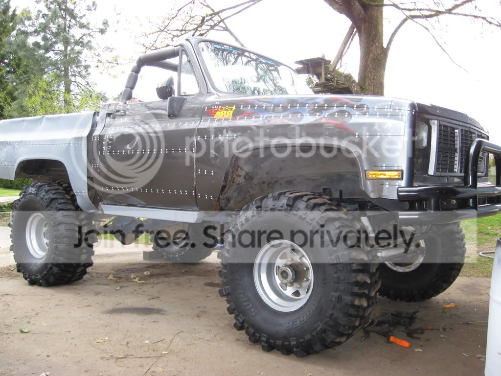

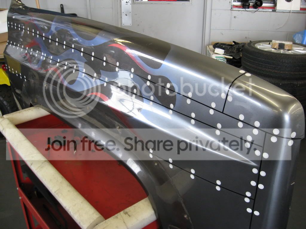

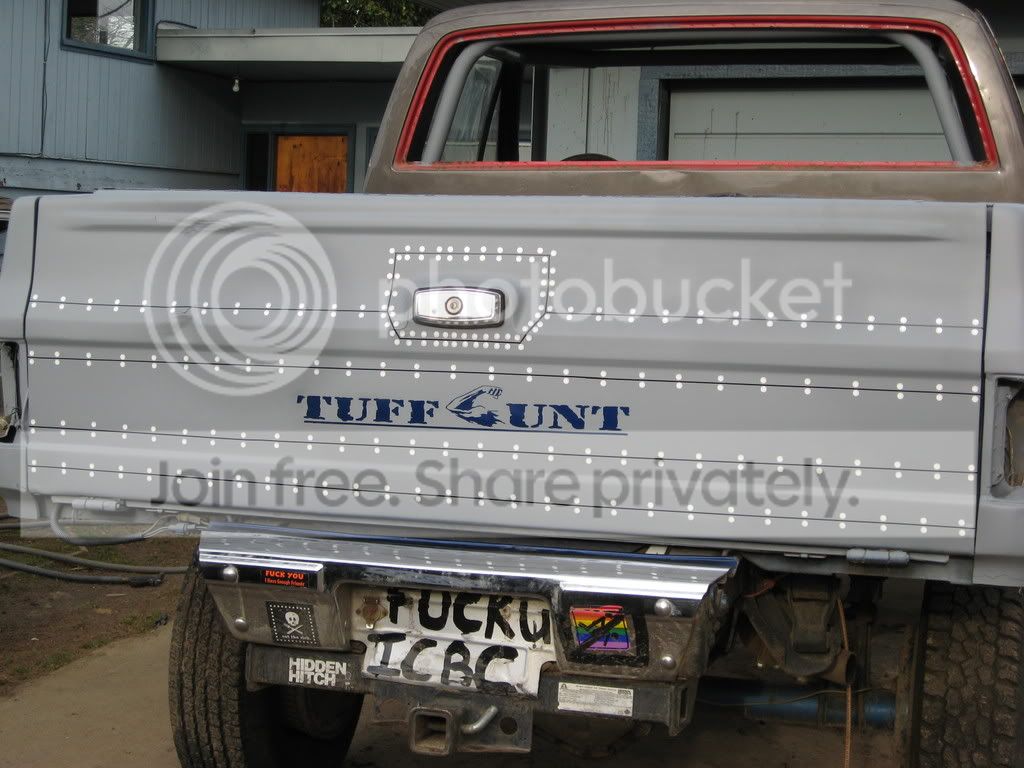

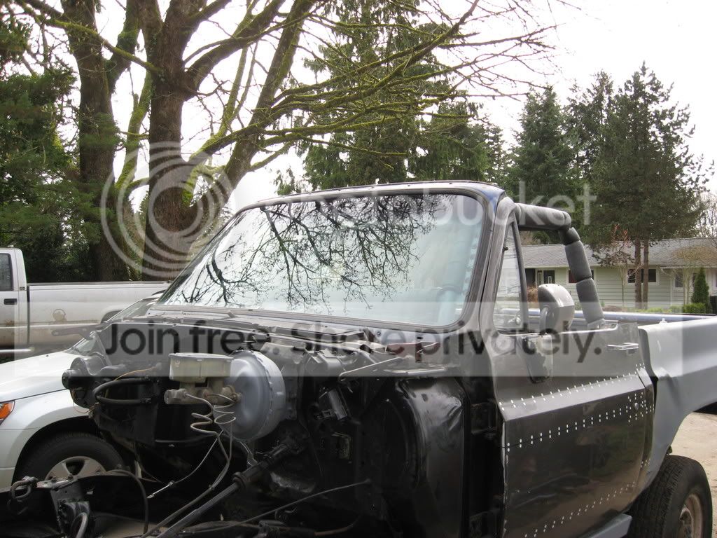

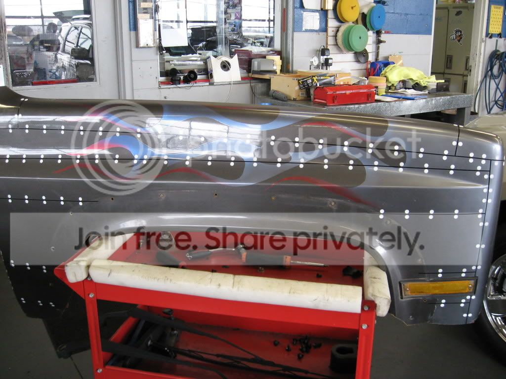

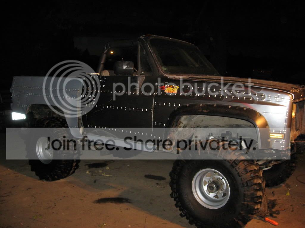

i went and got some custom decals made up." rivets" i wanted too start the look by giving my truck the riveted panel look. ya cant tell in the pics but they r actually shadowed and in person look like real rivets..
fenders..

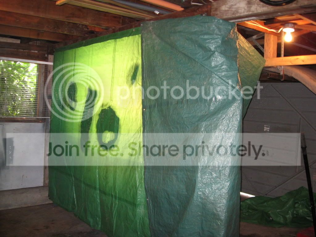

truck is brought back too my place for sanding, priming and painting..
my redneck garage..:haha:

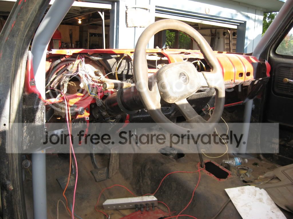

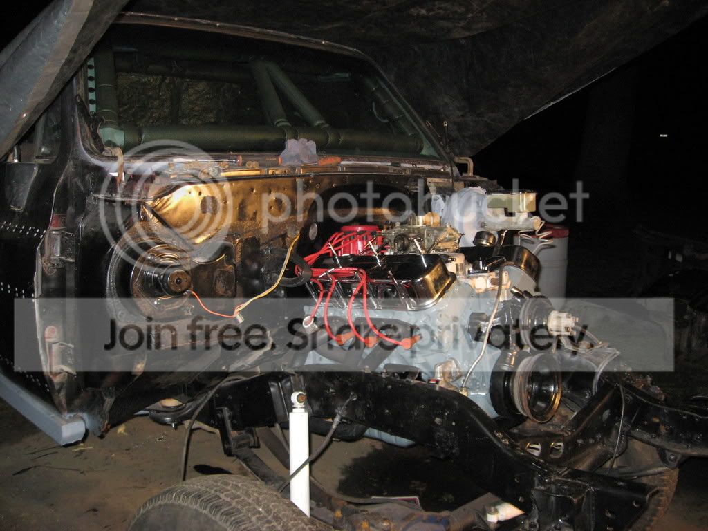

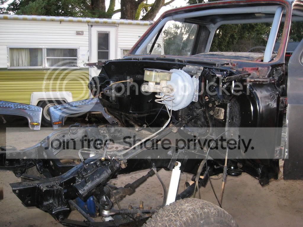

the wiring begins..

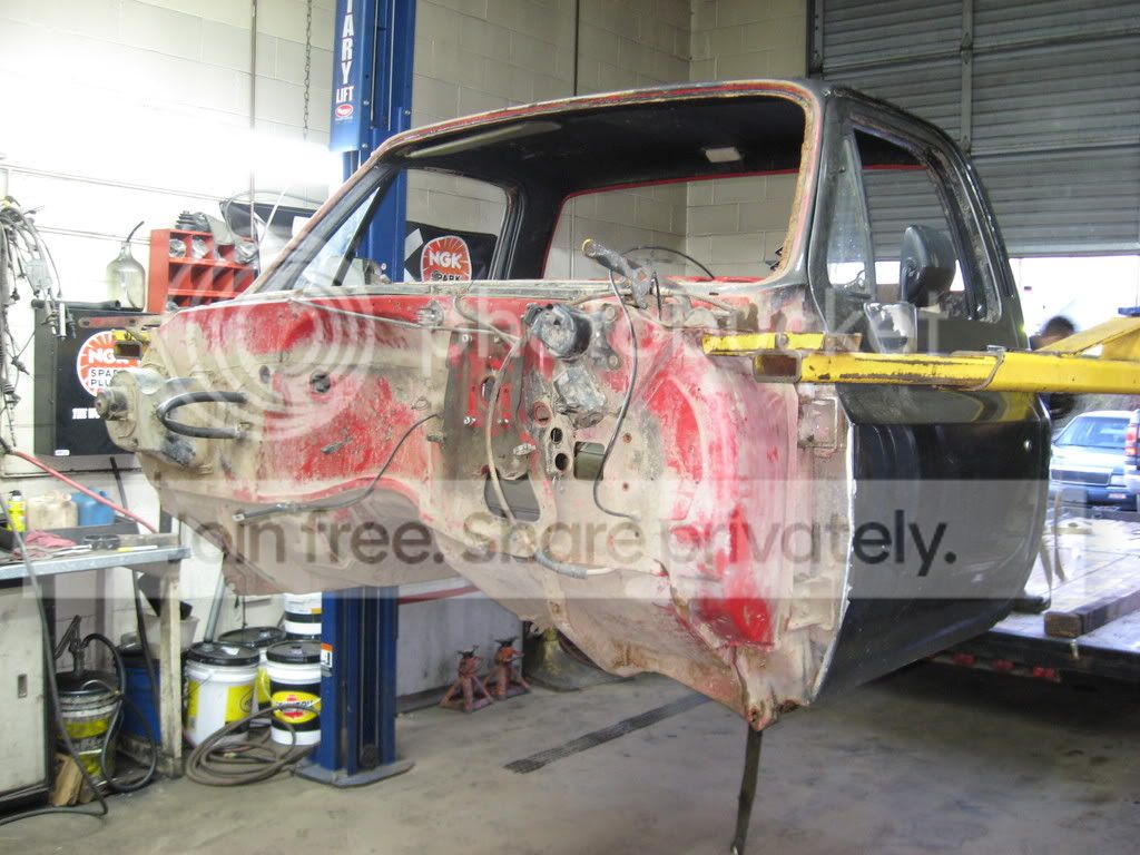

whats left of the poor body..

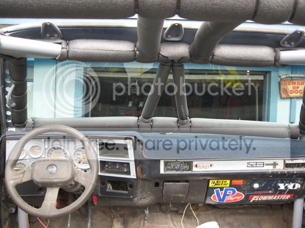

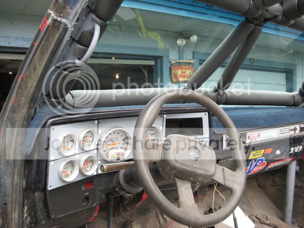

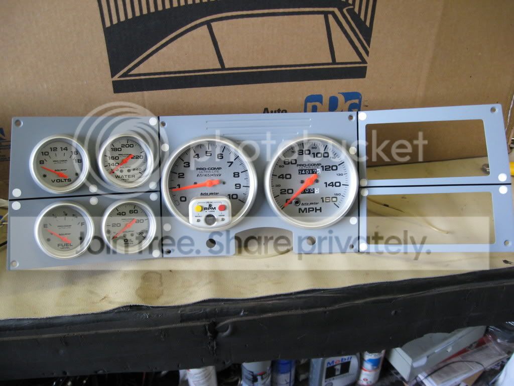

added the rivet look too my gauge bezel..

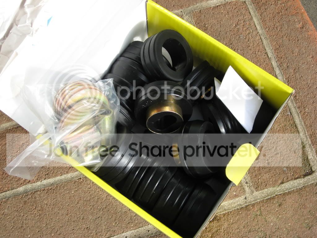

urethane body mounts.. i highly suggest these..

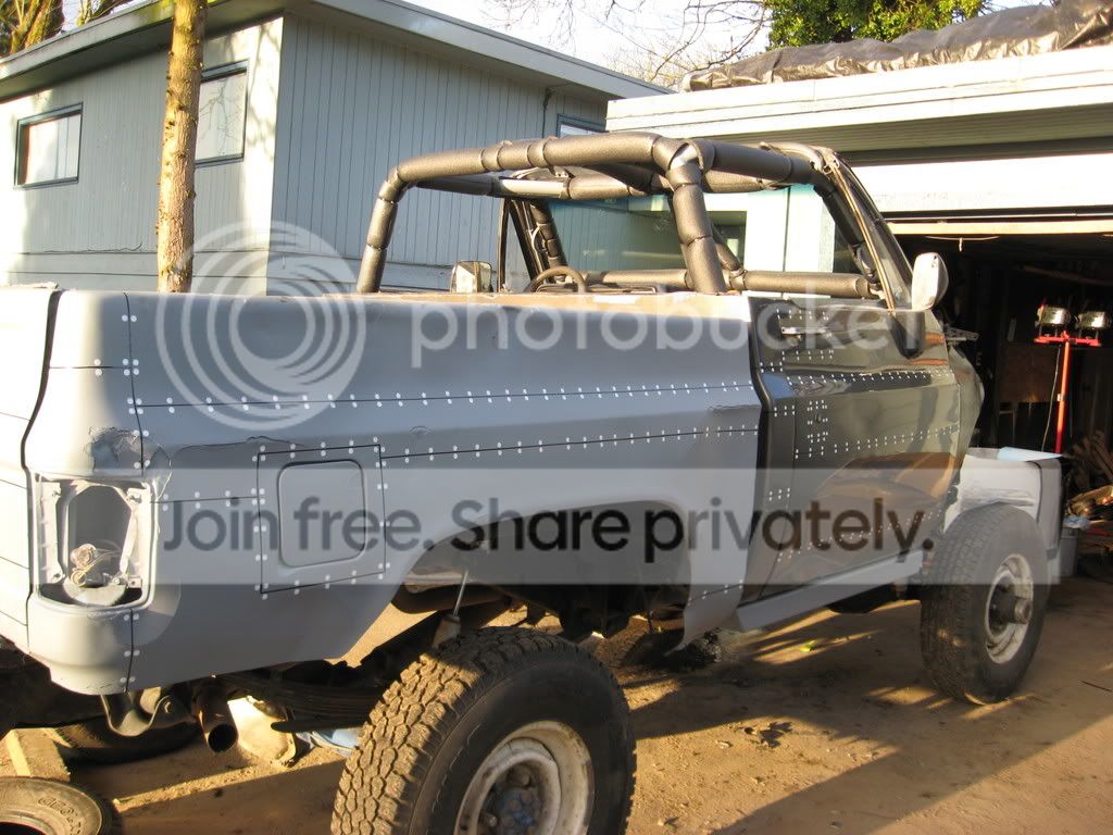

added rivets too the cab..

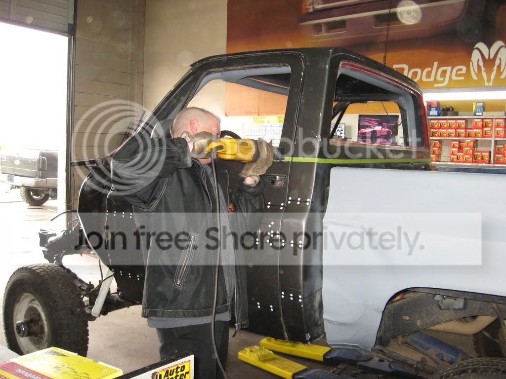

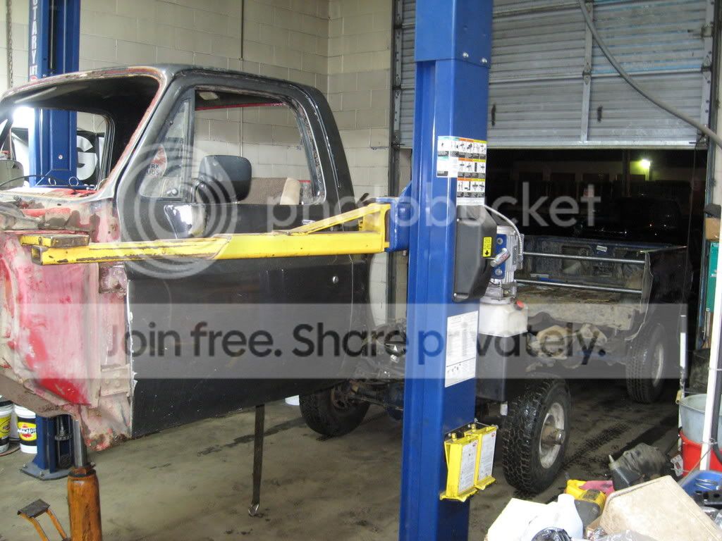

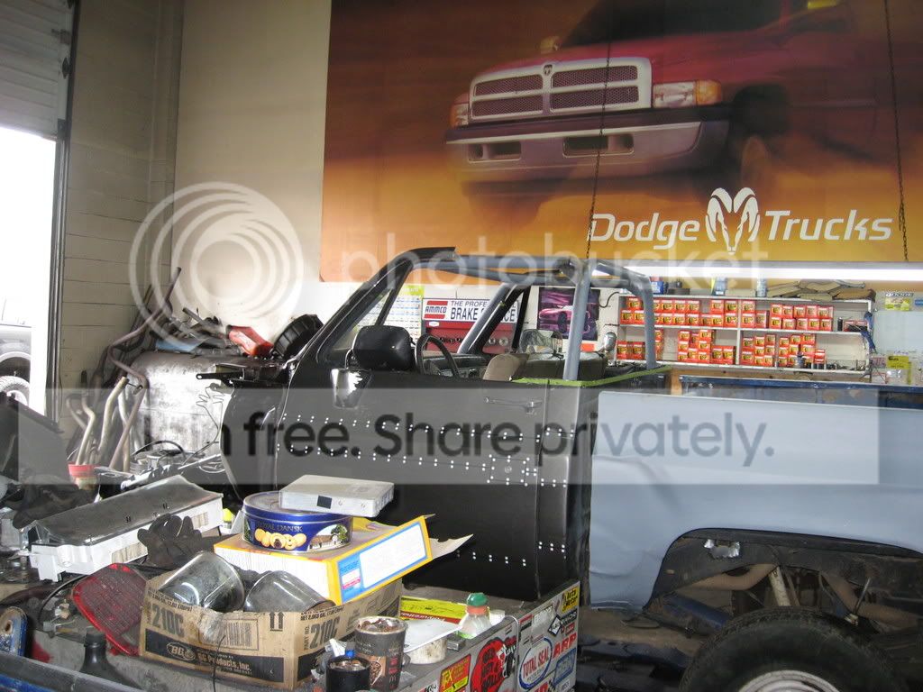

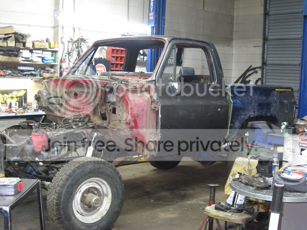

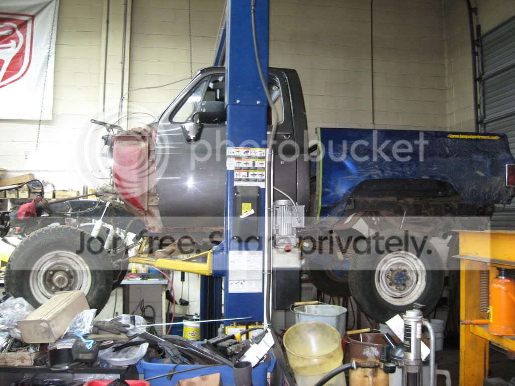

back too my buddies shop for more chop cut rebuild..:D

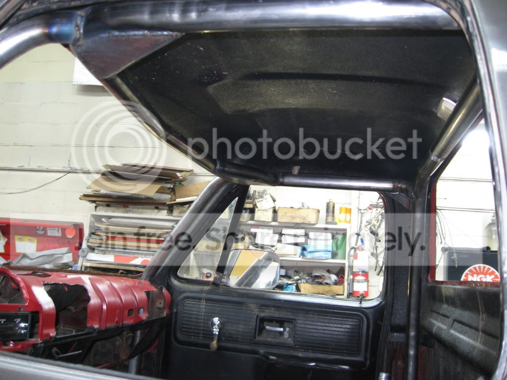

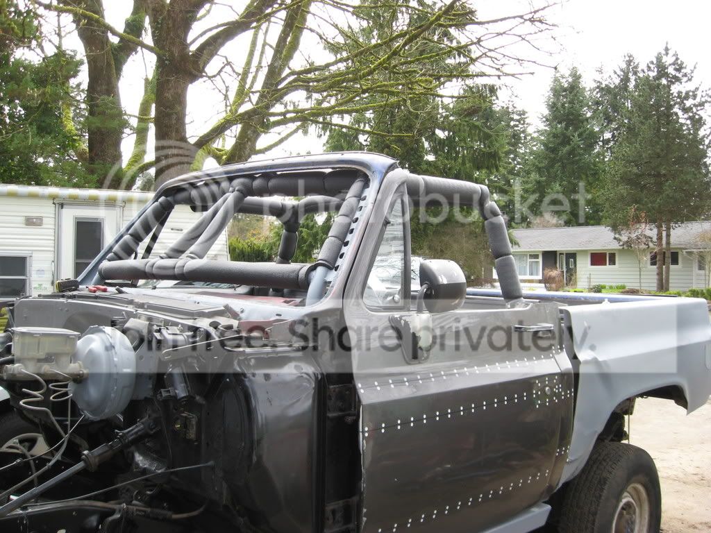

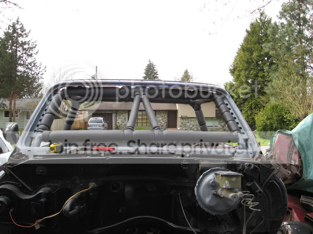

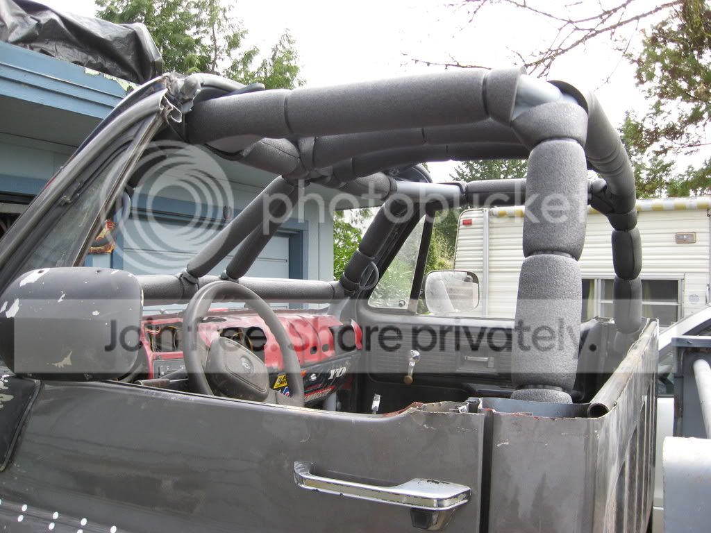

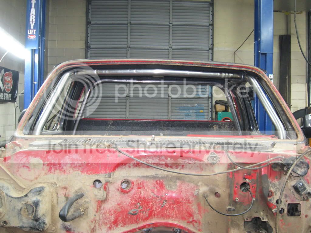

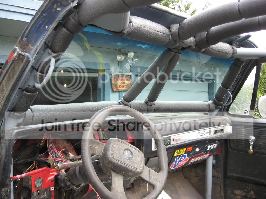

added some top bars..
added the w's frame from thre blue one..

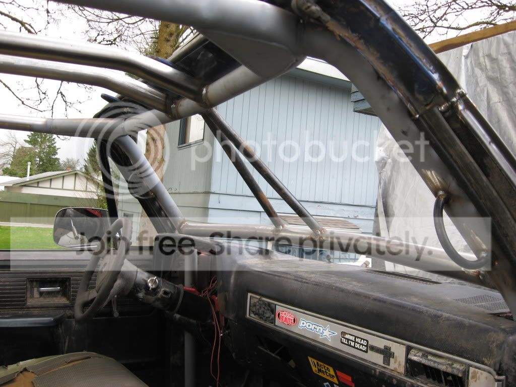

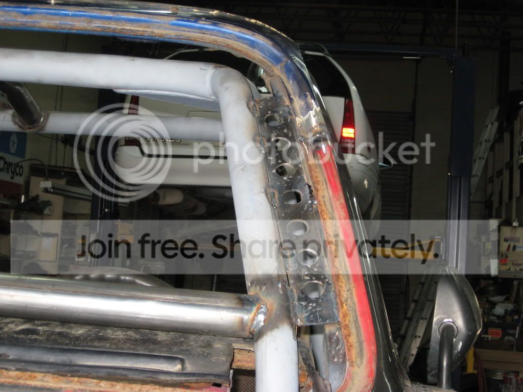

keeping with the fighter pplane theme added some speed holes too the cage a pillar plate. this will give the w/s frame some strength..

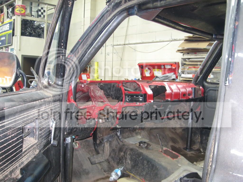

added the down bars for a cockpit look..

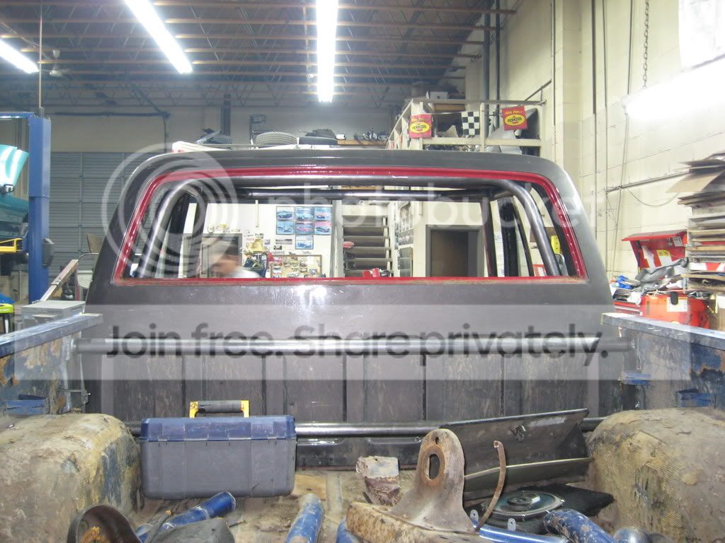

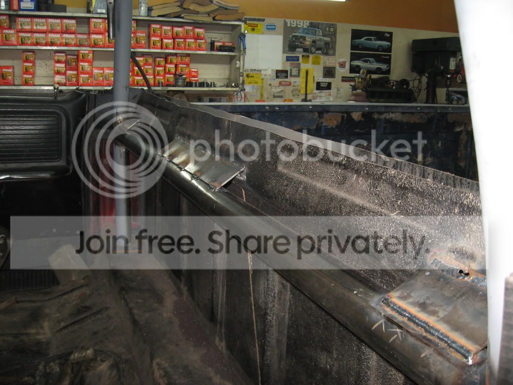

behind the seat.. giving the rear bulkhead some strength..

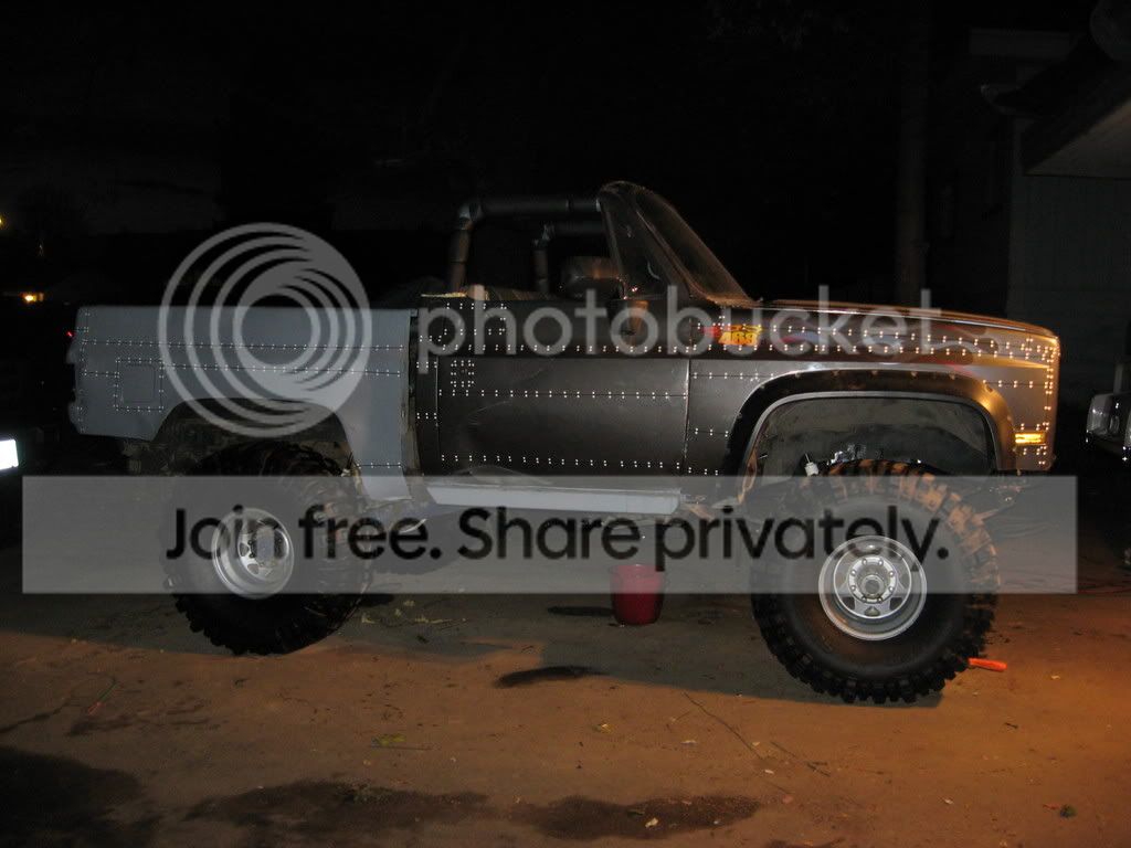

progress pic.. this was a 32 day budget build . i could not have done it without the help of my friends...thanks guys...:bow::bow::bow::bow:

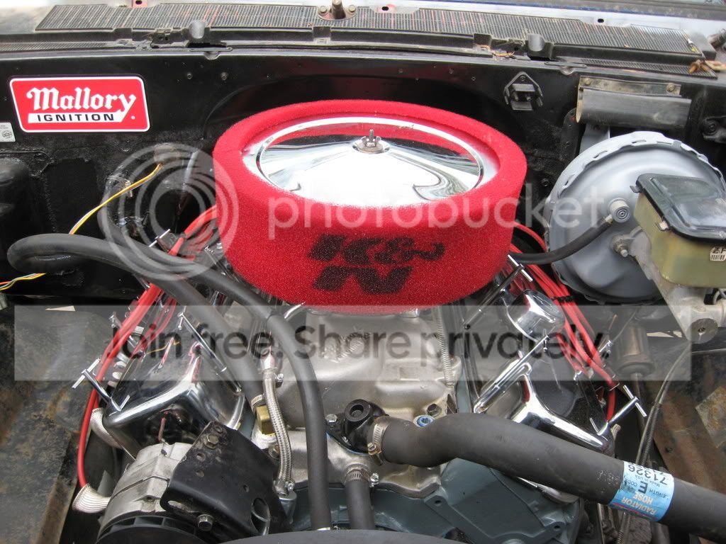

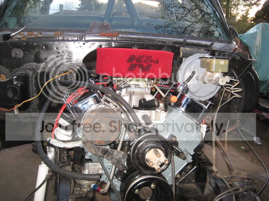

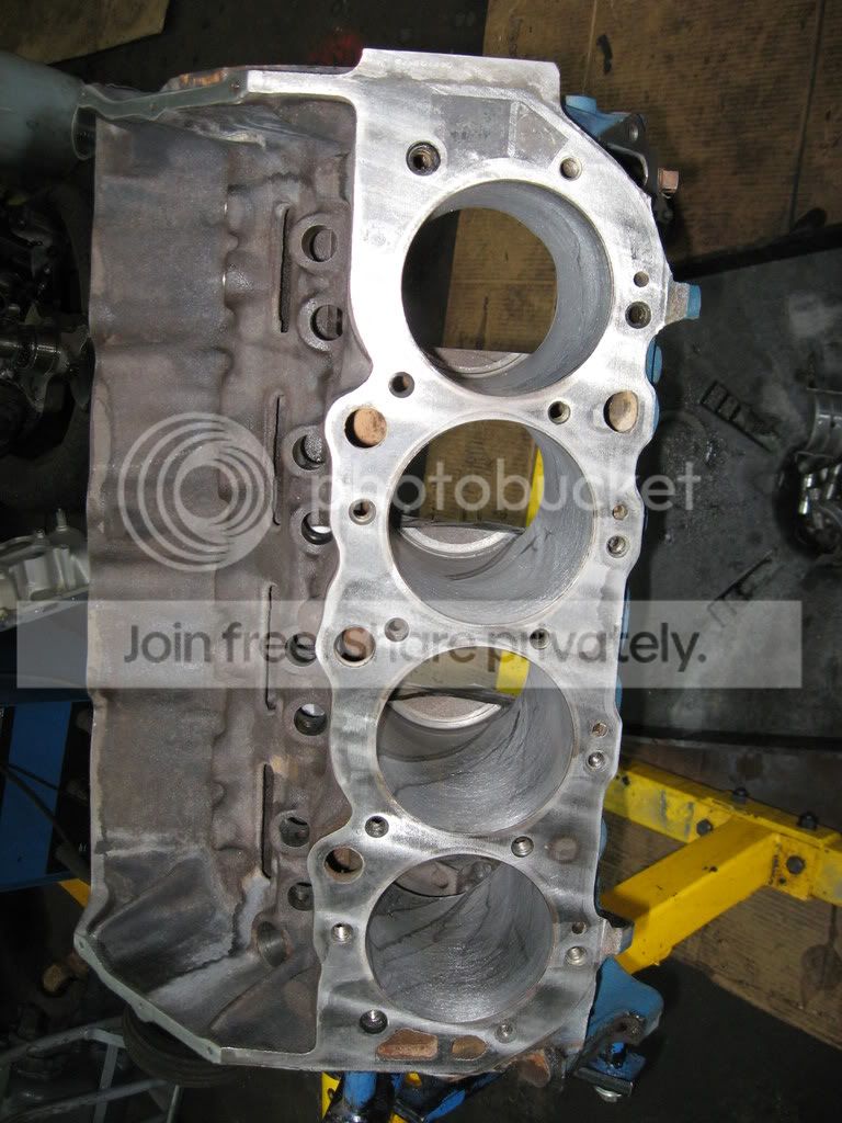

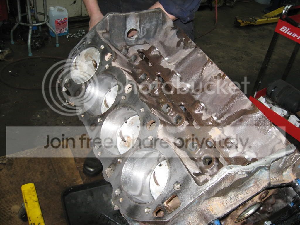

the parts truck that i bought for this build had a 454 that oi planned on using... turns out it was a 468!!!

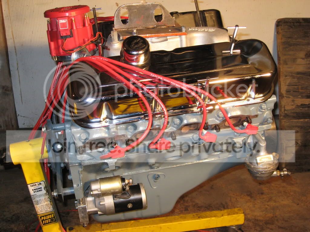

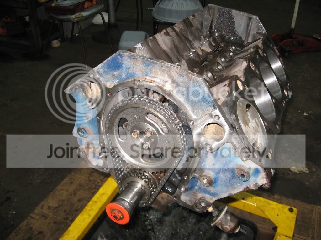

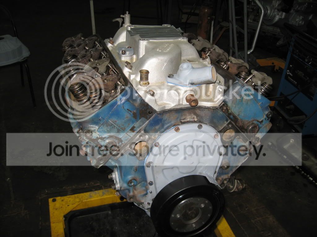

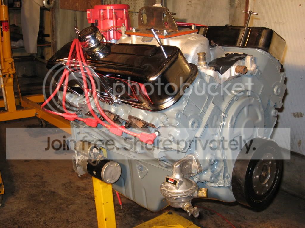

block is ready too go..

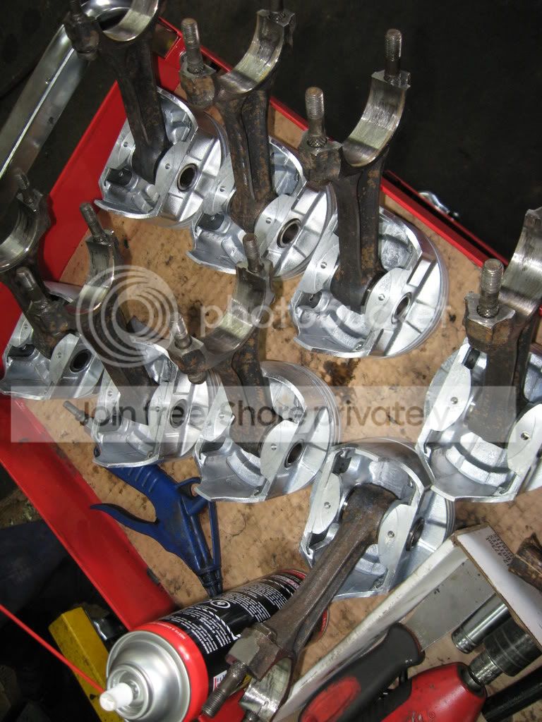

pistons r ready too go..

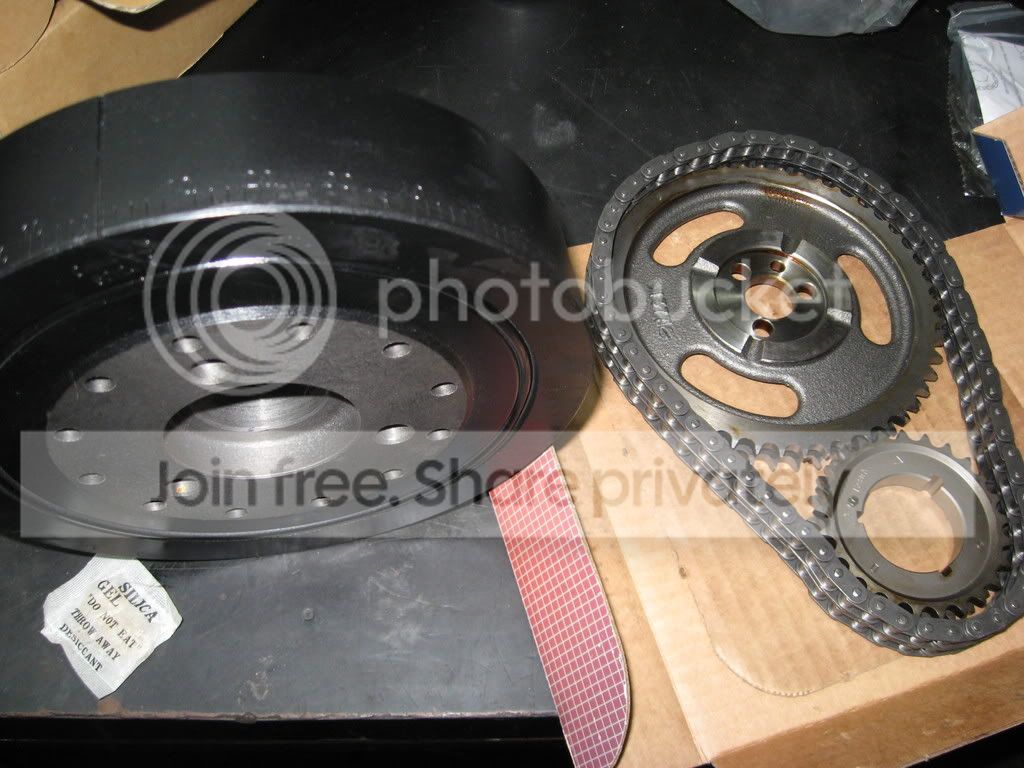

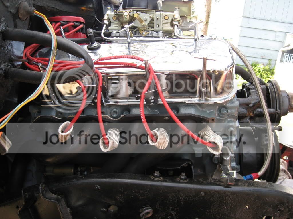

new balancer and double roller timing chain..

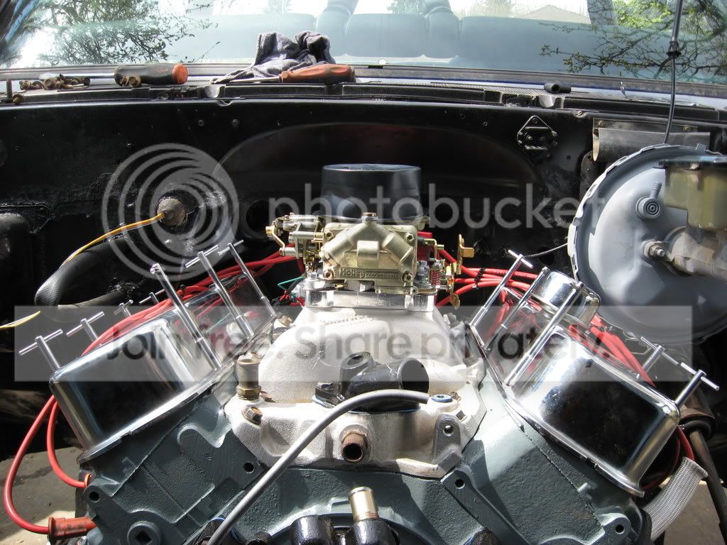

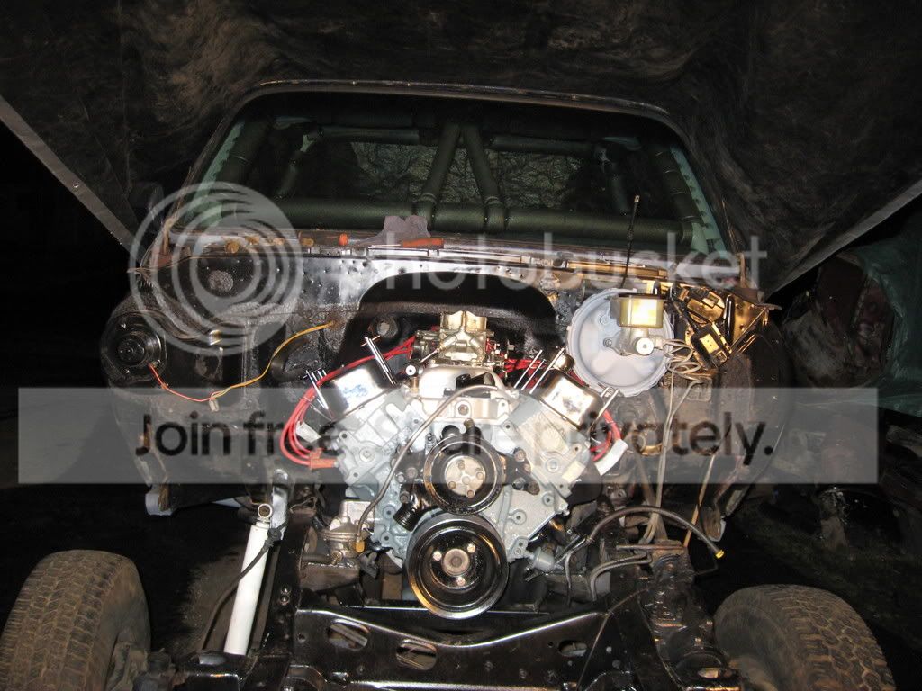

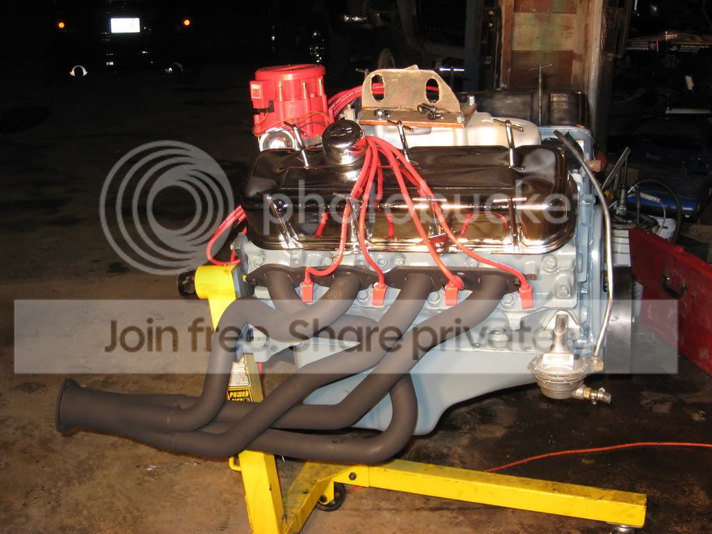

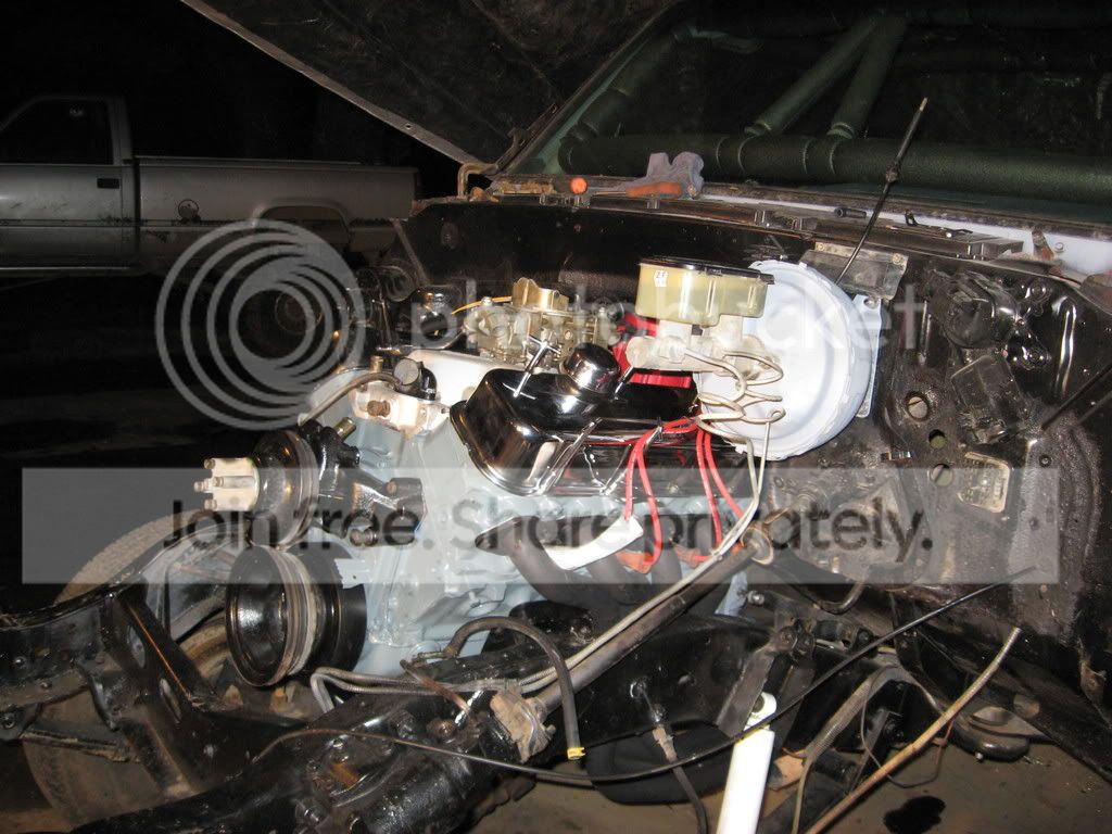

then delivered back too my p;lace for final assmebly and install..

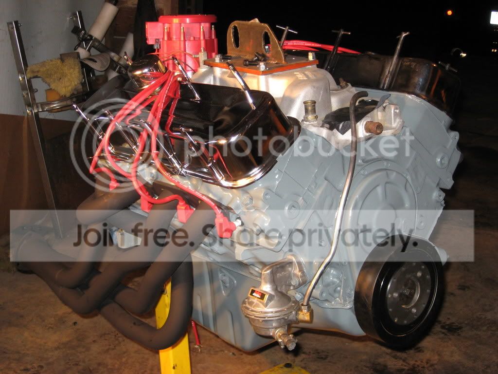

mmmmmmmmmmmm sexy...
my buddy has this desktop dyno thing for his comp. when we added all the variables that we did it said i would get 400 hp and 535 ft lbs at 2000rpm. now that ive driven the truck i would say its at least that..:eek1:
msd rev limiter that fits inside the hei...:bow:

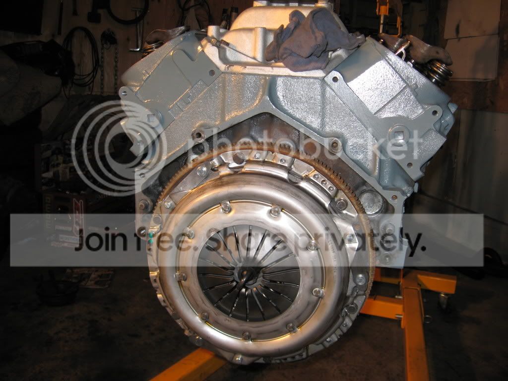

new clutch..
new 750 double pumper..

bumper installed..

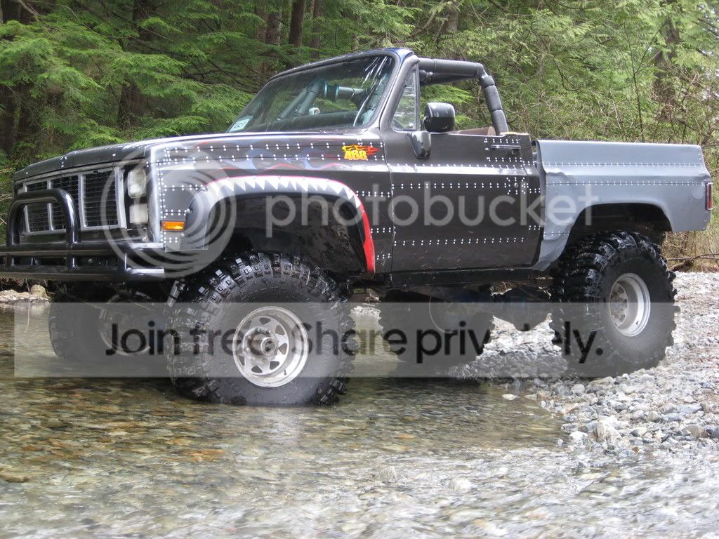

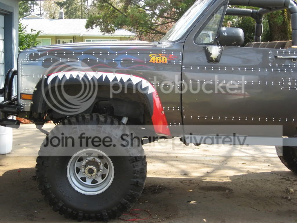

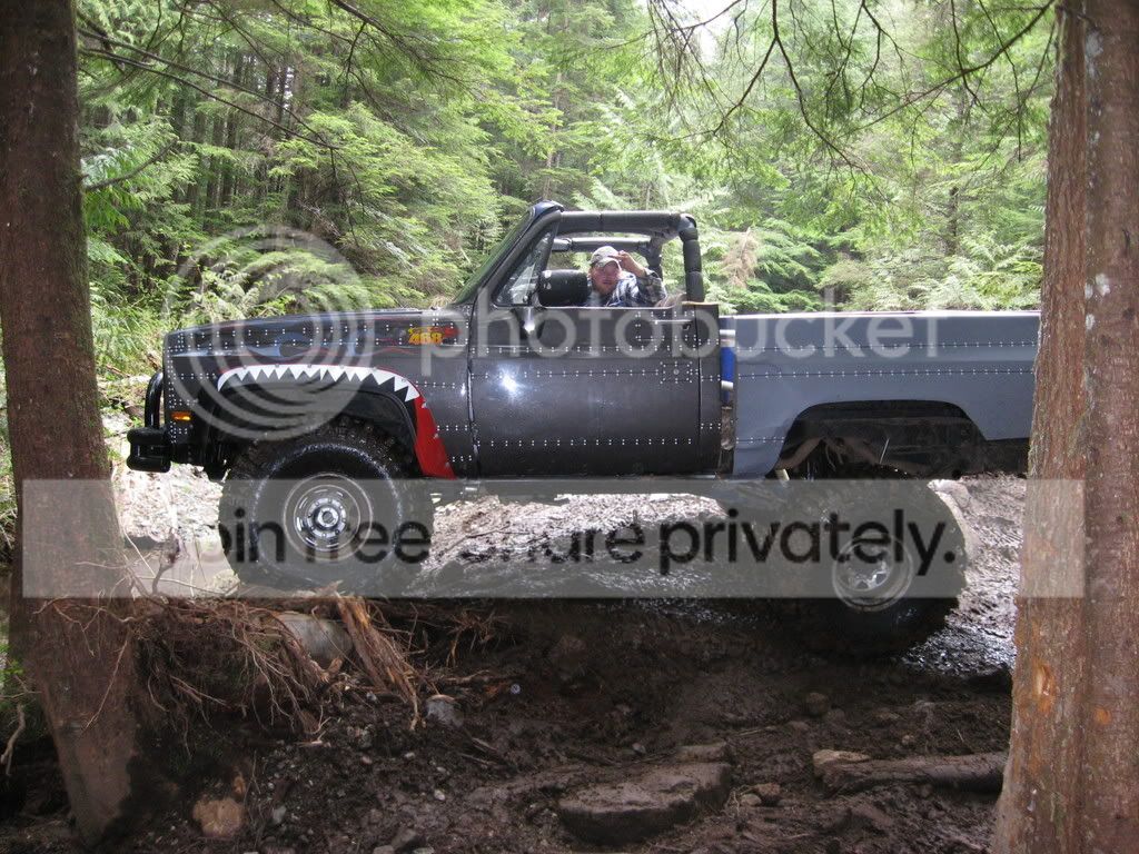

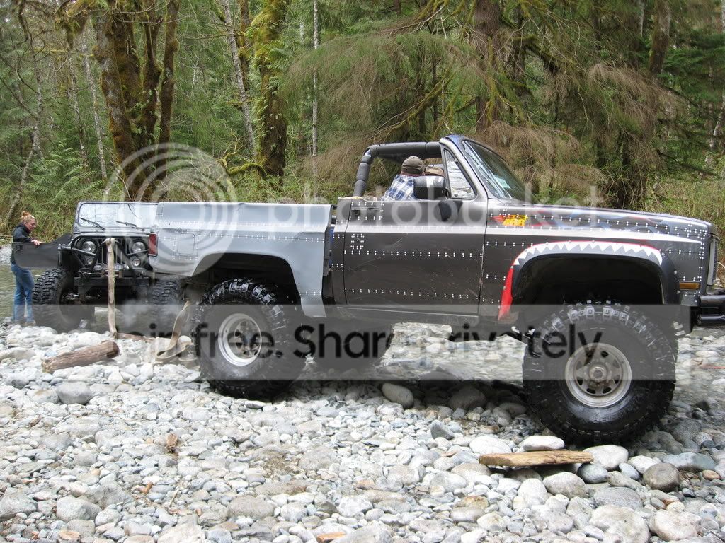

painted the bushwacker fender flares the " sharksmouth".... can ya see a P40 theme now?
took it out for a first test run.. and ended up towin a jeep back... not a single issue...gotta like that..:D:D

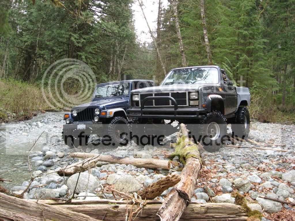

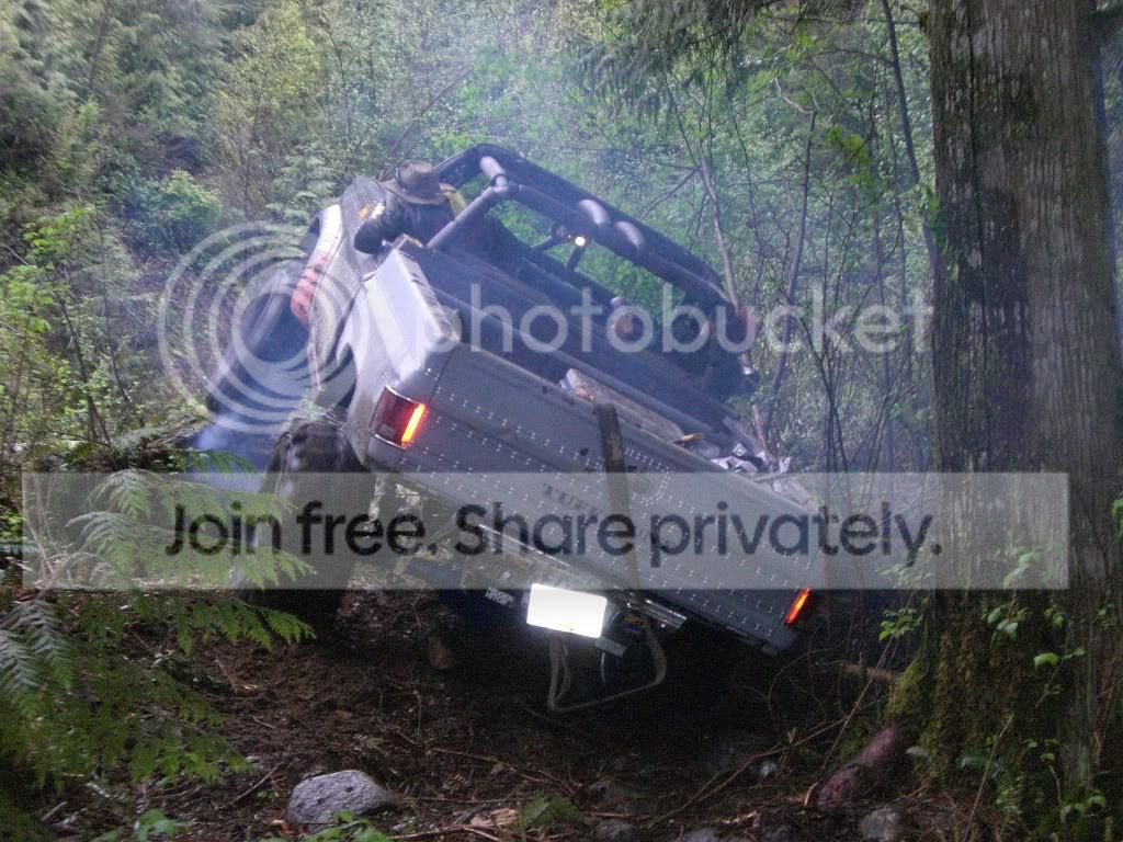

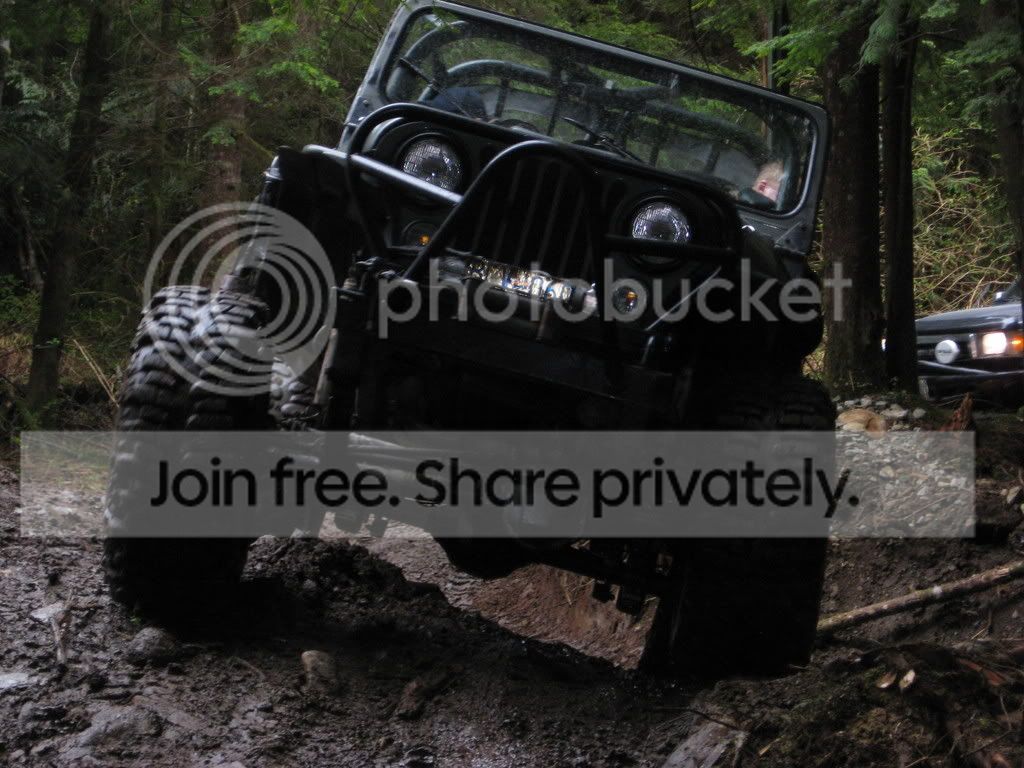

some wheelin pics...
my buddies jeep..
the ;last time i went thru here i ripped a rocker out..
lovin life...
love this shot...
