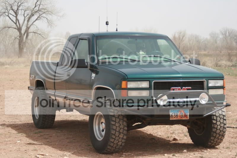

97 GMC K1500 extended cab 350 vortec 5 speed manual it has a fugly pieces and parts lift on the front that gave me 4.5" of lift. and zero lift on the rear. 315x75x16 Big-O XT's on MT classic 16x10 wheels. The lift hasnt been bad other than I have a tendancy to get rough and break stuff.
most recent pic Its been dirty since the elk hunt due to foul weather so I dont take pics.

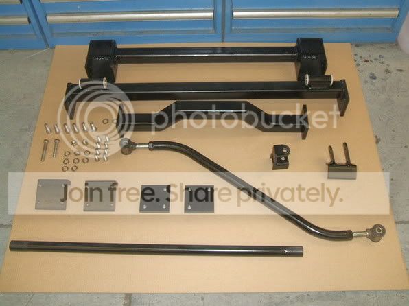

Sunday night this should be here. Its made in north salt lake by a guy named Wayne, its the spring hangers, all brackets, removable cross member, track bar, and crossover steering kit.
