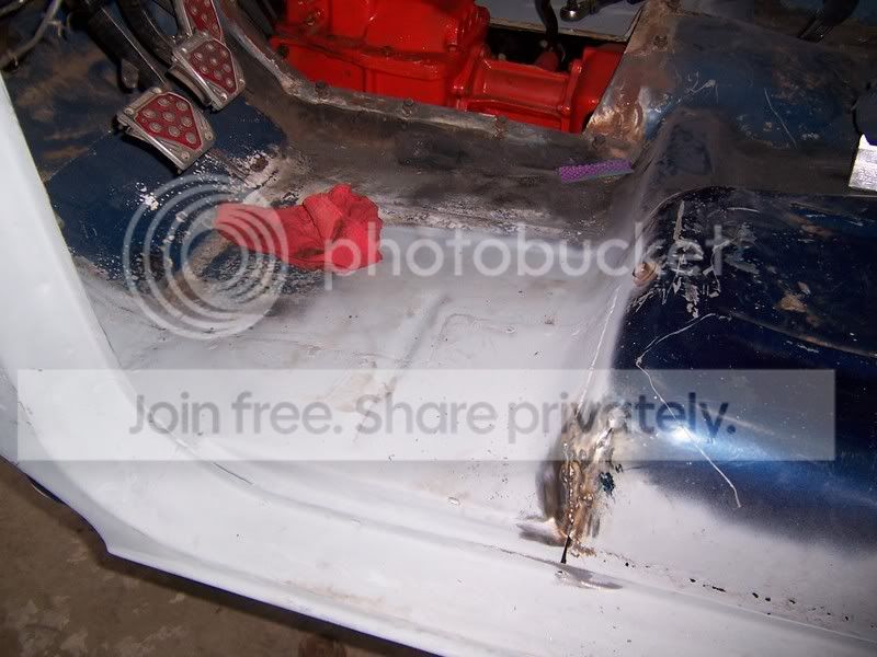

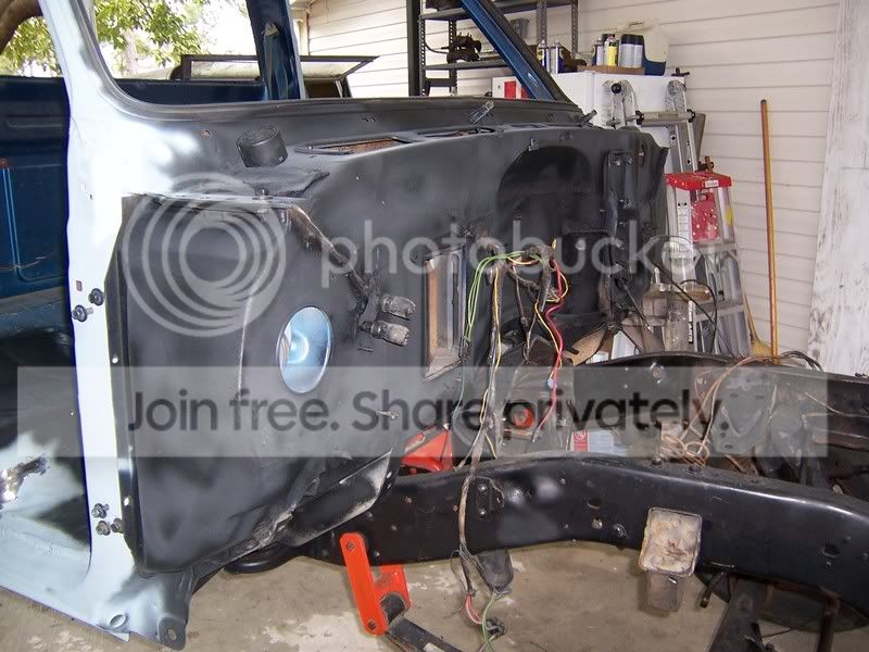

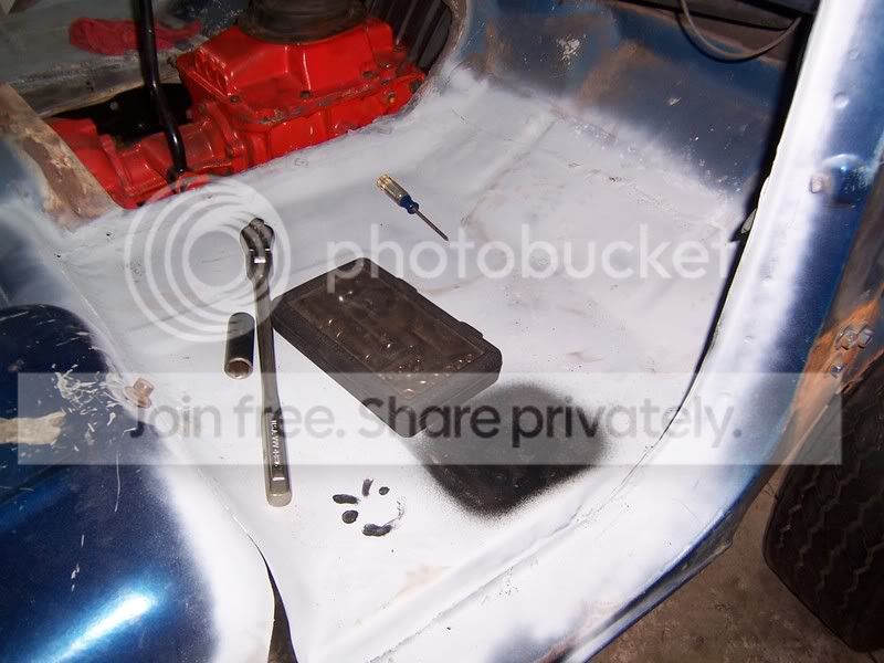

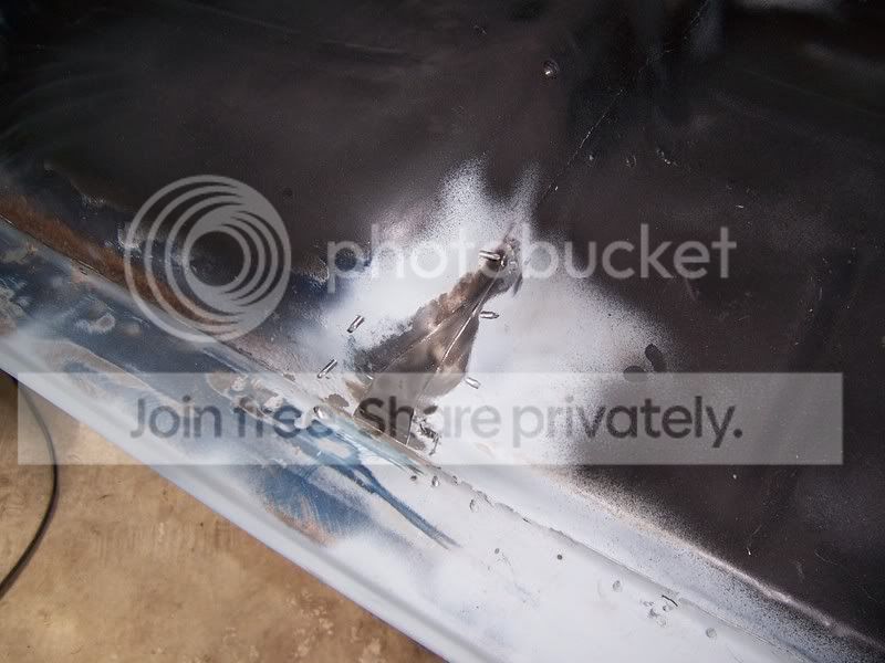

Heres where I am now. I started with a 77 3/4 ton longbed frame, used an 82 cab. I have since patched the floors, rockers, and cab corners.
Pictures are better than words, yes the floors look kinda sh*tty, but this trucks future is a mud hole and the floor's going to be rhino lined.

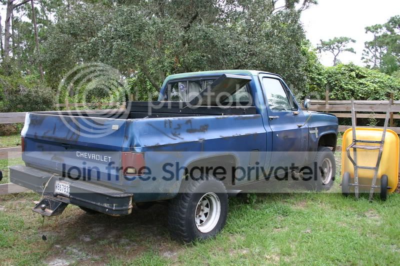

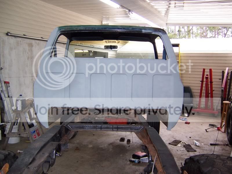

Shortbed that donated the cab.

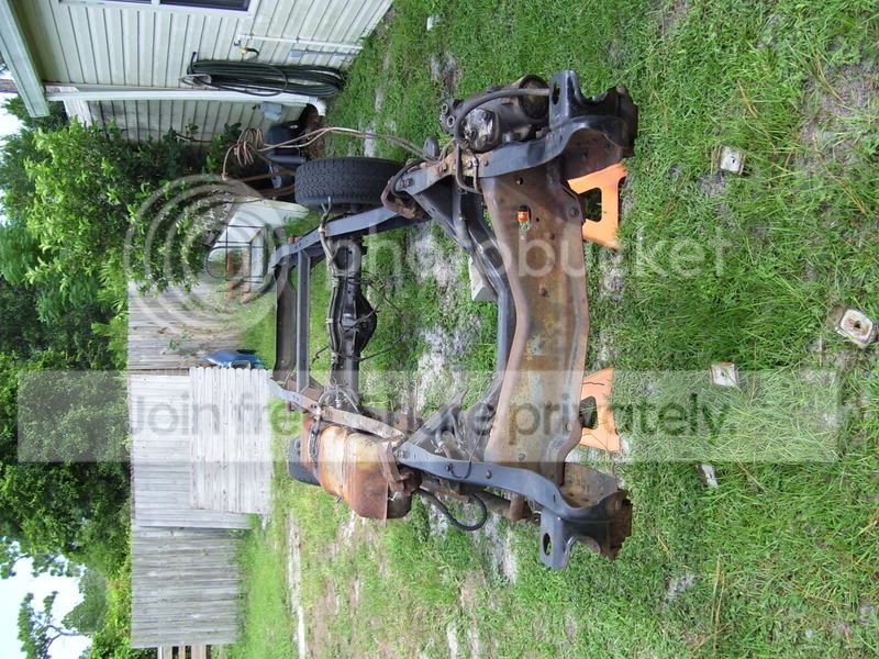

Longbed frame.
Only Picture I have:confused:
Floors inprocess...

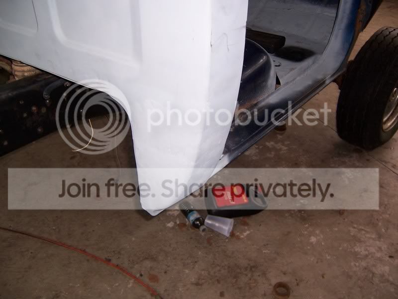

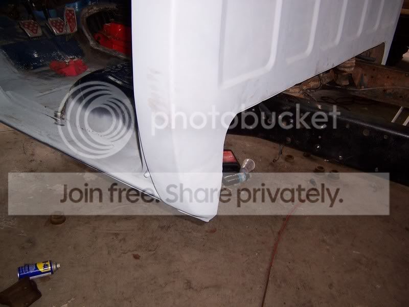

Corners

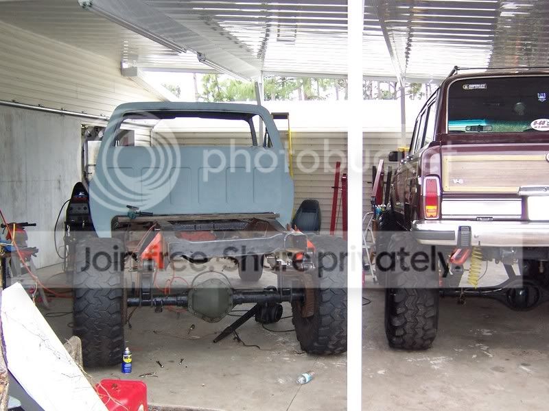

Size comparison.

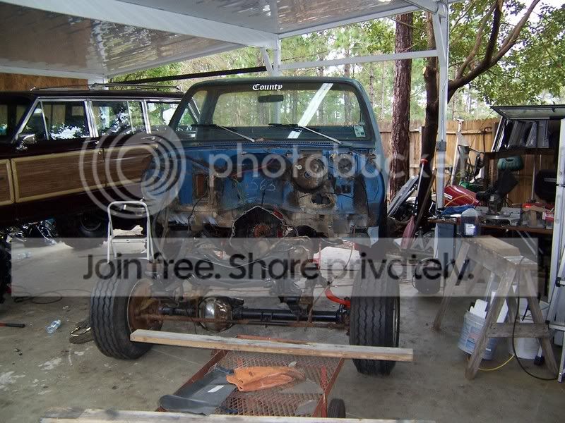

Wagoneer on 39.5s, brand new, chevy on BALD 38 ssrs.:haha:My favorite part is the jeep has 5k in it, my chevy's body has $400 tops, the motor like 2300:crazy:, Thats not a bad thing though? Right?:D

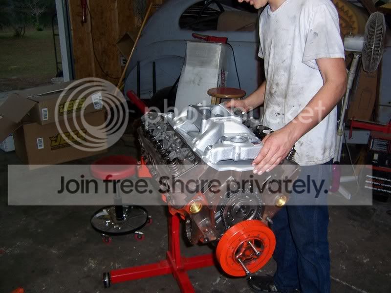

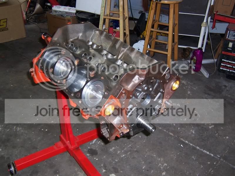

Got my 383 back...:D it's soooo sexy! I love how close everything is!
So far the bottom end is done, got my oil pan to clear. Read "Hit it hard with hammer."
So far I have 2K in the bottom end:eek1:
Heads.
Screw in studs, cut down guides, 24 shims?, 3 angle valve job.
Block.
Bored 30 over, notched, etc.

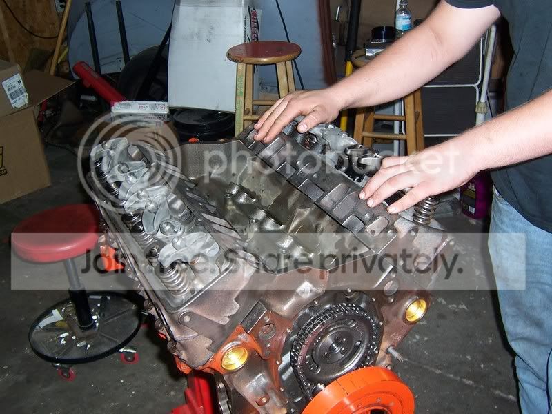

bottom end:
With heads
Mocking up with intake.

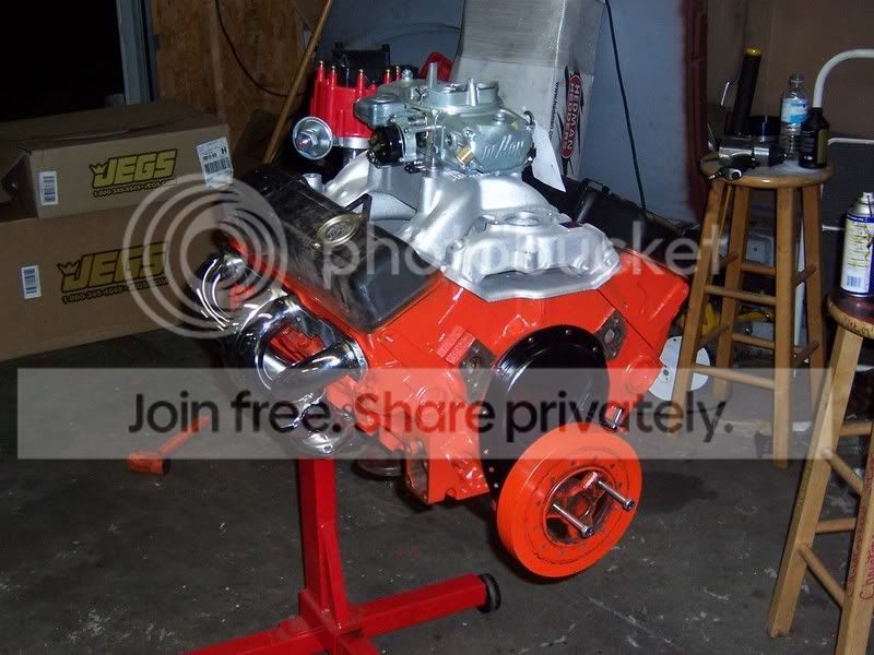

Everything on it. (mostly)

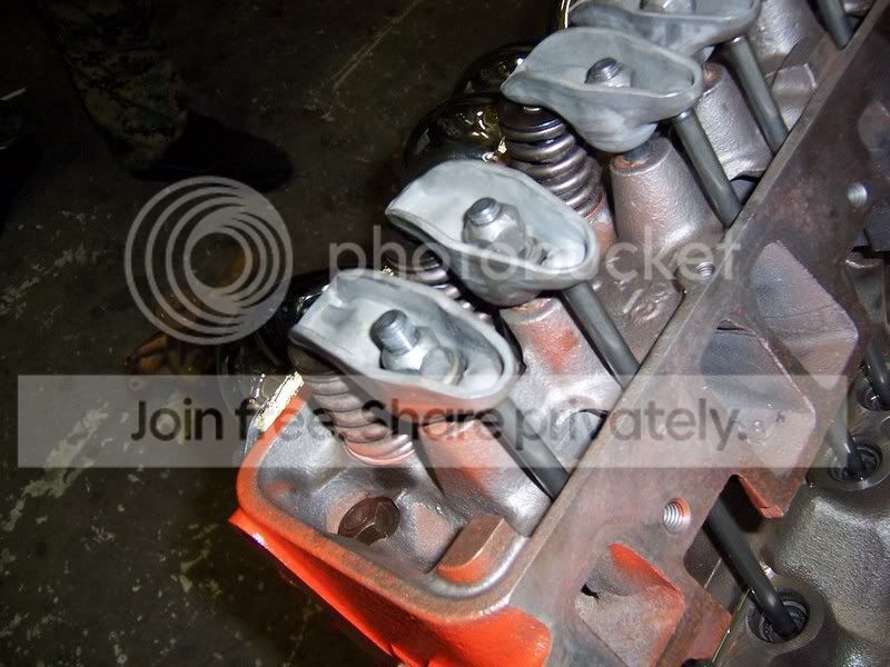

Rocker arms, having a problem. (I think) I'm pretty sure that I'm bottoming out the nut before the rocker arm is getting tight enough.
your lifters look like they're a long way down in the hole--and how come you're not using roller lifters if you have the roller block?

motor specs:
Eagle 383 intenal assy.
882 heads, 3 way valve job screw in studs.
comp 4x4 .480 cam
Full MSD ignition set.
Demon 725
$5 edebrock valve covers, junkyard special:D
GM perf flywheel
Hedman headers 69230
I got the motor installed, but don't have any pictures on this computer.:doah:found out my shortie headers hit the motor mount bolt, So I ordered a set of 69230 hope they fit...
