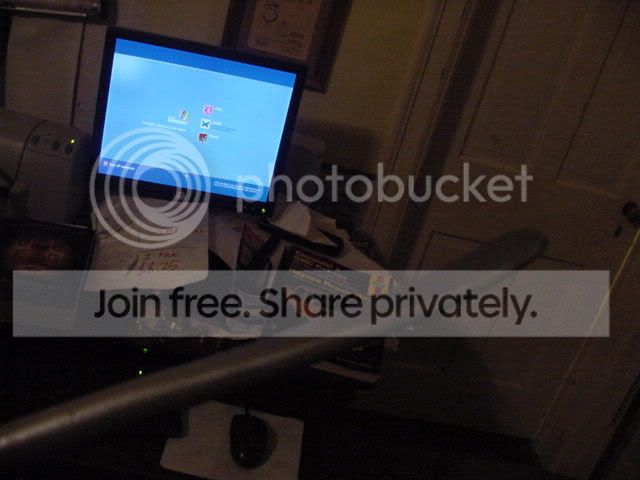

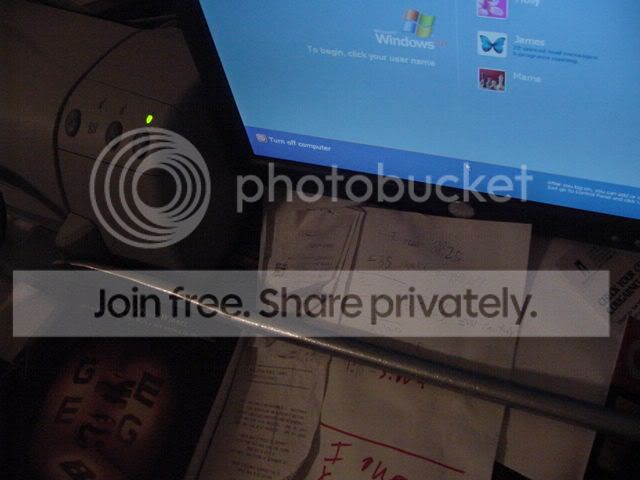

This probably isn't the most exiting post ever, but I just wanted to show every body what I got for 7 bucks today. Thats what they cost and Northern Tool. Does this look like it will work good to mount my tires? its 30" long and has a curved "spoon" on the end of it. Any more tips or articles are certainly welcome, cause I think I'll try to mount them tomrrow or the next day.
thanks,
James :bow: :bow:

They should work fine. I have done a few sets of 33x12.5x15 a few times and it wasnt horrible. But I will tell you I used alot of dish soap and a lot of cussing through the first few tires, but it gets easier. I also used a crow bar and for seating the bead a strap going around the tire and a blast of air. I dont think I would want to attemp a bais ply or larger tire.
That should give you plenty of leverage. Just use a lot of lube. I mounted my 37 MTRs on 15X8s with the little factory lug wrench as my tire spoon. I seated the bead with nothing more than my little red air compressor that you hook to the battery:D . Took me 2 hours including air up time on all 5.
