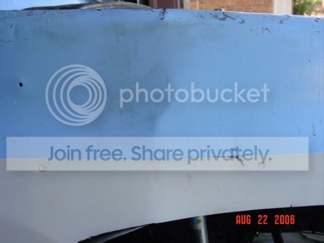

here is what i did (but in pictures.)
here is the radiator support welded to the headlight bucket.
the inside of the same seam
where i cut the triangle out of the top of hte fender.
where I cut the slice out of the outside right where the blue meets white.
and the inside of that seam

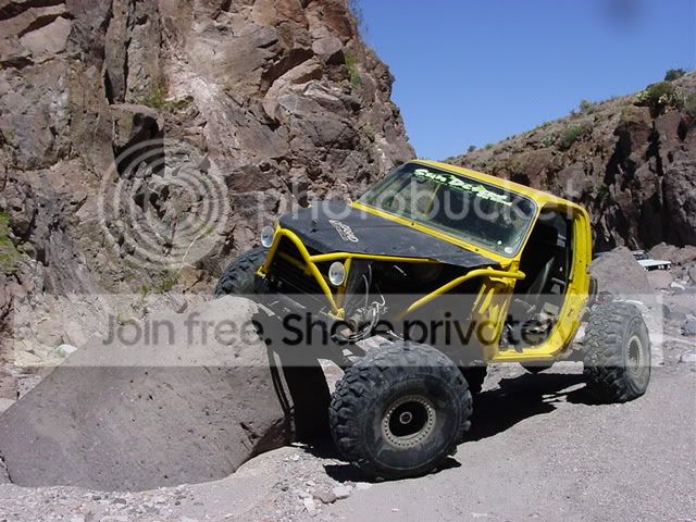

I ended up tearing it all off as the sheetmetal was still heavy and going tube. Its better and it doesnt rattle around as much. Still kept the front end looking like a blazer though.
BTW: if you look in the latest Petersons around page 74 or 75, you'll see it :D

I love it and would recomend it to anybody. The weight loss alone made a huge difference in performance. I can go places now that I could only look at before. I also still have room for a backseat for the kids.
