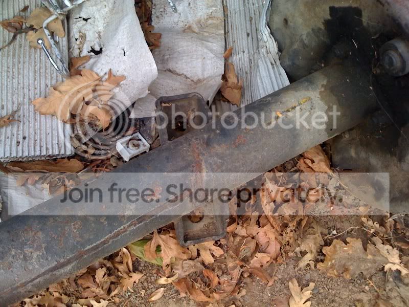

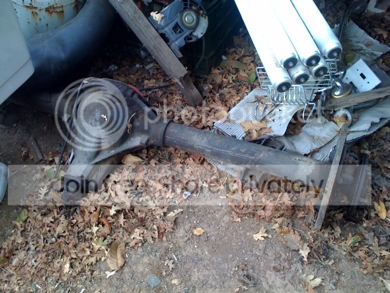

I've got a 6lug 12 bolt from a 2 whl drive ($50 offer/trade), trailing arm/coil type. Torch the perches off, weld on new ones. Think it 3.73 open, needs brakes. I also have a 14bolt 4.10, 1ton, ($120) would also need to have perches moved.
in Sonoma
14 bolt
Its complete. Here's a pic when it had springs and rollers.
