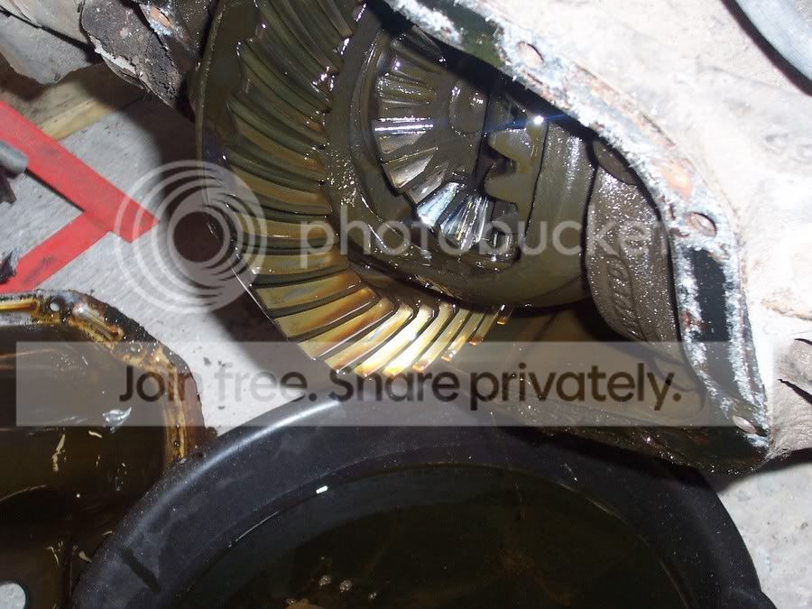

correct. pics of the dana60 gears:
look good no foreign matter in the oil.
