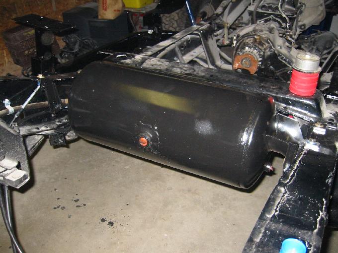

Here's the air tank I got.
Clicky
Great tank, it's an OTR air brake system tank, electrocoated inside and out, then expoxy coated inside.
Way better then those chepo ones you see around like on eBay.
Here's a pic of it mounted up, I made my own custom brackets for it:
Did you hard mount that tank? Those tanks are good but are suceptible to cracking when hard mounted...
Rene
It's mounted on 3/4" thick rubber isolators, as recommended in the specification sheet.
