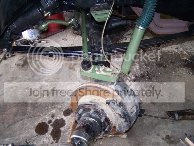

Do you have any pics of them installed on your truck. How expensive for the cross over???
What springs are those and have you had any clearance issues?
They are 4inch Ranchos and a set ORD Zero rate's.I know it look's awful close in the pics but it does clear.The only problem I have had is that when I moved the axle forward it put the drag link and tierod super close when turned all the way right.

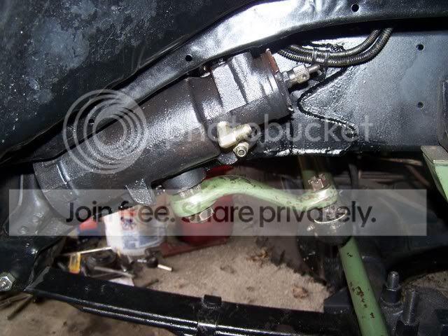

Here is what I did for my hydro mount.

Is that a 2 wheel drive box on your truck and what is the pitman arm is that off of????
Yeah it's off a 80's model 2wd truck.The steering arm was in the kit from ORD but I think it's just an arm for a lifted Ford.What I have is the very kit Obijaun pictured earlier.

Here's some info and pics when I did my crossover:
http://coloradok5.com/forums/showthread.php?t=200968
The link has pics before the zero rates. The pic below is after the zero rate install:
