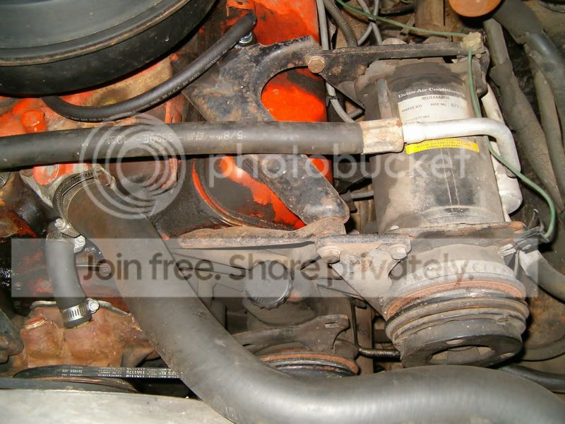

So I am in the process of putting my 454 back together after having it rebuilt and I am having trouble figuring out where some of the accessory brackets go. Hoping somebody might have some photos of their engines fully assembled.

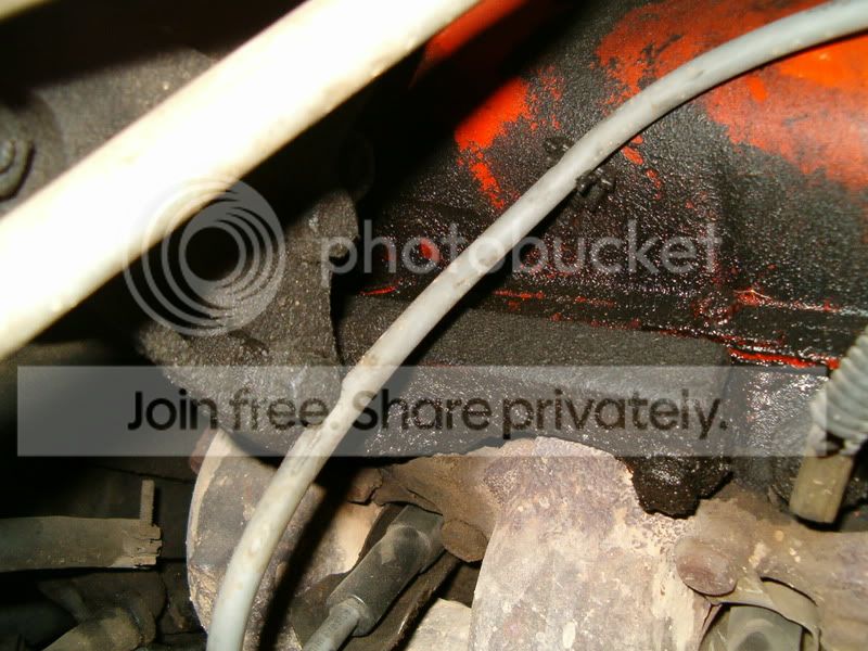

Also I need a photo of the drive train if possible. The two support bars that run from the base of the bell housing to the engine are confusing me as well. I feel like something is missing. Pictures are worth a thousand words.

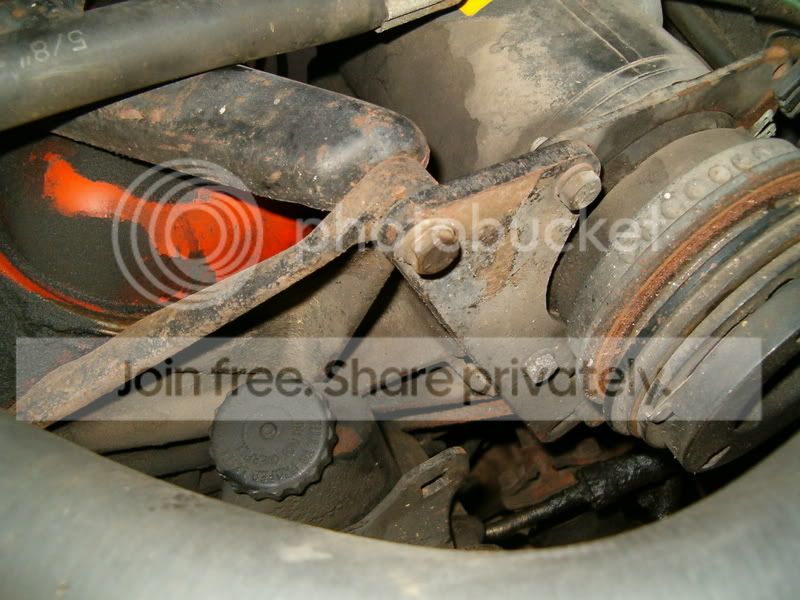

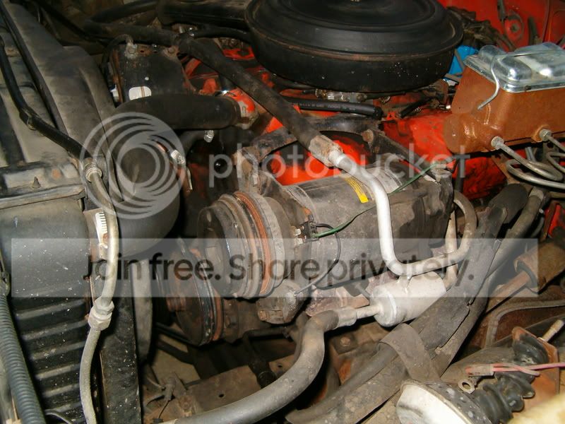

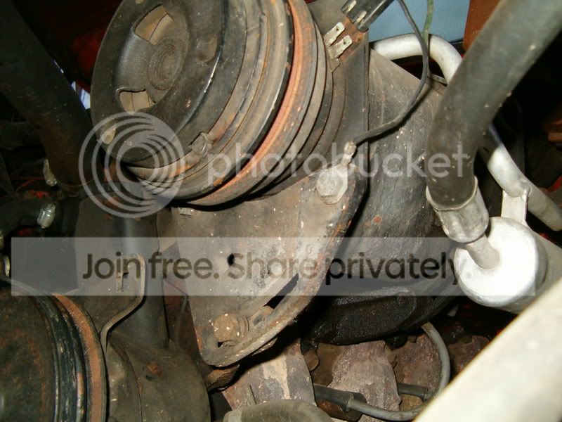

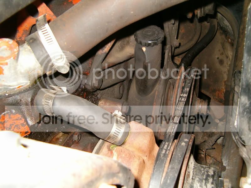

If anyone has a pic of just the front of there 454 engine (ideally one with AC) that's all I need. The bracket's I don't have figured out are all the AC brackets and the power steering brackets.
Thanks
here ya go...76 I believe to be uninterupted from factory install:

Here's the only pic I have of my motor mount bars. The go from the bellhousing to a special bracket that bolts to the block @ the motor mount.
Edit: the longer of the 2 bars goes on the driver side.
