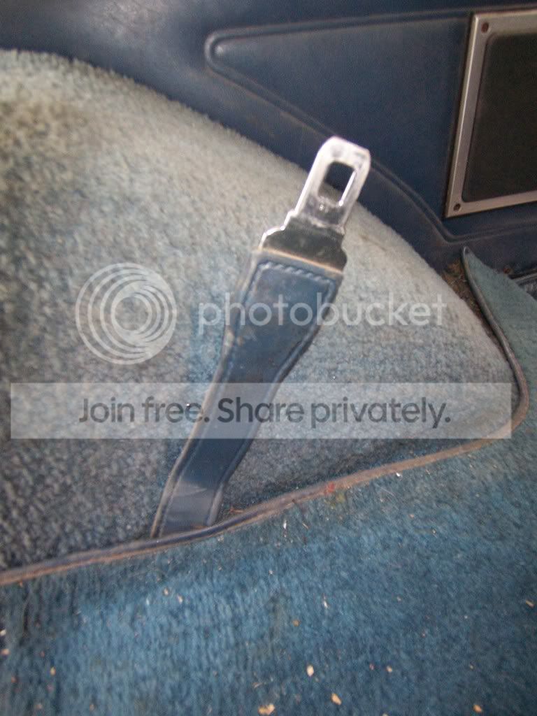

I have a 90 k5, it has the mounts for shoulder belts in the top, but the bench seat has retractable female lap belts. I think the bench seat was not original to the truck so I need some help getting a seatbelt solution.
Now what I need to know before I post in the WTB section is if these will work...
Thanks for any help or advice.
Just switch out the edge seat belts for the style that match your bench. It may take some hunting in the yards to find the right gender belt.
I'll have to make some calls today I guess. I'm not having much luck with salvage yards locally. At least one didn't keep anything older that 6 years.
My hope is that someone might have the male ends laying around their shop.
I've researched out replacement seats with seatbelts built in but I dont have much in the way of fabrication skills so trying to keep that as a last resort.

Yeah I can get universal ones locally but just not sure if they would work out.
If you are putting them in your blazer take a few pics.
my ebay belts mounted in the stock locations. my rear bench is stock and had the retractable female end attatched to the seat. i used the universal belt instead of stock because i couldn't find the male end i was missing and they were easier to use with a car seat.
Did your eBay belts come with the male end that bolts to the floor?
Also do you have a link to the ones you bought?
I'll have to drill a hole for the male floor mounts as it doesn't seem that my blazer came with that setup.
