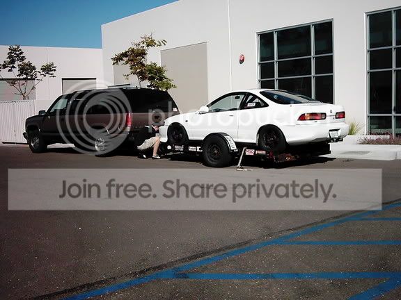

heres a pic of my burban and the weight it hauls.

ohh and i tow the car to and from races. i figured if i have to beat on the car all day, i don't want to worry about braking anything and getting home.

Plus, bigger tires w/out regearing a tow rig Really hurts towing performance.
When I bought our tow rig (it wasn't being purchased as a tow rig, it kind of got volunteered) it had 33" tires & 3.55 gears. Towing our 8,500lb setup is downright painful with that and a 360 gasser. Even empty, it'll hardly hold 75mph on the highway because it's only turning 1800rpms in Overdrive, so it's always kicking down to Direct and sucking down more gas.
