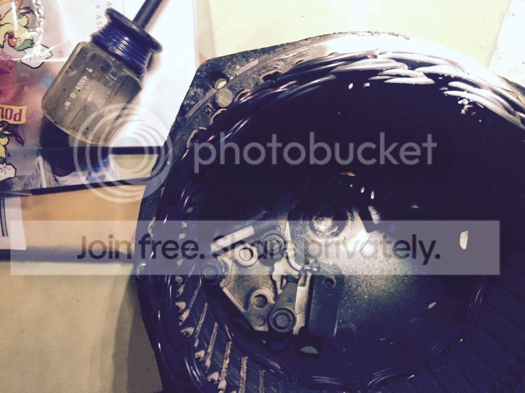

i know it's difficult to see, but is this the correct orientation for the brushes---assuming the springs were in? i've had to re-clock the new alternator. This is my first time taking one apart.
And yes, this picture is of the old alternator:
NEVERMIND:
When i got the new one apart, the new brushes had the holes that lined up with the hole in the back of the case---so it was self-explanatory at that point.
