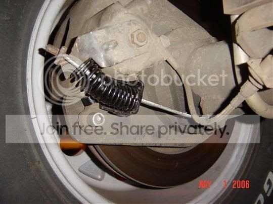

Im working on my disc brake conversion and I need pics of the e-brake components on the 76-78 caddy calipers, and installed if you can get it.

Well I did get the caliper mounted up, but I have yet to hook up the e-brake. I cut off one of the stops off so I could run the e-brake lever more vertical in relation to the caliper. This lets me put the e-brake mechanism on top of the axle. Thanks for the help guys.

has anyone ever had a problem with them getting caught up on the rocks? I'm thinking i could weld a plate coming out from the bottom of the bracket at a 90* angle. about 2" wide & the length of the bracket.
Those are mine and in the last 4 years i've never got them hung up on anything.
