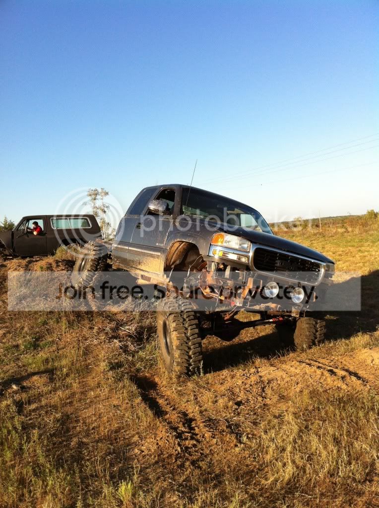

Here's a poser flex shot of my front 52's at work. According to that chart they are the 1950 capacity springs from an 80 something 2wd. Not a burb, but I've got a similar land yacht 144+ inch wheelbase. Keep in mind the rear springs are barely moving, too stiff.

Otherwise I'm thinking those 52s up front might be a bit lose on the road. I'd look into some kind of sway bar up front.
i was gona do front and rear sway bars like the currie anti sway setup(cheaper home built version)
