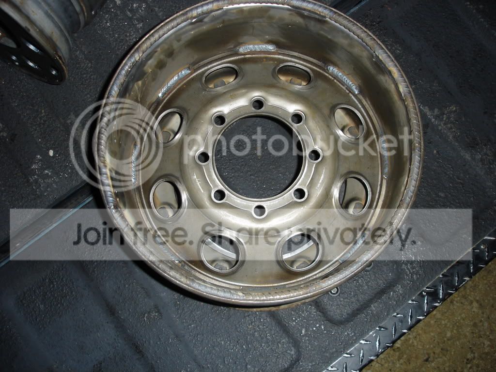

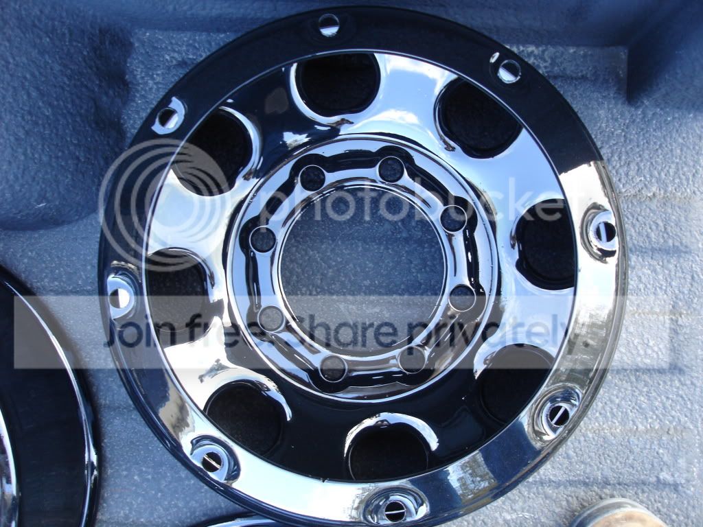

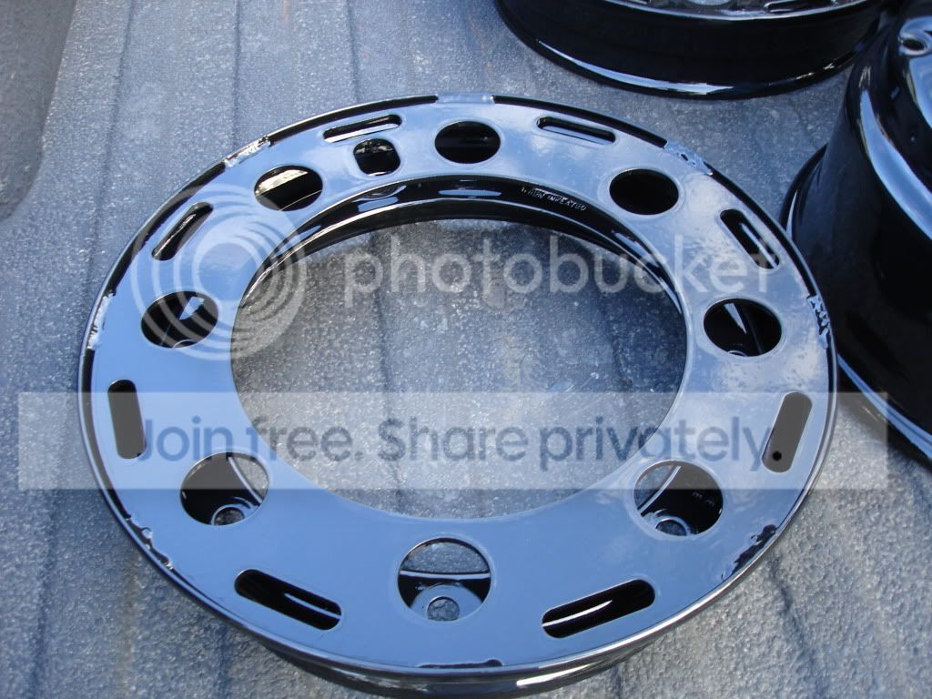

H1's are what I went with. When I did mine it cost me less than what Stuans would cost, no doubt. I paid 130 per wheel, for the wheels, centers, recentering, & rock rings inner & outer, and having the 2 pc wheel nuts chromed (powder was not included in that price simpley because someone can rattle can if needed, but add about 25 per wheel for what I paid). I'm happy with how they turned out. But since Stuans can be moved to a different wheel of the same size, that could be handy. If a wheel gets boogered up, the staun could be moved to a new wheel without the cost of another beedlocked wheel. It's all relative though, .. Stuans could get damaged too.
Inner rock rings installed
Recentered H1 powdered
Outer rock ring & second pc powdered
