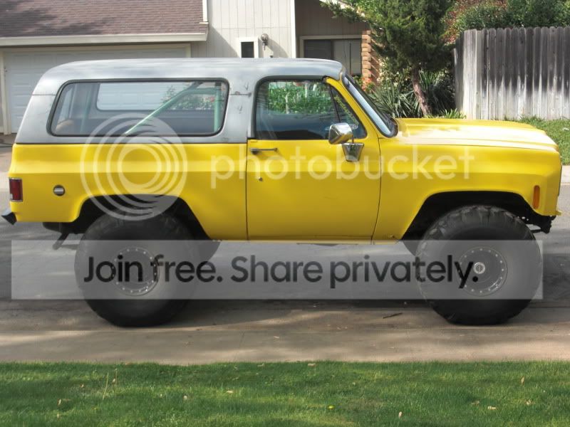

this is what i had with 4in and 36's

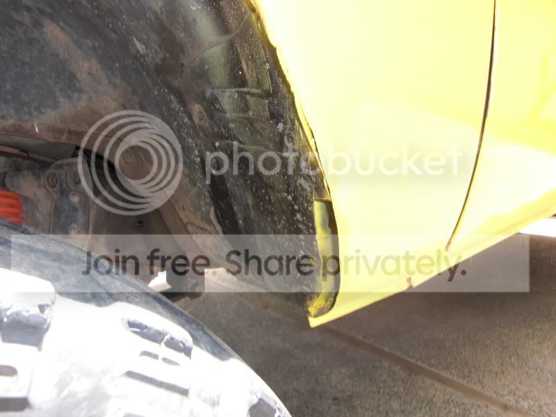

Basically i took a piece of tape, started at the rear of fender were it starts to arch down and followed that line down to the bottom of fender.
took a cut off wheel and cut the outer fender, then sawzall for inner.
Front i cut flat under the core support and rounded the edge. The edge looks squarish in this pic but it got smoothed out.
Just get some tape up there and go to town
