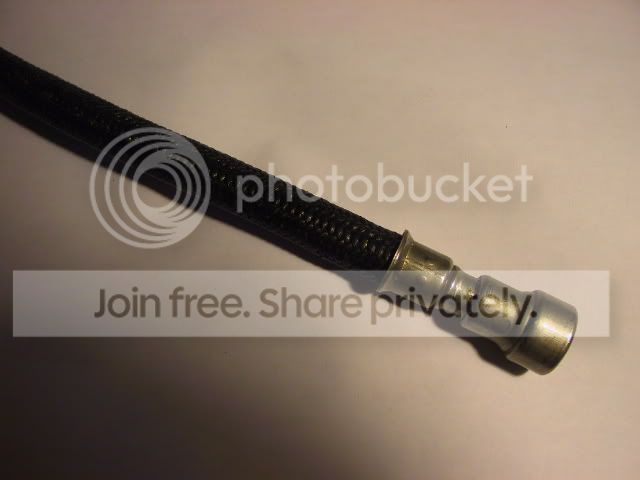

I am looking to either get 3 lines made, 2 with a 3/8 pushloc on both ends and 1 with 5/16 pusloc on both ends. If I can't get the hoses lines made I would like to buy the crimp ends and have a local place crimp them. So far everyone just wants to sell me the cheap nylon/plasic hose and I don't want that. I also don't want to go the AN route. I am trying to keep things looking factory/stock on my swap. So do any of you know where I can get these hoses made or buy the fittings?
Here is a picture of what I am looking for...........
I had some custom lines made by Inlinetube. If it's easy to describe what you're looking for over the phone (such as stock hose with extra length or different size fittings) they can build them pretty quick and it's not that horrible of a price.
I actually fabbed up some hardlines with store-bought brake tubing and rubber sections and had them duplicate them in stainless for me with factory crimp fittings.
