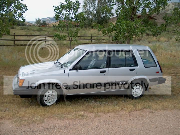

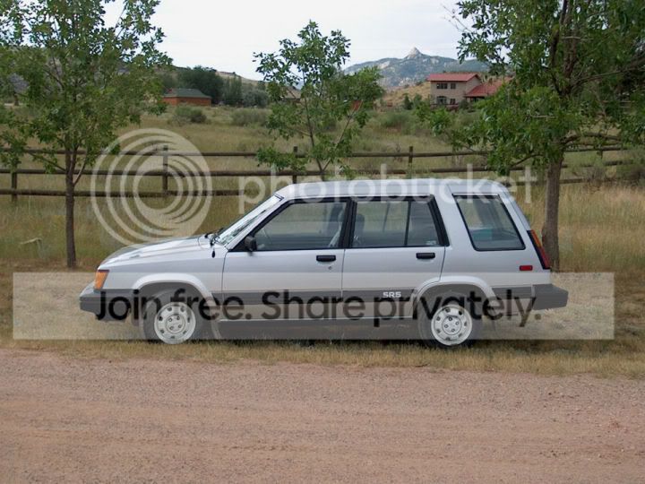

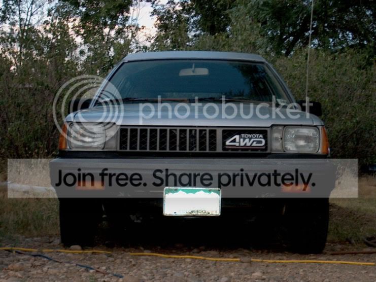

Okay. I am not the guy who's folks give a Jimmy or Blazer or Bronco or 4Runner. My folks gave a 84 Toyota Tercel 4wd Stationwagon. Please don't laugh.
A family friend took me 4-Wheeling in his insane Suzuki Samurai (HOW DOES IT STAY UPRIGHT??) and we got in some crazy spots (perched on a 3 foot boulder with a 20 foot cliff on the other side comes to mind?), but it turned out to be one incredible experience. Since then, I've wanted to be able to do this stuff for myself. Well, as I said above, I don't exactly have a beast to start out with. In fact, I don't have much of anything. Sure, the thing pushes through snow like a champ and handles mud with no stress, but I'm a little hazy on the real offroading experience. I still want to try something minor to get something under my belt. Anyone know of anyone know of any toddler-trails in northern Colorado, specifically the Fort Collins region? I have been up through the many gates of the Red Stone Canyon in the snow and mud if anyone is familiar with the area, so I'm familiar with rut-filled steep roads covered in mud and snow.
Everyone has to start somewhere right? I'm hoping to be able to get my "Beast" lifted 2 inches (it has independant front suspension so its hard to get higher) and stuff some 26's under there, or some 22's with "big" travel.

Solid axle is the best bang for the buck. Have fun! Keep us updated...got any pix?

Yeah, lemme get them uploaded.
