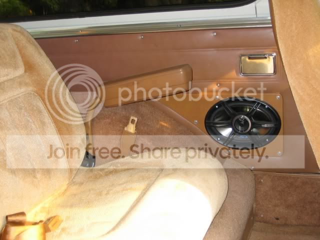

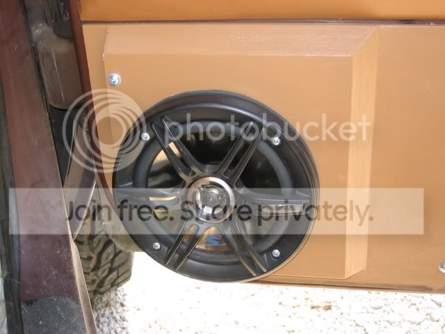

Well, I realize this thread is about a year old now but I thought I would just give you guys an update and post some pics to let you know how I ended up finally doing the stereo system in my '88 K5. Hopefully some of you that are thinking about doing this can get some ideas from it.

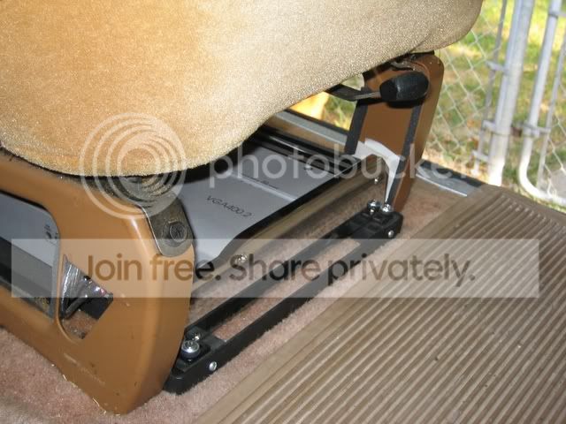

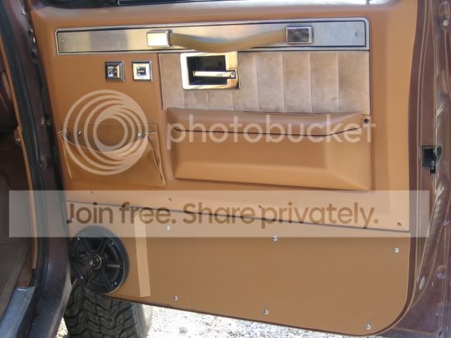

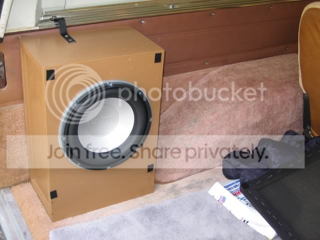

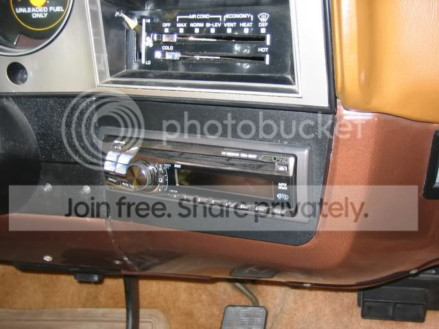

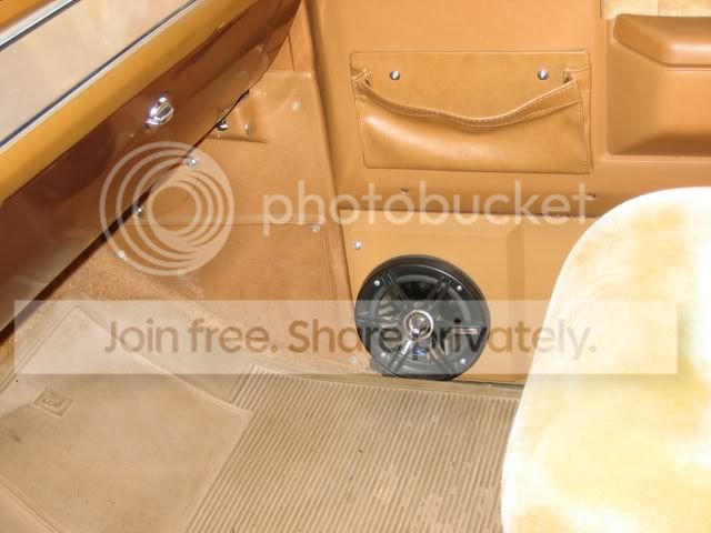

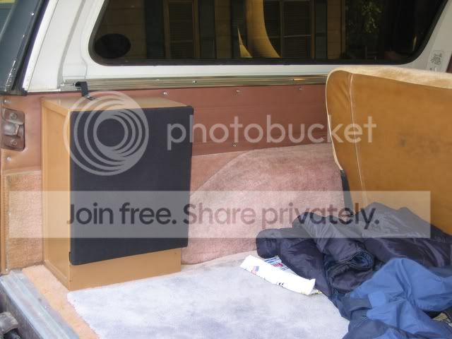

This is the first time I've attempted to do much custom stereo stuff so it was truly a learning experience. The lower door panels are constructed of marine grade 1/4" plywood and the front part that the 6.5" speaker is mounted in is a piece of 3/4" plywood layed over top and cut at a 45 deg. angle. I had paint custom mixed at Home Depot but the color ended up a little bit off. It also probably would have looked nicer if I used black mounting hardware rather than silver but I guess I can change that later. The panels that I mounted the 6x9s in are made of 1/4" plywood and are covered in vinyl. After that stuff was done, I played around with subwoofer styles and decided the best choice was to make a thin box for one 10" sub. The box is made of 3/4" MDF and I made a grille with wire mesh to protect it and covered it in speaker cloth. I originally wanted to mount it back in the side panel but came to the conclusion that it would be hard to make work. The amplifier fit nicely under the driver seat. I'm actually a little dissapointed with my head unit's internal amp so I really need to go with an external amp mounted under the passenger seat to power my speakers.
