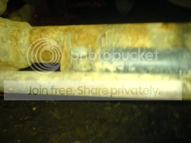

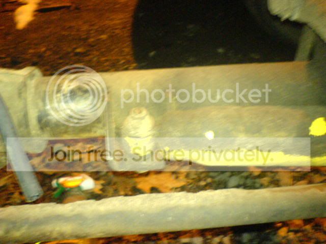

1st I've been working on this for 3 months in my spare time and now I can't remember. My steering stabilizer, its attached to the steering part but where does it attach to axle. A pic would be nice.

#1...the stabilizer bolts to the axle on a bracket
d60
10b, pretty much the same

I would have ended up mounting the stabilizer on the wrong side of the axle bracket, good thing I asked.
