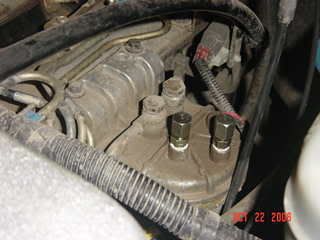

mechanical fuel pressure verification at the VP44. never below 5psi. you can tap into the top of the filter canister. Theres 2 1/8" NPT ports. one measures prefilter pressure the other post filter pressure. or at the schrader test port on the side of the IP iself.
put a scanner on it. if it shows a P0216 OR P1688 The VP44 is in imminent danger of failure. lift pump should be relocated to the framerail near the tank, or an aux electric pusher put in series with the stock carter pump.
This is my filter housing. Closest to the center is post filter, outter circle is prefilter. and more than 1 1/2 psi pressure drop across the filter, filter need replacing.
