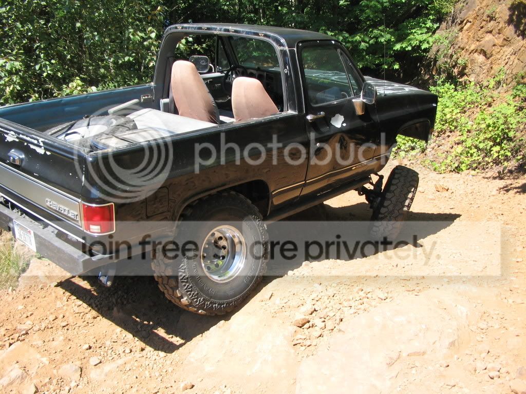

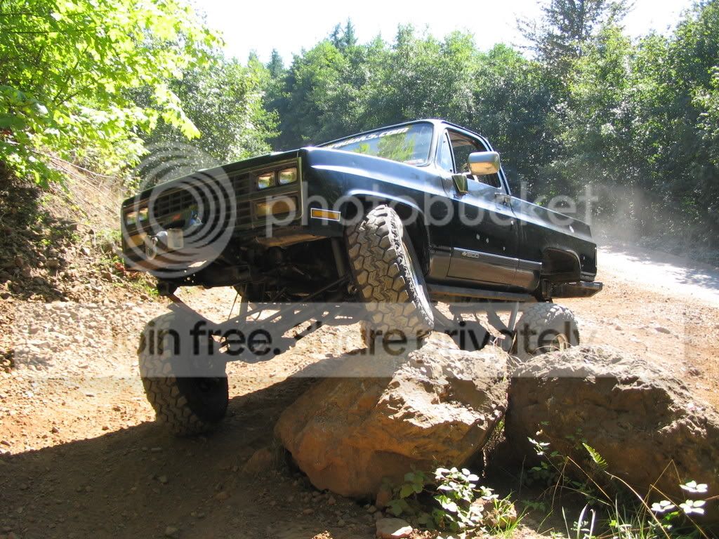

52's and 56's are Chevy rear springs used up front. Normal fronts are 48" long. Longer springs are softer and flex better. They are cheap and fairly easy to find. The swaps are detailed in many of those threads as well as several of our builds. Check the link in my sig. Now with that being said these "cheap and easy" mods require crossover steering, long shocks and brake lines, long slip front shafts so they $$ will add up with other things, but well worht it in my opinion especially for a trailered rig as driving on the street can be a little spooky with lots of travel and no sway bars :wink1:
Pics
I have 52's up front and 56's in the rear with a shackle flip 7" DIY shackles. I can use up almost all of a 15" shock front and rear. I am actually going to limit strap the front to save my driveshaft yoke until I upgrade to 1410 joints.
