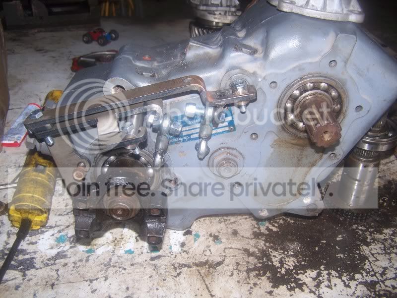

Anyone know where I can find the instructions on the 205 twin stick shifter. I can't figure out where all these brackets go. Now this is just a single NP205 with modded shift rails. NOT a Doubler. Thanks.
If you look at the picture they have for the doubler, the brackets are the same except the 203 shifter isn't there.
Hope this helps. I dont have the actual installation instrcutions, but sometimes a picture is worth a thousand words.:D
Ok I think I got it. I was missing one very important part yesterday when trying to figure it out. Beer.:D I guess what was missing was I didn't see rod end links. They were still wrapped up and I didn't know that this kit would have them. Most 205 kits don't use those links. Anyway, look at this picture and see if you think this is right. I know I'm missing the retainer, got to find the part number for the 1410 sized seal. Anyone?:D
